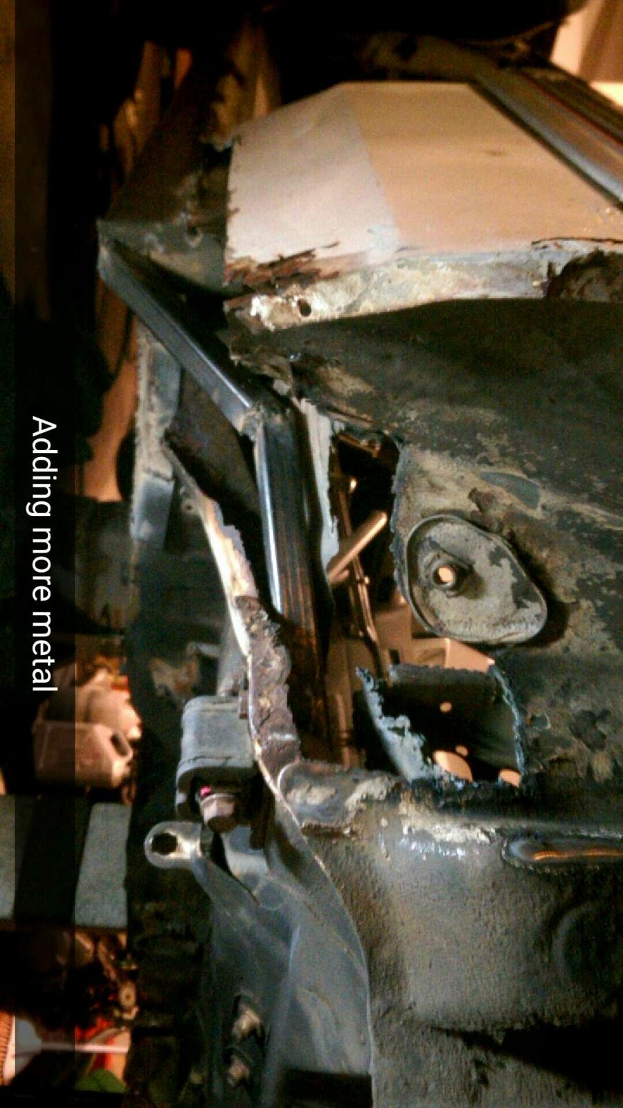

D3F0 Posted December 21, 2015 Share Posted December 21, 2015 I am currently doing this exact thing. I have a ton of 2x4 frame rail I am stuffing into the frame of my RX Due to all of the rust I am dealing with. I used small stuff on the rear of the frame. My car is not even worth fixing but I am going for it. CUT EVERYTHING Then Mock up Welds are obviously not great I taught a bunch of my friends how to weld haha But who cares Weld it with terrible settings and adjust accordingly =) The path for my RX is make it stiff and ready to take abuse. See what I mean Here is my frame rail I am using I made a crazy bumper for fun I Love steel and for the side skirts I am cutting them out and putting frame rail in there too WARNING GRAPHIC I am replacing the entire bottom of the car with new steel slowly I bet ill add just under 100 pounds when I am done because of how much I cut out If you want more pics Let me know =) Link to comment Share on other sites More sharing options...

D3F0 Posted December 27, 2015 Share Posted December 27, 2015 Yes also I have to add it's a lot of work building frames into these cars. Lots of cutting involved. This is around the rear subframe mount. I also added frame rail into the side skirt. Link to comment Share on other sites More sharing options...
