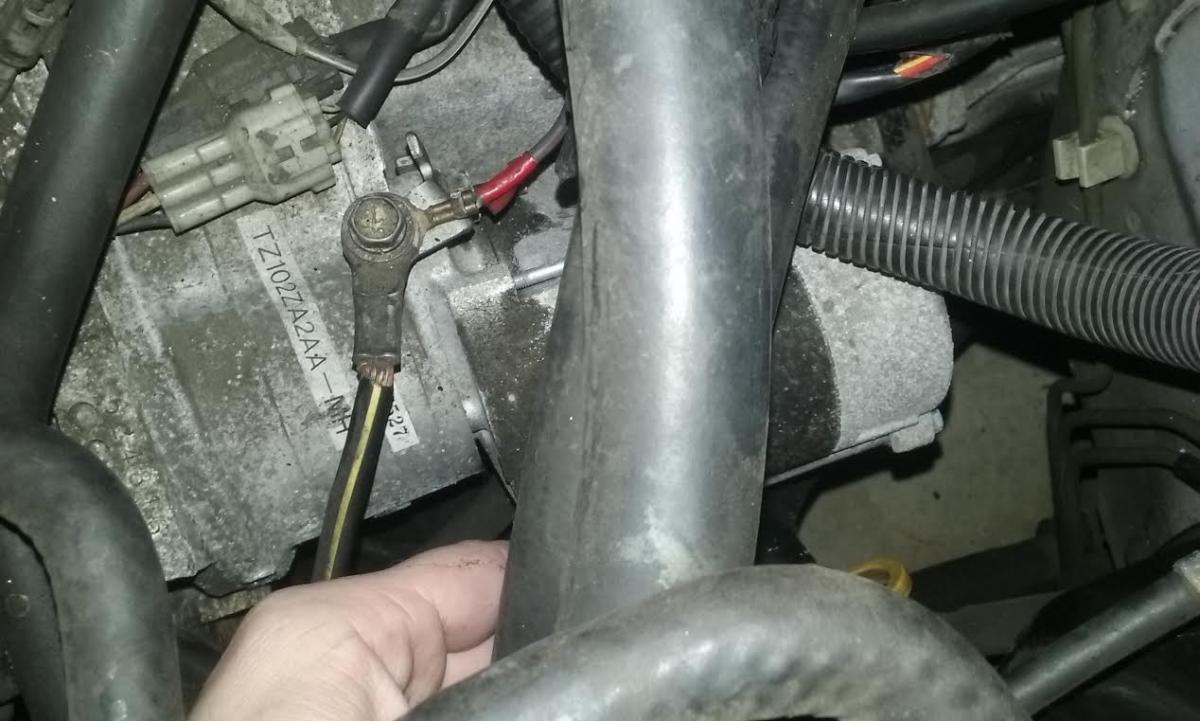

Orion Posted January 3, 2016 Share Posted January 3, 2016 1994 Legacy. Starter was replaced a few years ago, and the car has not been used much since. Sometimes it would just click when trying to start. If it would not start, jumper cables would remedy the problem. Now it wont do anything at all when trying to start it, even with jumper cables Battery is good Automatic trans The "trigger" wire to the starter is reading 0 volts when the key is turned to the cranking position. I do not believe that the starter itself is bad, I just think its not getting the 12v signal to energize the solenoid. My best guess: Starter relay is failing/bad? Help! Where is the relay located? Under the dash near the steering column? Could it be something else? I have attached pictures that should be of some use. Quote Link to comment Share on other sites More sharing options...

Orion Posted January 3, 2016 Author Share Posted January 3, 2016 (edited) Good info guys, here is where it is at: In park: No click or power draw while trying to crank it. In neutral: Clicks once and draws power (dash lights dim slightly) when key is turned to crank position. Jumping the starter trigger wire directly to the battery: Click is much louder.(motor turned ever so slightly on first try, then stopped) So the starter is bad again, or the motor is seized, right? Edited January 3, 2016 by Orion Quote Link to comment Share on other sites More sharing options...
Fairtax4me Posted January 3, 2016 Share Posted January 3, 2016 Battery voltage may be too low, or battery cables/terminals are corroded. I would definitely suspect that if it has replacement terminals. Also be sure to check the ground cable connection on the block. Had a tractor starter run me around the mill earlier this week because of corroded cables. 1 Quote Link to comment Share on other sites More sharing options...

Cougar Posted January 4, 2016 Share Posted January 4, 2016 Like you suspected, there should be 12 volts getting to the starter solenoid. There is a bad connection somewhere between the ignition switch and the solenoid. Since the starter didn't crank well when you jumped power directly to the solenoid you either have a low battery, bad battery connections, or a bad cable due to internal wire corrosion. There should be at least 11 volts at the battery posts when the starter motor is working correctly and running. 1 Quote Link to comment Share on other sites More sharing options...
