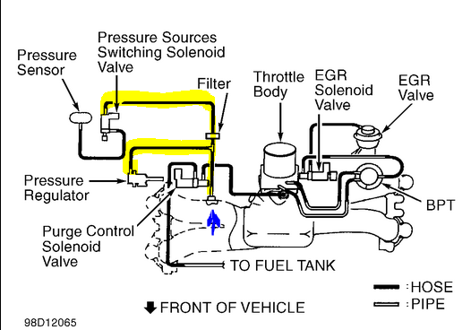

biggman100 Posted January 20, 2016 Author Share Posted January 20, 2016 (edited) The only solutions i can see, none seem feasible. Either take the intake off the 2.2 and retrofit the vacuum lines from the 2.5, but, the last time i tried that, on another legacy,the car would barely run, find an intake from a 95 or 96 2.2, with the canister connections, which will be too expensive, or, figure out how to connect the canister properly to the current intake, which, i have no clue how to do. This is the first time i have ever had this issue when swapping a 2.2 into a 95-99 legacy, and, i have done at least 40 of those swaps. The car is an auto trans, and, so was the car the engine was pulled from. According to the attached pic though, one side of the valve is supposed to go directly to the tank, so, could i just run that line to the canister under the hood? Edited January 20, 2016 by biggman100 Link to comment Share on other sites More sharing options...

biggman100 Posted January 20, 2016 Author Share Posted January 20, 2016 One thing that really puzzles me though, there are no lines, other than the one going to the solenoid and map sensor on the strut tower, so, how does the solenoid under the intake connect directly to the rear canister, as the pic i posted seems to show? Link to comment Share on other sites More sharing options...
