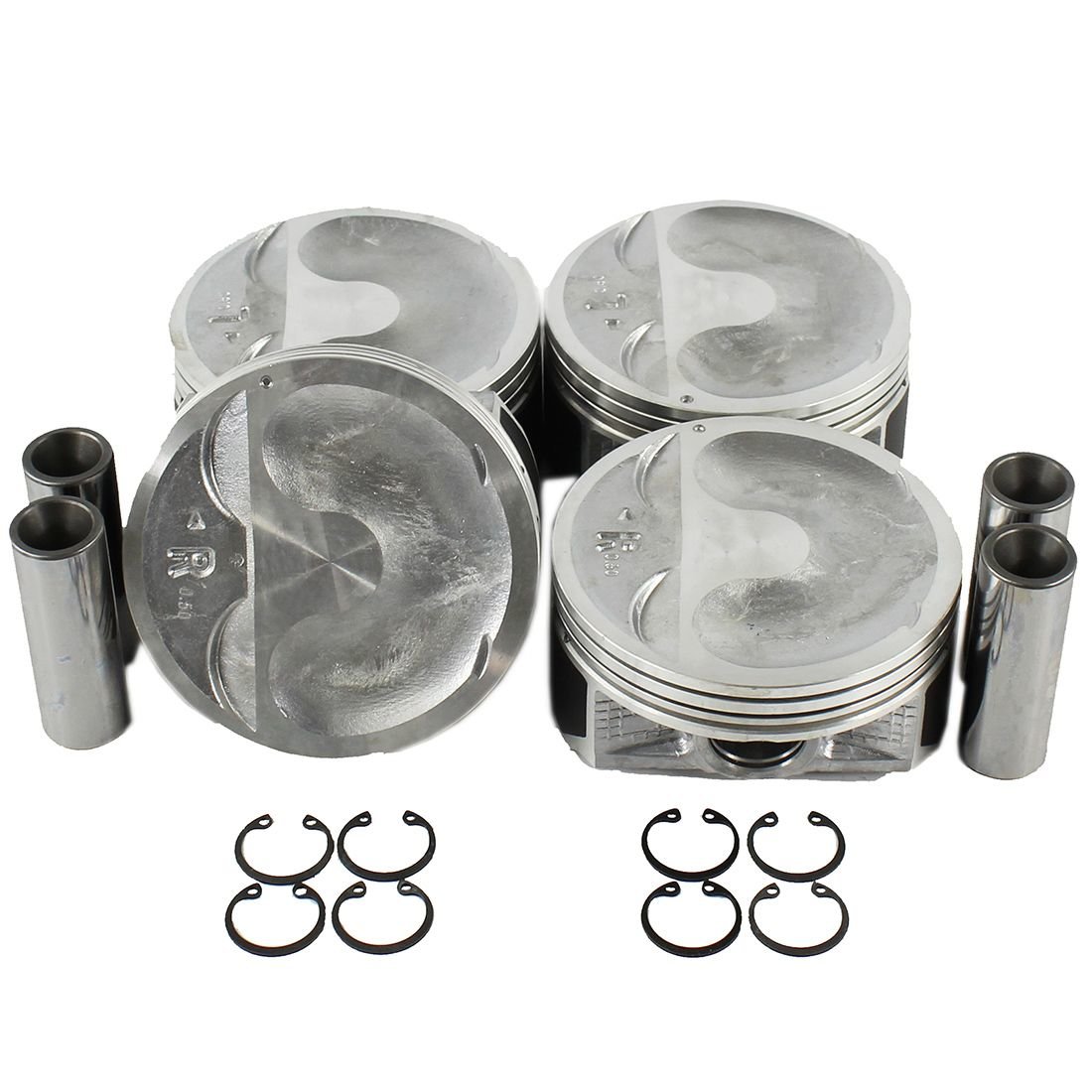

86BRATMAN Posted January 21, 2016 Share Posted January 21, 2016 The head won't work, the 04 and 05 pzev motors have a unique piston design with large domed segments. These pistons would make full contact with the heads. Best option is to resell the engine and purchase another, being more careful to check it out before you hand over money. Link to comment Share on other sites More sharing options...

FerGloyale Posted May 31, 2019 Share Posted May 31, 2019 put the EJ251/3 pistons in the EJ259 block. throw a new set of rings on while yer at it. Use the EJ251 heads. done Link to comment Share on other sites More sharing options...
05Pzev Posted May 31, 2019 Share Posted May 31, 2019 On 1/21/2016 at 1:51 AM, 86BRATMAN said: The head won't work, the 04 and 05 pzev motors have a unique piston design with large domed segments. These pistons would make full contact with the heads. Best option is to resell the engine and purchase another, being more careful to check it out before you hand over money. Expand Are you sure that they are domed and not dished? They look like they have negative , not positive volume to me. Link to comment Share on other sites More sharing options...
1197sts Posted March 15, 2021 Share Posted March 15, 2021 I have a similar situation, I am working on a 2004 Outback with an EJ259 that threw a rod, so the lower end is toast. I would like to install a EJ251 lower end and use the 259 heads. Will this work? Swapping pistons is not an option as the original 259 lower end is not usable and I don't have any other 259 pistons, and using 251 heads is not an option due to the single port exhaust. I have seen people speculate that it would be reduced compression but not much, can anyone verify that? One other question, when an EJ blows a rod, the oil system is contaminated. If I completely disassemble the head and clean out the oil passages in the head and the inside of the cam is it likely to be usable, does it usually do much damage to the cam bearing journals? Light enough damage a little scotch brite will do the trick? Link to comment Share on other sites More sharing options...
