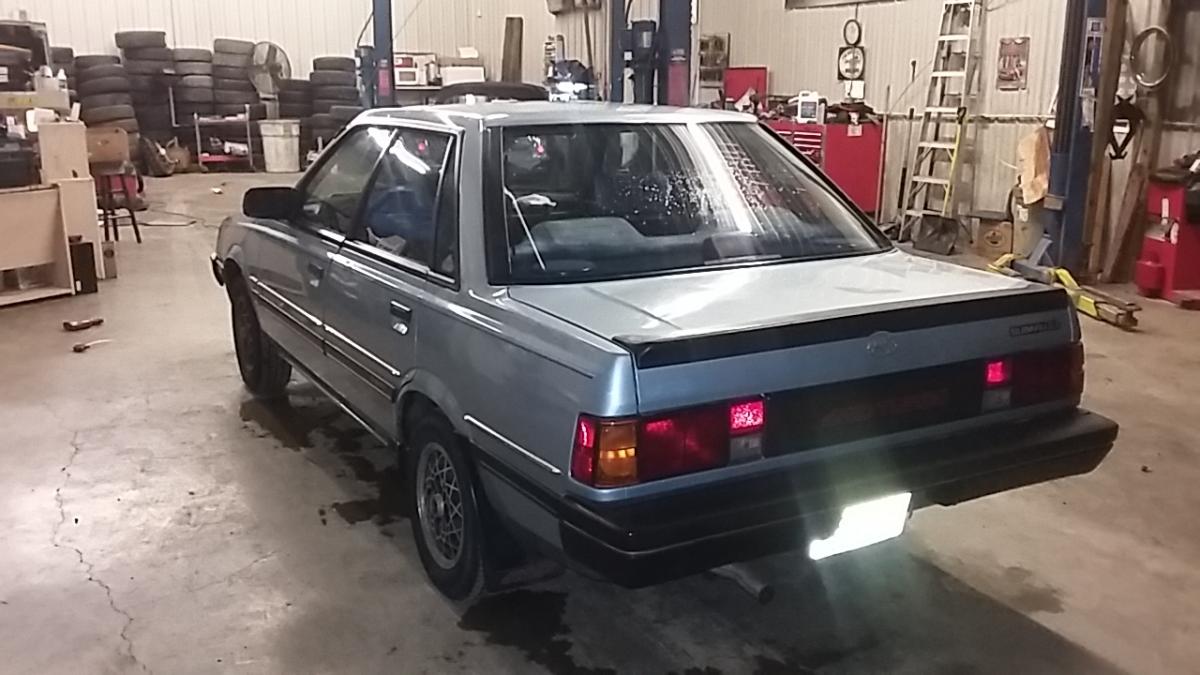

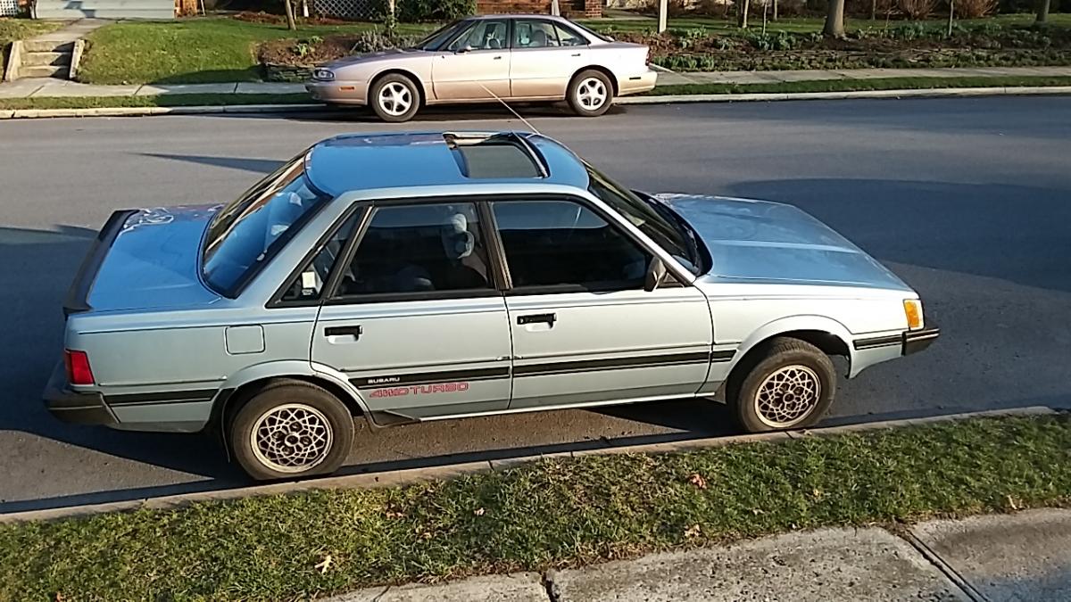

And now, after all these wheezy naturally aspirated EA82s, I have gotten myself a forced induction 86 GL-10 with 78k miles on it. Automatic, with push button 4WD (3 speed) As yet unnamed.
Air suspension. Digital dash. Sunroof. Sky blue. 9/10 interior. 8/10 exterior. Here it is:
And, naturally, the absolute very first thing I did was swap over those 84 GL alloys to it.
