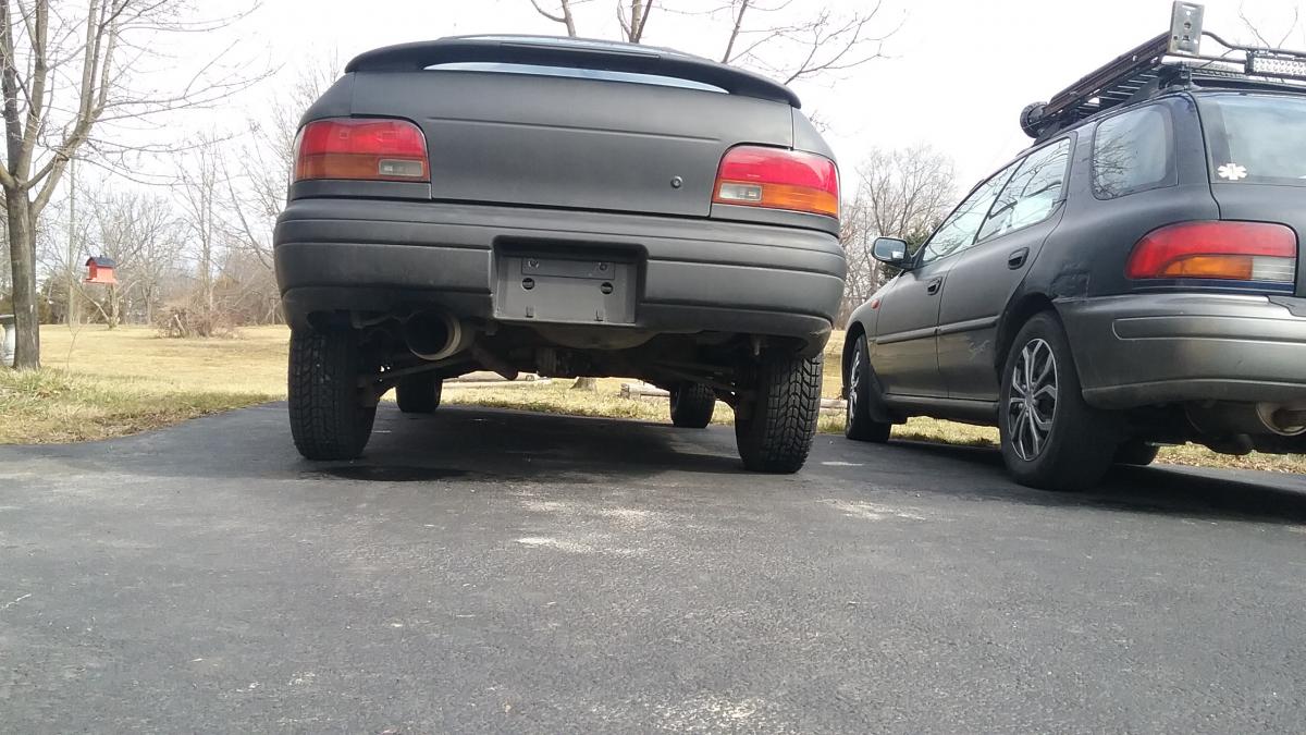

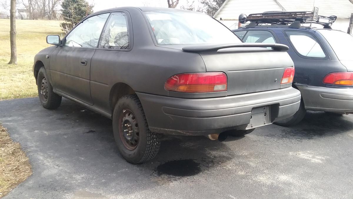

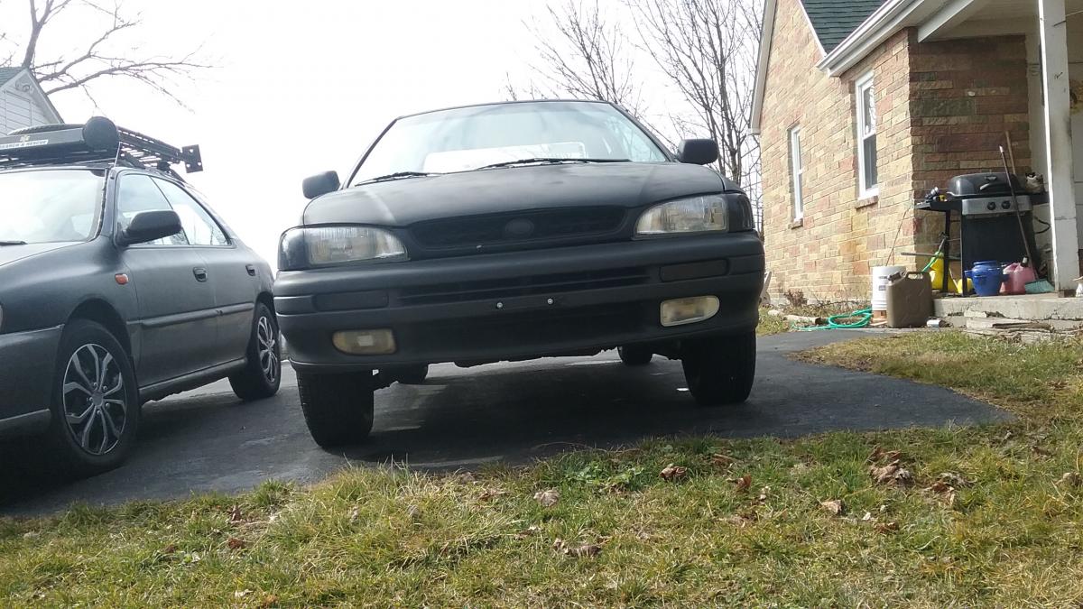

Fubaru Posted March 8, 2016 Author Share Posted March 8, 2016 (edited) Pics as promised. One upside, the "cool hood" and corner lights swapped direct from the OBS. Edited March 8, 2016 by Fubaru Link to comment Share on other sites More sharing options...
Jtateam Posted March 8, 2016 Share Posted March 8, 2016 Heck ya! Gonna be a sweet little car!! Link to comment Share on other sites More sharing options...

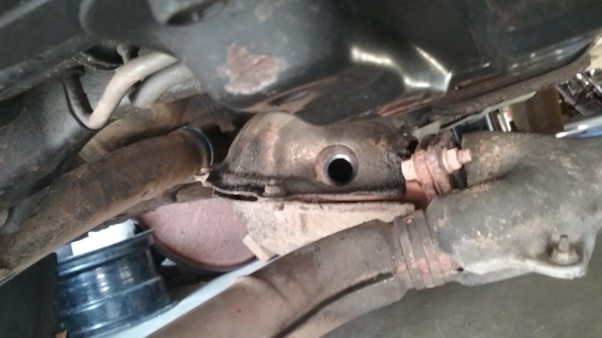

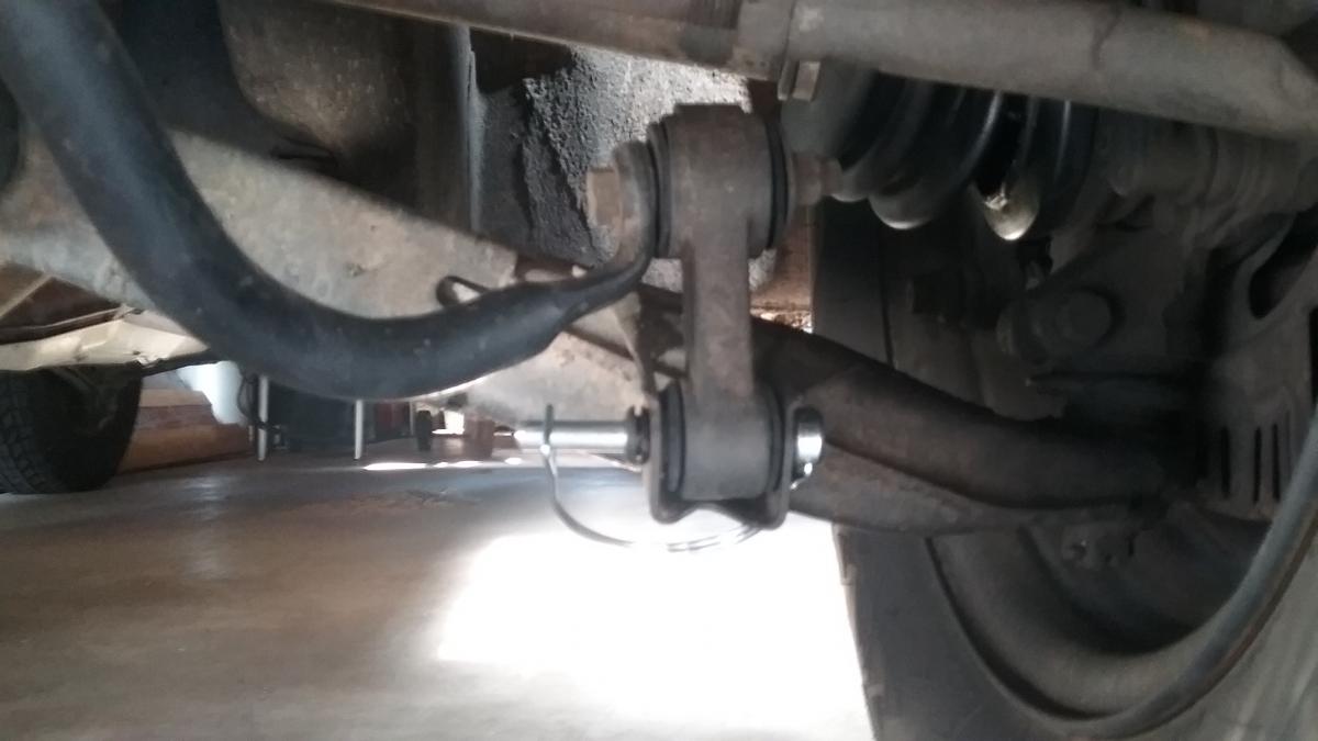

Fubaru Posted March 22, 2016 Author Share Posted March 22, 2016 QD Sway Bar links were easy enough. I still want to shorten the pin shafts and the wire locks so they aren't a snag point. Attempted to change the O2-sensor and the old one came out way too easy.... With the bung attached. Looks like a new cat is going to take priority. Link to comment Share on other sites More sharing options...

Fubaru Posted March 23, 2016 Author Share Posted March 23, 2016 Simple enough. Got the cat off the car, gutted it, welded the bung back in and re-installed the exhaust today. Car still runs like crap (different post) but I finally found (and ordered) luggage rack crossbars that allegedly fit as well as a fumoto valve to hasten oil changes. .....baby steps. Link to comment Share on other sites More sharing options...
