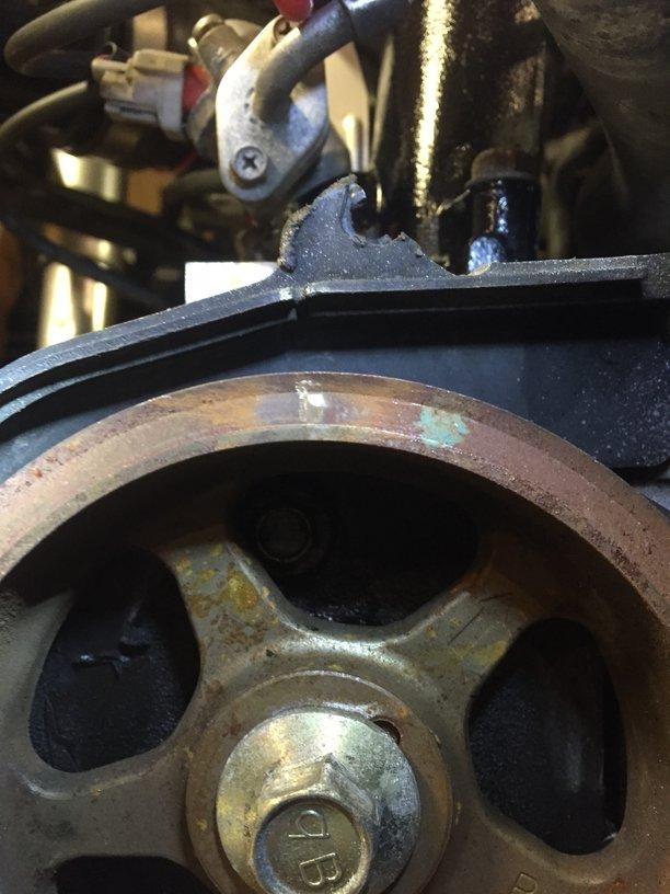

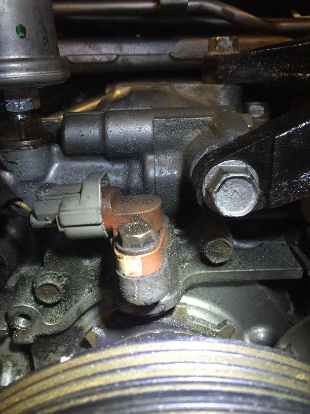

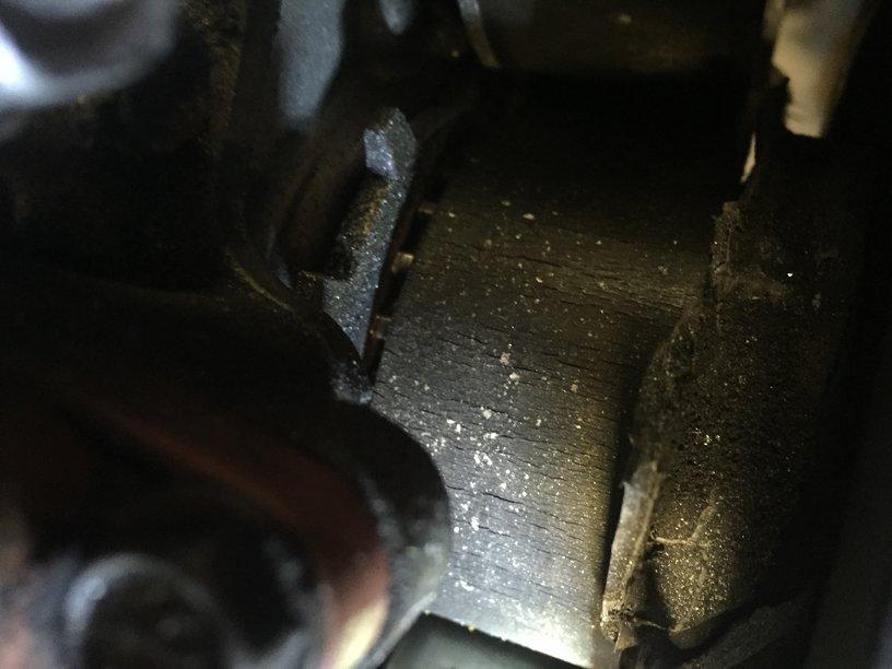

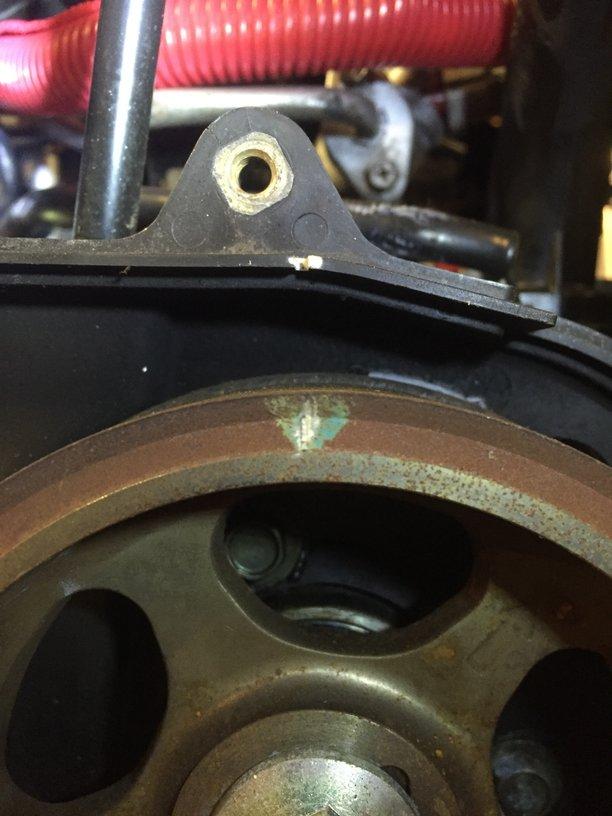

hello everyone new to the forums and not sure if im in the right area, if not im sorry. I have a concern with my timing belt my common sense tells me the belt skipped some teeth on the crank shaft here some pictures. the mark on the sprocket is way off but i barely ran it enough for me to think that it did skip some teeth. It looks like the belt was never replaced, it looks like total garbage. The motor is out of a 95 legacy lsi (ej22) The other problem (assuming the timing is off because of the location of the timing marks) is that the motor does not start it only back fires and white smoke comes out of the intake. There is no coolant in the motor yet. hopefully  I did this twice because i thought it may have been a ground issue or fuel delivery problem but its not. It  ran before i made a final wiring harness and thats why im confused.  hopefully I didnt destroy it.  :(Any info would be great guys thanks! :D

I'm not convinced I can see the timing mark on that crank sprocket. It's a pretty small mark on one of the tabs that make up the tone wheel.
And yea, crank sprocket only has to come off to get the covers off intact. If you don't care about the covers, it is definitely possible to change the belt with it on.
 That's because its almost 180 degrees off maybe not that much but i cleaned the grease off when i found it. I took pictures of the crank lined up to the block and the pulleys and its completely off.
