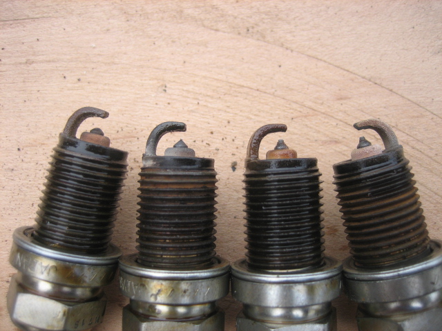

somick Posted March 15, 2016 Share Posted March 15, 2016 On my 2010 Forester manual recommends changing spark plugs every 30,000 miles. With your 99000 when was the last time the plugs were changed? Sam Link to comment Share on other sites More sharing options...
uniberp Posted April 13, 2016 Author Share Posted April 13, 2016 (edited) On my 2010 Forester manual recommends changing spark plugs every 30,000 miles. With your 99000 when was the last time the plugs were changed? Sam "Oops" should about cover it. My 97 S10 4.3 was my first new car, and the spec on plugs for that Chevy was 90k miles. I guess I thought that changing plugs was as old-timey as zurks. I've replaced more engines than plugs on subarus, none, thankfully, due to old plugs. So this is what original plugs look like at 100k. #1 is on the left. Idk what the others are. And the new driveshaft for the S10 has zurks. Oh well, we'll all have self-driving cars soon. Edited April 13, 2016 by uniberp Link to comment Share on other sites More sharing options...
