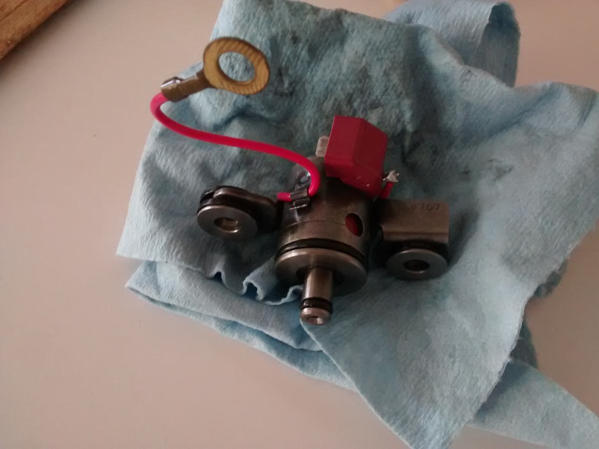

Tetonvalleynick Posted March 15, 2016 Share Posted March 15, 2016 (edited) I am getting an P0748 error and when I do the special handshake with the transmission it gives me a 75. On a side note I have read numerous notes of checking the resistor? I was not sure what to look for when looking for it. It's suppose to be on the fender on the passenger side, but I didn't see anything that looks like a resistor there. Both of those codes are for the line pressure solenoid. I pulled the pan off and all of the solenoids ohm at ~15 but 2. One of the ohms at 4.8 and the other doesn't at all. I am guessing the one the doesn't work is the line pressure solenoid. This doesn't seem to match what I have seen/read from peoples 4eat's, is this trasmission a 4eat? There seem to be at least 3 different types of solenoids. If I can't find this part in a junk yard can I use the solenoid from the dealer that is the 2-4 brake solenoid. They said there wasn't a pressure solenoid in their system. transmission type on vin plate says TZ1A3ZC2AA Here's a picture of the solenoinds: Edited March 15, 2016 by Tetonvalleynick Link to comment Share on other sites More sharing options...

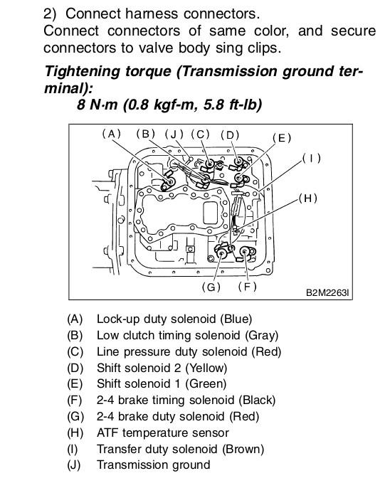

Tetonvalleynick Posted March 16, 2016 Author Share Posted March 16, 2016 (edited) Thanks Fairtax4me Has anyone pulled one of these out and can tell that there is a trick or more than a little tug to get them out. I'd rather not break something else inside the valve body. The service manual just said to remove them. Here are the names and locations of the solenoids for anyone who looks at this later. Edited March 16, 2016 by Tetonvalleynick Link to comment Share on other sites More sharing options...

Tetonvalleynick Posted March 16, 2016 Author Share Posted March 16, 2016 Giving it a twist as I pulled helped. It still was more pressure to remove than I expected from just o-rings holding it in. Here is a pic of it removed for future reference: Link to comment Share on other sites More sharing options...

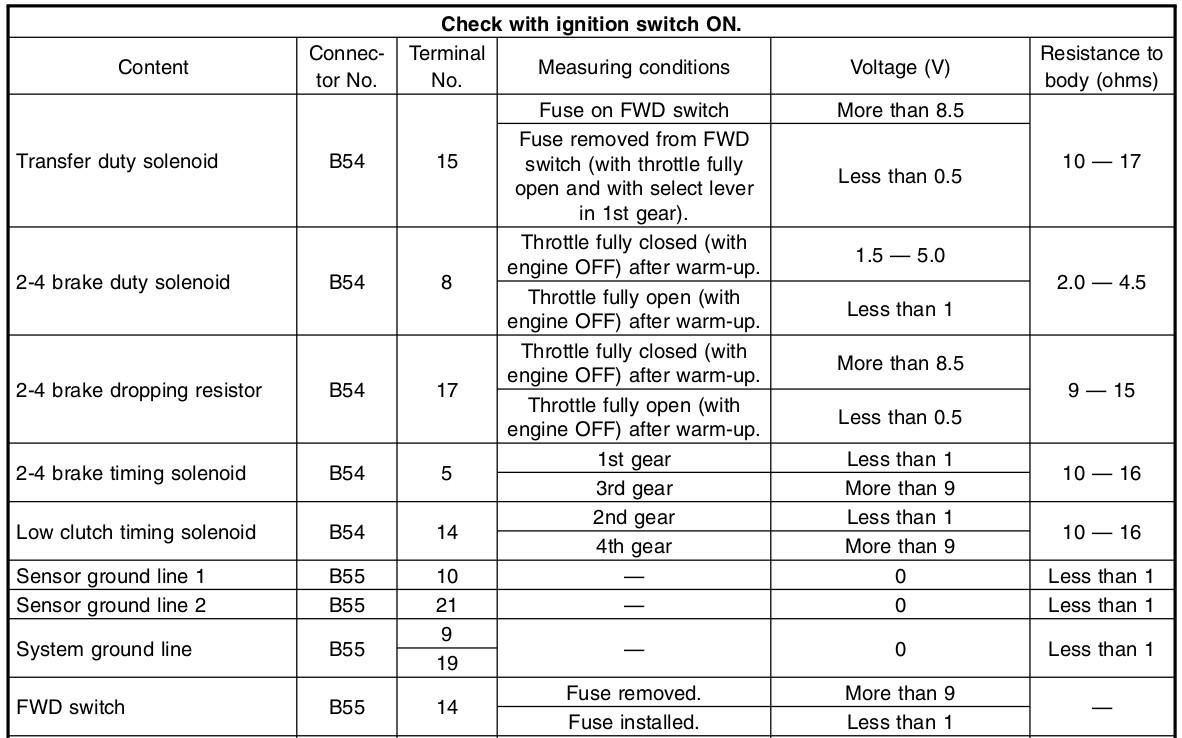

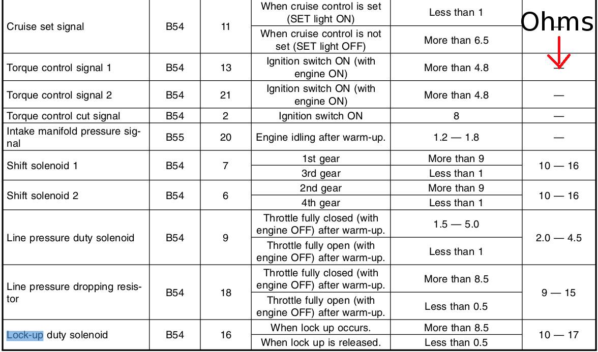

Tetonvalleynick Posted March 16, 2016 Author Share Posted March 16, 2016 Okay I got the line pressure solenoid from a transmission in the junk yard. It ohms out to 3.3, along with the 2-4 brake solenoid. All the other solenoids ohm to 13.8 except the lock-up duty solenoid which ohms to 13.0 All of those appear to be within spec. specs for reference: Is there anything else I should check while I have the transmission pan off. I don't feel like cleaning gasket off this pan again for a very long time. Link to comment Share on other sites More sharing options...
