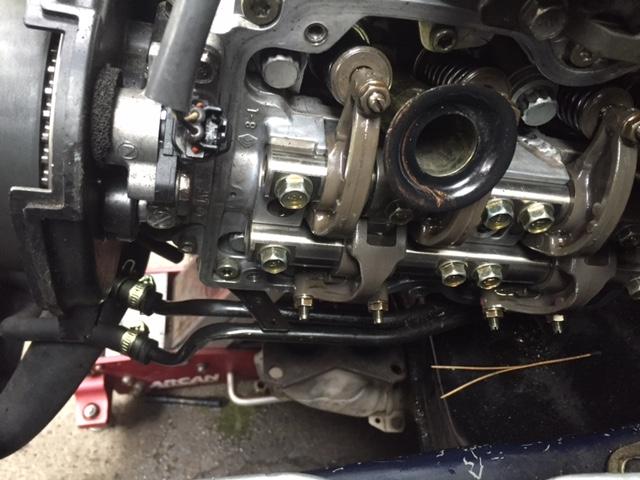

steve56 Posted March 23, 2016 Share Posted March 23, 2016 Im adjusting valves on DS head because they are really noisy after valve job. Ive got the cam arrows at 6 oclock which is supposed to be position for cylinder #2 valve adjustment. The rocker arm that pushes against those valve is tight on the intake valves but has alot of play on the exhaust valves. I also noticed this when I adjusted the valvles with the head off . Is the rocker arm for exhaust valves supposed to have playat the 6 oclock cam position for cylinder #2 How do I adjust the exhaust valves with play in the rocker arm. I'm missing some logic on this issue. Is is the loose rocker arm causing the clacking sound on DS head? Link to comment Share on other sites More sharing options...
bakedpotatoechips99 Posted March 23, 2016 Share Posted March 23, 2016 I'm not sure 6 O'clock is the right position for adjustment. It may be correct. You want to make sure it is Top Dead Center/TDC firing position though, because ALL valves should be FULLY CLOSED (in the optimal adjustment position) in that scenario, and hence, READY TO BE CHECKED AND ADJUSTED ACCORDINGLY. There is a range of acceptable adjustment, so 1-3 thousands of difference should not be a huge issue. "Go, no Go", in other words, if you want them at 12 thousandths/.012 of an inch, if a .010 or .011 will not fit, but a .012 will, then you know you are at 12 thousandths of an inch. Your exhaust valve expand the most under operating conditions, and, hence, usually are adjusted a tiny bit looser than intake valves. Still, though, intakes cannot be too tight either because they will also expand with heat. Link to comment Share on other sites More sharing options...

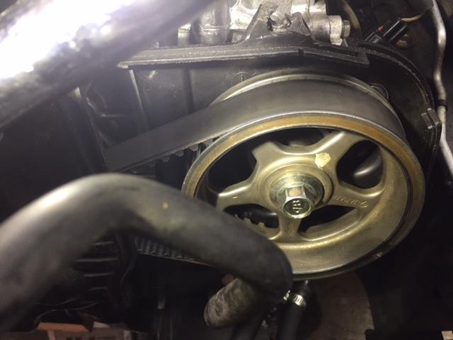

steve56 Posted March 24, 2016 Author Share Posted March 24, 2016 (edited) Now that I have the head and timing belt back on, and have rotated the engine a few times from crank bolt, it looks like I just didn't have the exhaust valves set correctly while doing it on the bench. It sure was alot easier to get to them on the bench though. Edited March 24, 2016 by steve56 Link to comment Share on other sites More sharing options...
