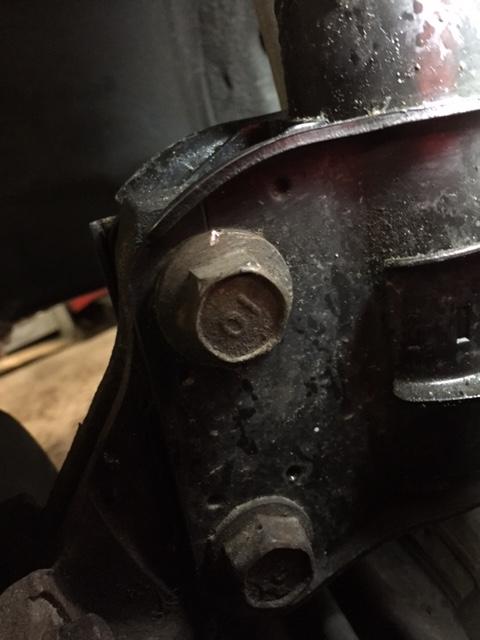

wtdash Posted March 30, 2016 Share Posted March 30, 2016 (edited) FYI - there are different ways to replace the axle, but you must gain clearance by disconnecting the ball-joint, top strut bolt, or maybe another way. I always remove the TOP 'camber' strut bolt (loosen the bottom) and to AVOID needing an alignment I always mark its location PRIOR to removing it, and just put it back where it was. It's always been close enough to not mess up the alignment. And don't use too small of a punch to remove the roll pin on the inner part of the CV...it'll stick in the hole and you'll be....upset. GL, td Edited March 30, 2016 by wtdash Link to comment Share on other sites More sharing options...
New2Subaru1 Posted March 30, 2016 Author Share Posted March 30, 2016 FYI - there are different ways to replace the axle, but you must gain clearance by disconnecting the ball-joint, top strut bolt, or maybe another way. I always remove the TOP 'camber' strut bolt (loosen the bottom) and to AVOID needing an alignment I always mark its location PRIOR to removing it, and just put it back where it was. It's always been close enough to not mess up the alignment. And don't use too small of a punch to remove the roll pin on the inner part of the CV...it'll stick in the hole and you'll be....upset. GL, td My Uncle has a 93 legacy wagon, so hes going to help me get it done! thank you Link to comment Share on other sites More sharing options...
