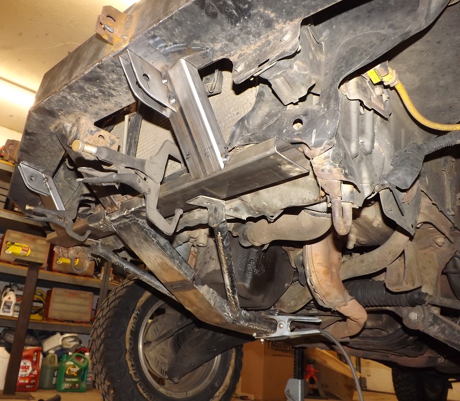

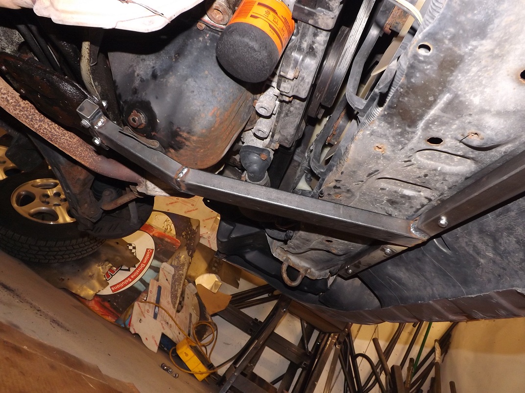

scalman Posted April 26, 2016 Author Share Posted April 26, 2016 so this would be better then some home made skid plate like this? and which one better as for skid plate covers engine and that made from bars just protects. i mean from offroading experience which is better . skid plate from doesnt look anything that strong it would bent with more preasure i guess. Link to comment Share on other sites More sharing options...
pontoontodd Posted April 26, 2016 Share Posted April 26, 2016 so this would be better then some home made skid plate like this? and which one better as for skid plate covers engine and that made from bars just protects. i mean from offroading experience which is better . skid plate from doesnt look anything that strong it would bent with more preasure i guess. I would think you'd bend a flat skidplate like that more easily than tubing. A big skidplate like that will protect the exhaust and control arm mounts better than what I built though. It really depends what you're doing with the car. If you want to slide up dirt berms, the flat skidplate is probably the way to go. If you're worried about a giant rock in the middle of the trail taking out your oil pan, a piece of tubing will provide more protection. Link to comment Share on other sites More sharing options...
scalman Posted April 26, 2016 Author Share Posted April 26, 2016 or you can put some tubing and on top skid plate . i was thinking still use my oem plastic skid plate and just put under it some tubing in places that needs to be secured. but maybe im wrong here. im not thinking of doing notin too extreme realy but just in case i would hit something its better to be ready then too late no ? Link to comment Share on other sites More sharing options...

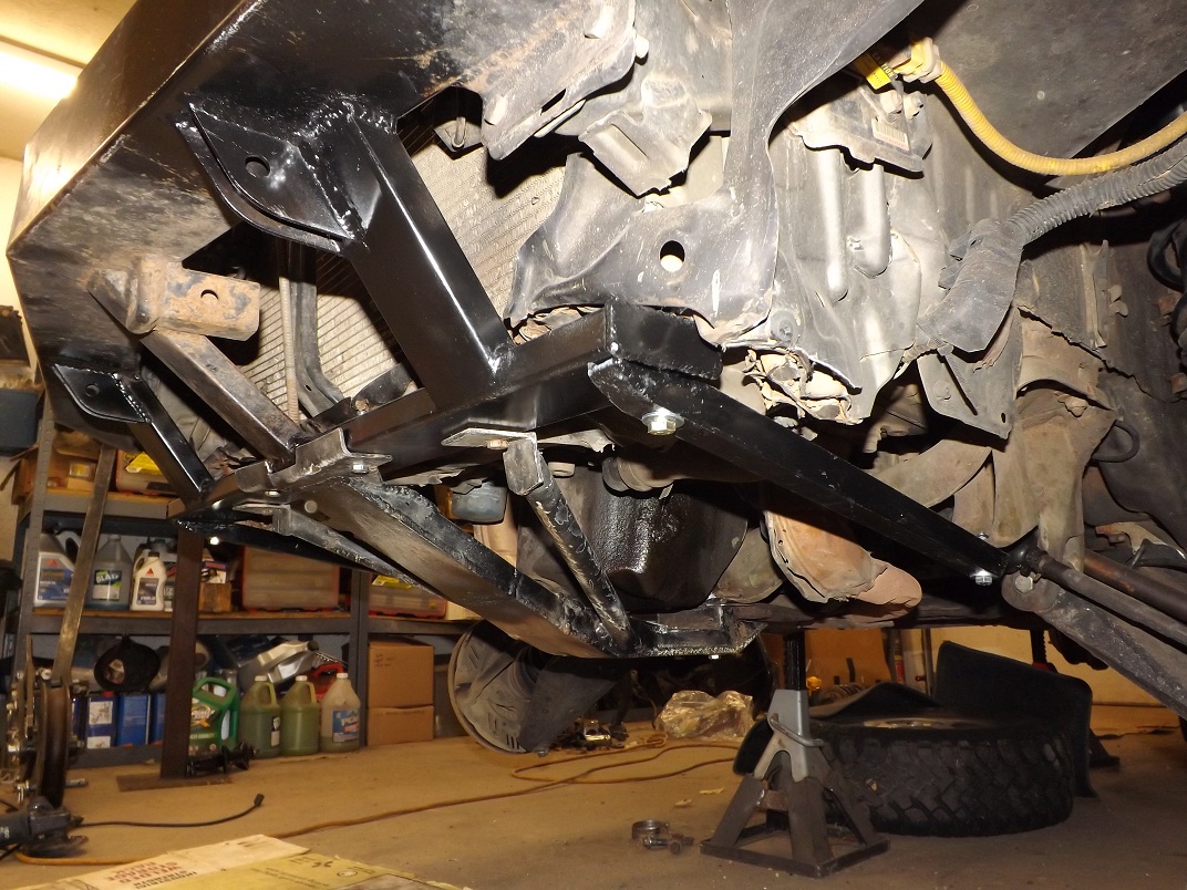

scalman Posted April 30, 2016 Author Share Posted April 30, 2016 thats how it looks now Link to comment Share on other sites More sharing options...
