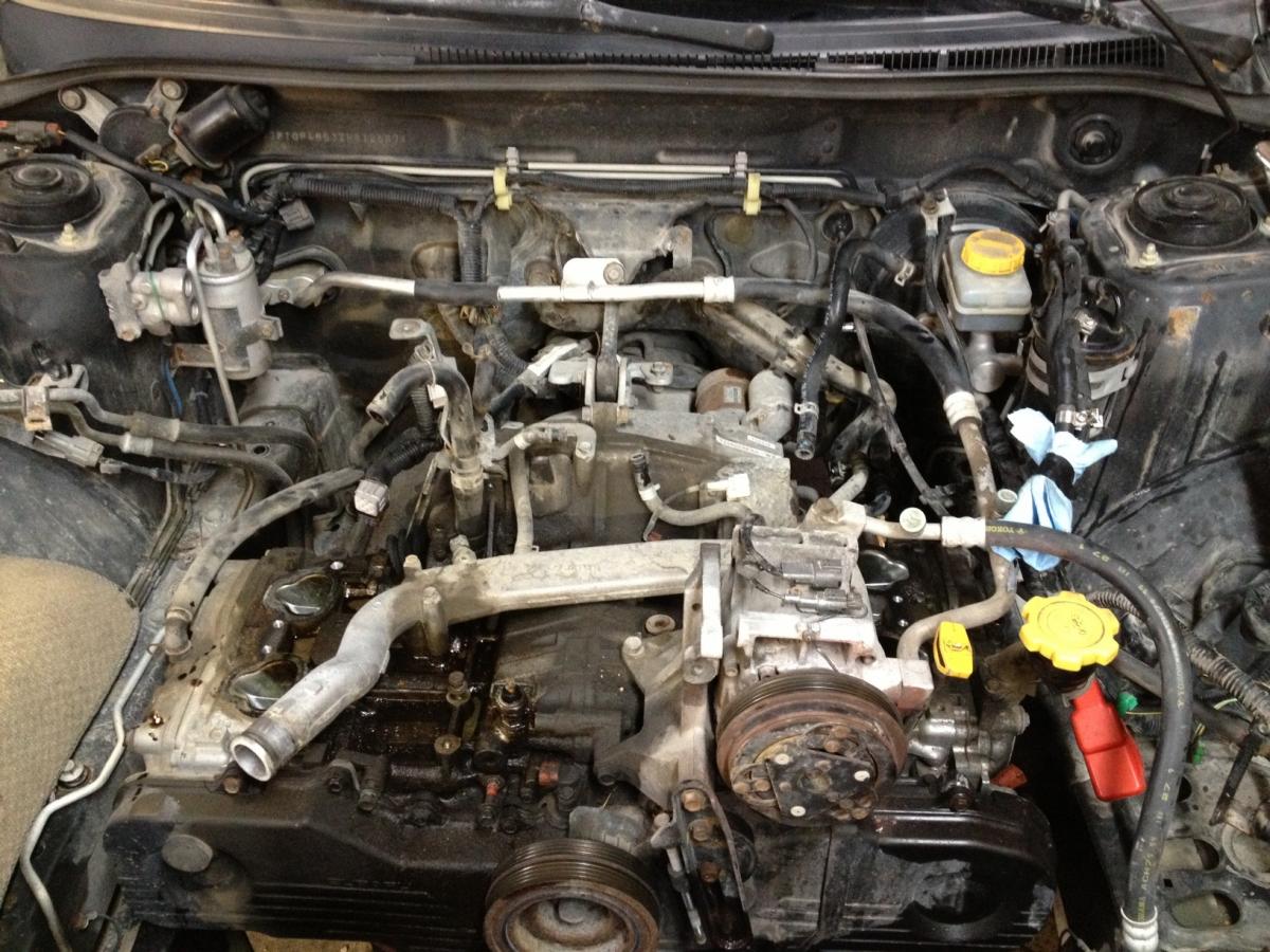

April 26, 201610 yr Author Here it is... Near the top left corner of the picture. It's a grey plug with an orange 4 pin interior section. It is below the wiper motor but inline (vertically) with the right edge of the wiper motor.
April 26, 201610 yr I believe that's the plug for the cruise control servo. If your car had cruise it would be plugged into that. The cars come with the cruise control wiring already in them.

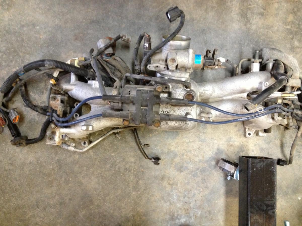

April 27, 201610 yr Author I took this picture to show that it does look like I'm "missing" something from the top of my throttle body. Maybe this is the cruise control that was mentioned before? 3 holes in-line and all 3 are on top of the throttle body. I still don't know exactly what plugs into it, but this is kind of frustrating.
April 28, 201610 yr Nothing goes on the throttle body there. Cruise control would have a cable coming from the servo connecting to one of the two levers on the throttle linkage.
