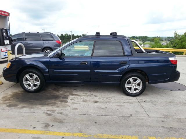

mkc1962 Posted June 2, 2016 Author Share Posted June 2, 2016 Have looked at a few. Drove a few hundred miles to buy a 2005 na. 140k miles, dark blue, extremely clean, runs great. But very well documented Maintensnce wise. Does have external weeping Head gaskets, but I already have the parts to do a total reseal. So far have driven it about 1500 miles, avg 28-29. Look fwd to making it mine and the way I want it to be. Thanks To this forum for all the input. 1 Link to comment Share on other sites More sharing options...

mkc1962 Posted June 8, 2016 Author Share Posted June 8, 2016 Thanks for the continued input and comments....yes I bought the 2005 I posted pics up two posts up. Spent this last weekend pulling the engine and doing a total reseal to deal with the head gaskets and other small fulid weepages. New Clutch kit, and all new rubber under the hood as well as full tuneup...she should be great to go for a very long time...so far really like it and not disappointed with my avg mpg which is sticking close to the 30 mark. The AC Compresor clutch went out yesterday, and it seems you cant find just clutches or clutch coils anymore, so a remanned compressor is now on its way. But at 11 years of age such is possible. Link to comment Share on other sites More sharing options...
