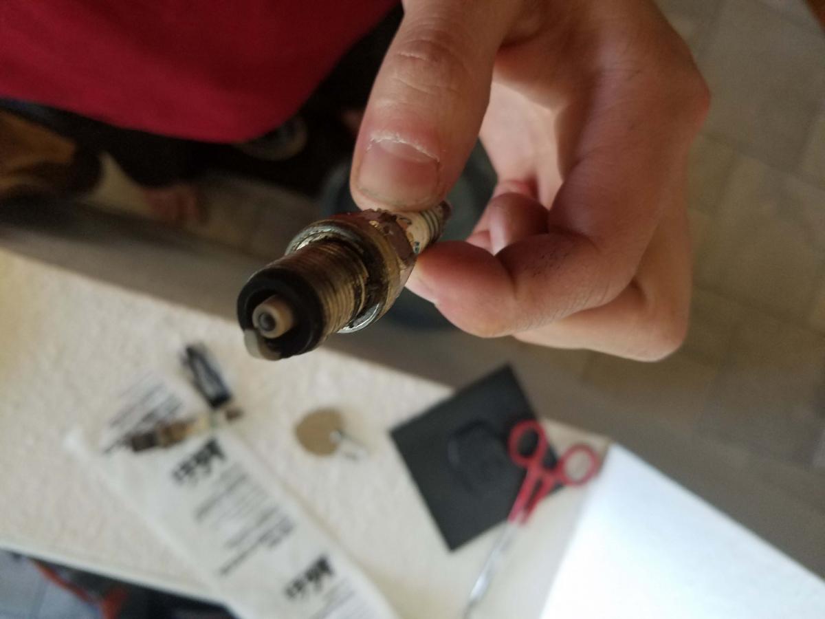

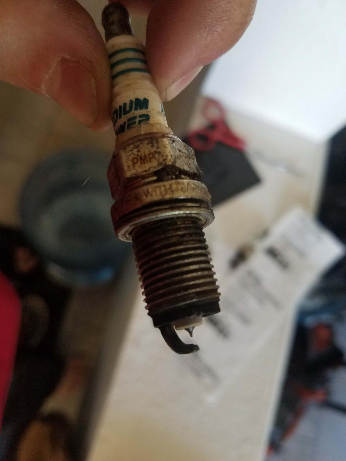

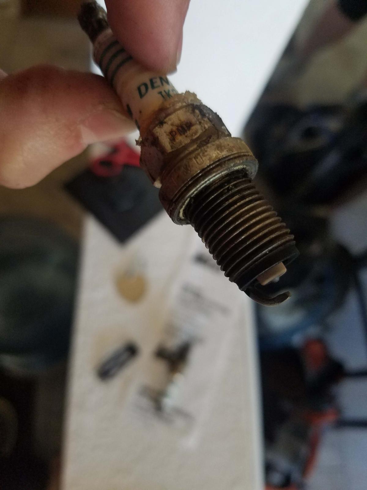

Daskuppler Posted May 3, 2016 Author Share Posted May 3, 2016 Thanks for the input everyone. Attached are some pictures of a good plug and a bad plug. Link to comment Share on other sites More sharing options...
Daskuppler Posted May 3, 2016 Author Share Posted May 3, 2016 Link to comment Share on other sites More sharing options...
Fairtax4me Posted May 4, 2016 Share Posted May 4, 2016 What's the part number on the plug? Looks like what I've seen from platinum plugs when the platinum gets knocked off the electrode during gapping. Did you use a gap tool on those? 1 Link to comment Share on other sites More sharing options...
Daskuppler Posted May 4, 2016 Author Share Posted May 4, 2016 On 5/4/2016 at 2:21 AM, Fairtax4me said: What's the part number on the plug? Looks like what I've seen from platinum plugs when the platinum gets knocked off the electrode during gapping. Did you use a gap tool on those? I don't remember the part number, it's been a couple years since they were purchased. No gapping tools were used. They were simply removed from the packaging and installed with a little di-electric grease. Link to comment Share on other sites More sharing options...
Fairtax4me Posted May 4, 2016 Share Posted May 4, 2016 Then those plugs just don't agree with the waste spark system. Try NGK laser platinum. Those are often recommended for that engine. 1 Link to comment Share on other sites More sharing options...
