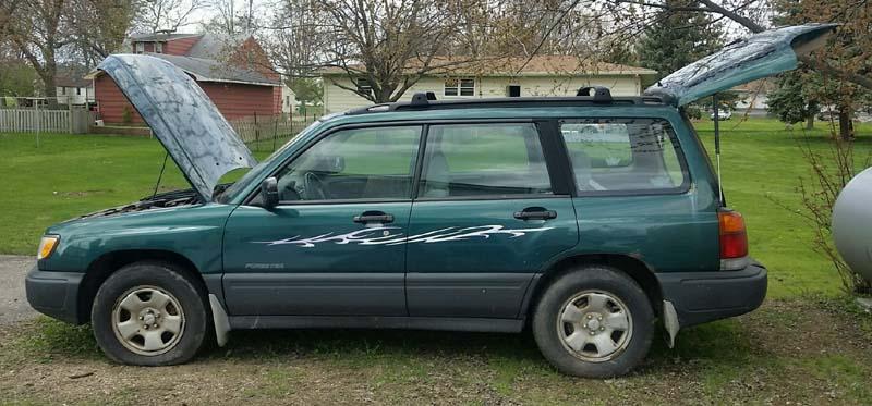

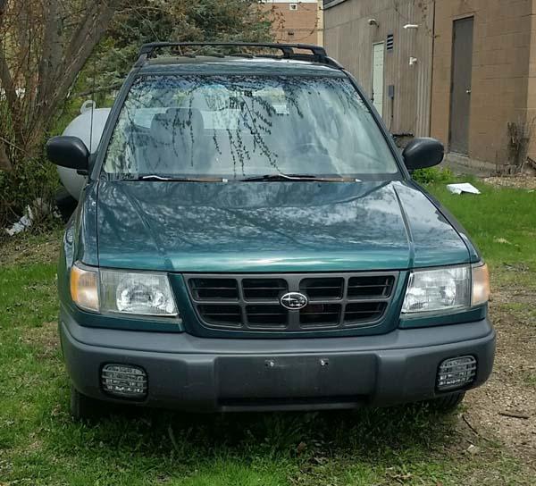

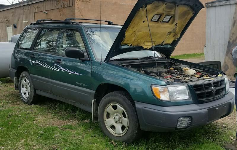

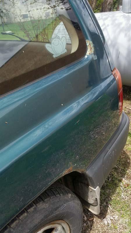

heartless Posted May 4, 2016 Author Share Posted May 4, 2016 i do know these folks are not the original owners of this car. But I do know them well enough to trust that they have not overheated it badly - prior to them getting the car, however, that is a complete unknown... both the Foz and the 95 Lego are autos, so compatibility should be no problem as far as that goes. I will be completely honest about not being real keen on the idea of rebuilding the EJ25D - just dont care for the motor at all... so itwould probably be best to yank it and sell if anyone wants it. around my area, however, there is zero market for that engine. Subaru's of the older vintages are relatively rare here - most are newer (mid 2000's & up) and even those are not super common. anyway - pics of the car... last pic is the worst of the rust that is visible - drivers side rear wheel well and the corner of the rear cargo area window... Link to comment Share on other sites More sharing options...
idosubaru Posted May 4, 2016 Share Posted May 4, 2016 very little rust for that era, granted it'll only get worse but so far looks like nothing big over the next 5 years which is 100,000 miles if you drive 20k/year. it's the same around here - pre-2000 is a dying market due to rust taking them out early and that adds the perceptive aging of nicer ones of the same vintage, they just seem old when there's fewer and fewer of them and more and more of them are rusty, holy, in disrepair. people dont' want them. Link to comment Share on other sites More sharing options...
