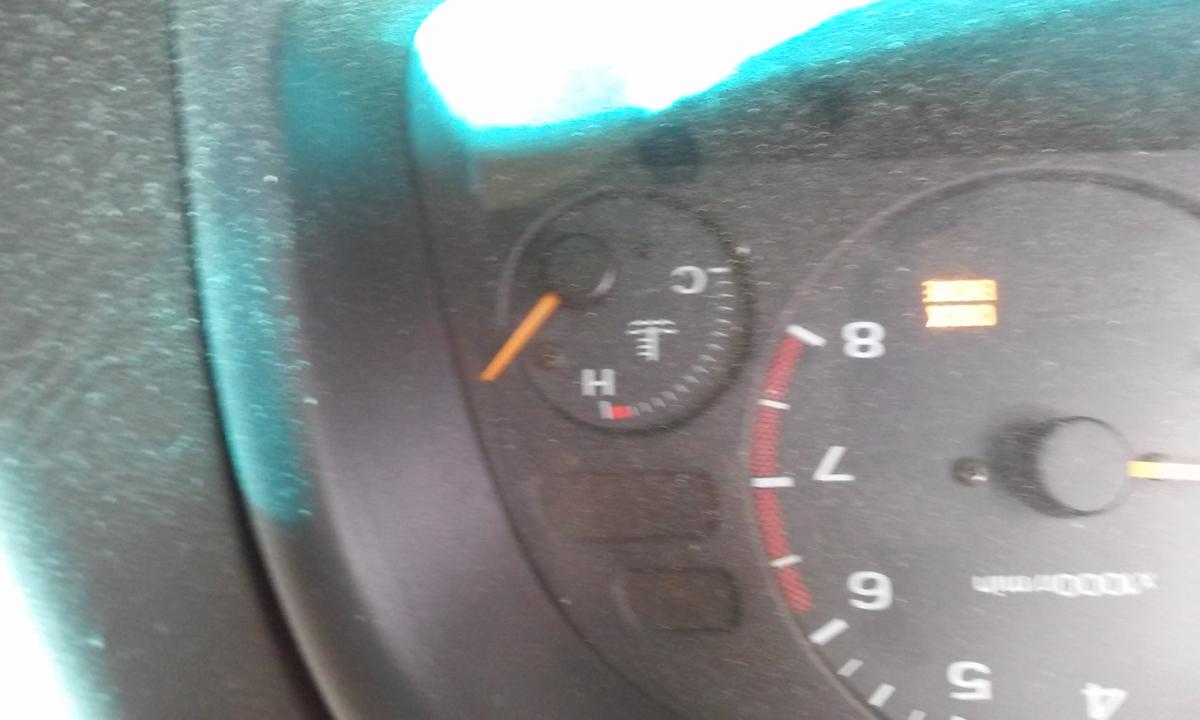

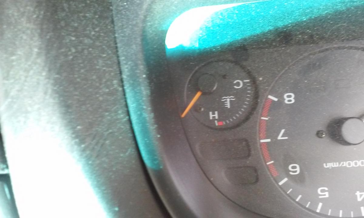

Robb Posted June 5, 2016 Share Posted June 5, 2016 I am stumped, the engine is not overheating. Photos of the dash attached. Link to comment Share on other sites More sharing options...
john in KY Posted June 5, 2016 Share Posted June 5, 2016 Replacing the temperature sensor may fix this. Also check the condition of the wire at the sensor. Link to comment Share on other sites More sharing options...
Robb Posted June 5, 2016 Author Share Posted June 5, 2016 Thank you John. Is the temp sensor at the back of the engine underneath the air cleaner? I'm seeing various locations google searching for ' 99 Forester Temp sensor location. Link to comment Share on other sites More sharing options...
