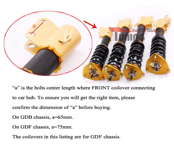

I have a 2006 Subaru Impreza 2.5i sedan - it's not WRX or STI. Need to replace factory suspension  due to age and wanted to get aftermarket coilover shock/strut kit. I looked around and the only ones I come across are for chassis GDF (WRX STI per item description) Specifically saying it 's not for chassis GDB.
Does anyone know if a coilover kit made for GDF would fit my '06 Impreza. When I asked at my local part stores they look at me like I have grown two heads. Online items just state to refer to item's description and purchase at your own risk. Worse case scenario I would simply return the product, but I would like to get the correct part the first time around.
Any help is greatly appreciated!
if it's the smaller 5x100mm hubs, anything that fits an 06 wrx will fit on your 2006 2.5i.
2006 sti has the larger 5x114.3mm hubs and will not fit.
just ask if it'll fit an 06 wrx, non-sti.
