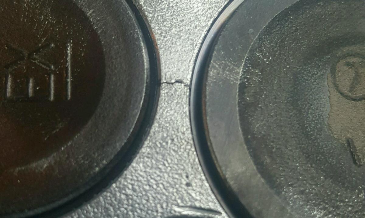

Nitsivart Posted June 14, 2016 Share Posted June 14, 2016 So I had my the heads for my 89 EA82 pressure tested and they both have pretty decent cracks between the valves. I'm stuck in a pickle now and am needing some advise from the people that have dealt with this stuff. My options as far as I see them are these: a) Run with the cracks and hope for the best 2) Get new heads III) Get these heads fixed up d) Get a crate engine and call it good I'm not a fan of the idea of using the cracked ones because I want this to be a reliable vehicle in the long run, don't want to have to worry about pulling the engine again soon. From what I can find new heads are like $250 ea plus shipping, so I'm looking at around $600 or so if I went that option, about the same price that I was quoted for getting my current heads fixed. I found a crate engine nearby with ~50k on it for $950, which would be a bit more than getting my heads done up but I would be getting a lot more out of it. If you were in my shoes which way would you lean? I'm even kind of thinking about just doing an EJ swap at this point, but I think everything for that is going to run me quite a bit more than just a crate EA82 and that cost already is starting to push at the top end of the budget I have for this build. Also, what's a good place to source heads around WA? I would rather not be shipping everything cross country. Thanks in advance for the help! Link to comment Share on other sites More sharing options...

Dee2 Posted June 15, 2016 Share Posted June 15, 2016 upload some pictures of the heads and folks will be better able to advise you. Link to comment Share on other sites More sharing options...
idosubaru Posted June 15, 2016 Share Posted June 15, 2016 you never actually said if they failed a pressure test? Or did the shop just balk? - a machine shop will take one look at an EA/ER head and deny the heads due to cracks. but the problem is those cracks are normal. cracks between the valves is normal - run them. nearly every EA82/ER27 on the road today has cracks between the valves, Subaru even calls it normal. usually machine shops freak out when they see those. Very few shops will know about that EA specific issue. they can repair them with "stitch pins" but it's all but pointless to do so. GD says they'll just crack again even if repaired, though i've never seen that myself. Link to comment Share on other sites More sharing options...
skishop69 Posted June 15, 2016 Share Posted June 15, 2016 They will crack again. They did on my XT GL-10. Looking back, I wouldn't have spent the money to fix them the first time even knowing this was normal. In all the years I've been a member here, I've heard of one case where the cracks spread far enough to actually get into the coolant passage, and I believe that engine had documented abuse. If pressed, most machine shops will do the head work, but won't warranty it unless you have them welded. Not really worth it since Subaru deemed it 'normal'. Link to comment Share on other sites More sharing options...
Nitsivart Posted June 15, 2016 Author Share Posted June 15, 2016 What was the reason for removing the heads to begin with? Was the motor running poorly? Are you doing the work yourself or is someone hired? Is money no oject? I removed the heads because I figured I would preemptively fix a potential problem before it arrived. Had I known that cracked heads were normal before starting I probably would have left it as is. It was running a bit rough, but nothing a tune-up would have probably fixed. I needed to do the clutch and the timing belt and I had a bit of extra spare cash at the time so I figured a small overhaul would save me sometime down the road because I already had the engine out. I am doing most of the work myself, but I work at a place that allows me access to tools and a lift and some non-Subaru-specialist mechanic knowledge. Money is definitely an object at this point in the project. you never actually said if they failed a pressure test? Or did the shop just balk?I was told that when vacuum was put on it that it sucked oil that they put on the top the valves right through the crack. Another machine shop just told me that it failed. I took it to two because I didn't trust the first guy. The cracks are obvious to the eye but I was hoping when I brought them in but they weren't all the way through. The last shop I took it to pulled one of the valves out for me and showed me the crack through the center. The attached picture gives an idea of the cracks, that one is about the worst looking one. Link to comment Share on other sites More sharing options...
DaveT Posted June 15, 2016 Share Posted June 15, 2016 Looks like the normal crack. Link to comment Share on other sites More sharing options...
Nitsivart Posted June 15, 2016 Author Share Posted June 15, 2016 Looks like the normal crack. Does the normal crack normally fail pressure tests too? Link to comment Share on other sites More sharing options...
