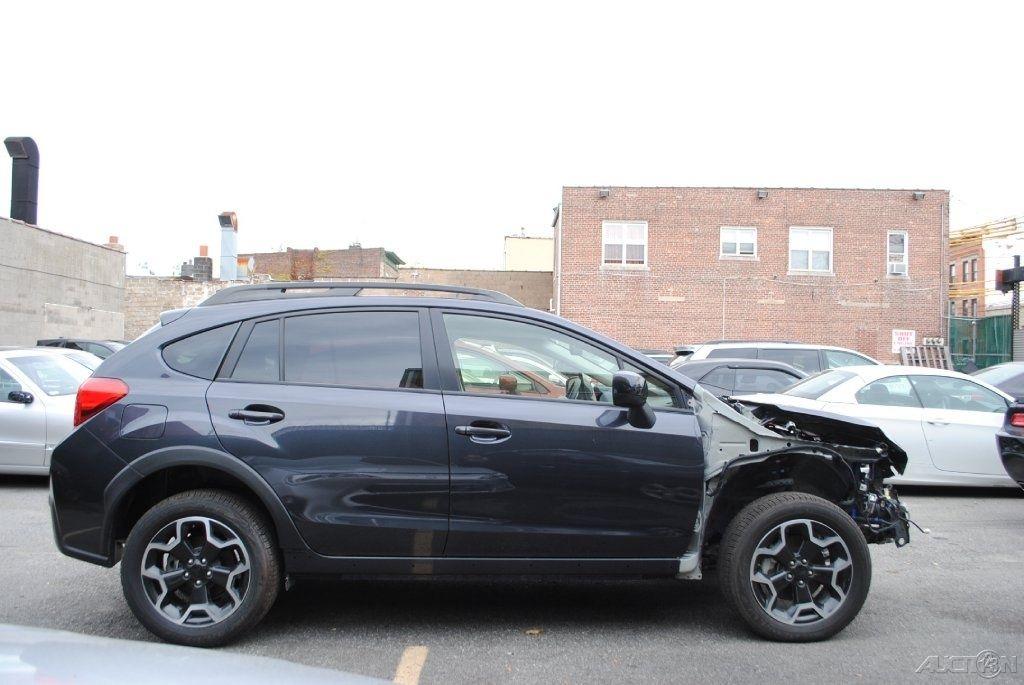

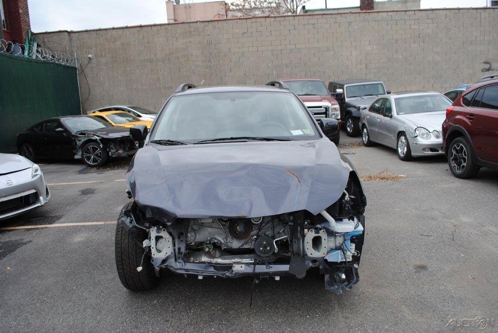

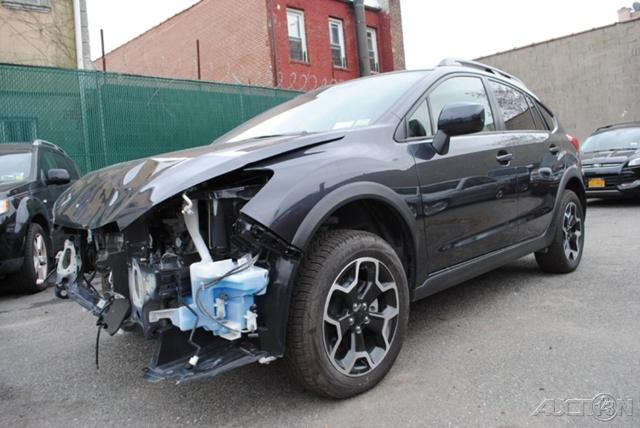

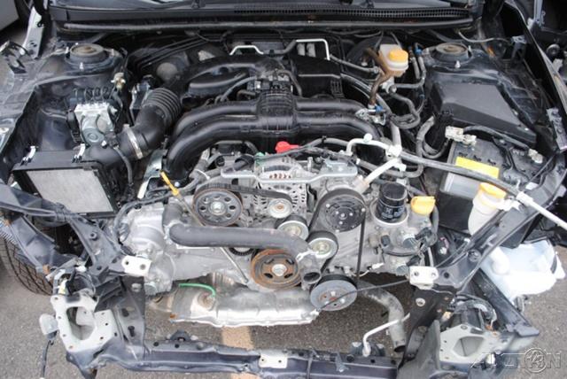

I am looking to purchase my first Subaru and there is someone selling a Crosstrek that has some front damage. The price seems to good to be true but the vehicle drives and there are no apparent engine issues outside it needing a new radiator.
For anyone that is experienced, based on the photos below what are some of the general parts that it needs. I want to price everything out to see if it is worth buying and fixing.
Thank you!

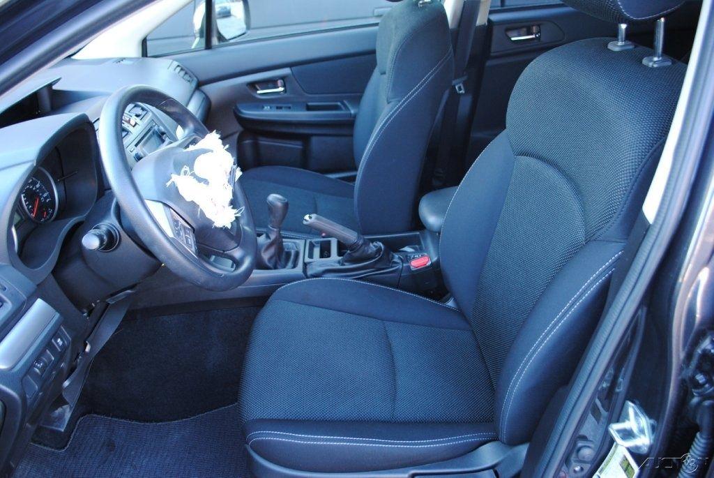

Looks like airbags cost about $800 so if only one bag blown, you have that. upper tie bar, hood headlights, bumper, radiator and other stuff not visible in the blurry pic..
It might be possible to find a T boned or rear ended 2012+ Impreza and use those parts since the parts are basically the same.
Pretty sure it's a 2013/2014?
