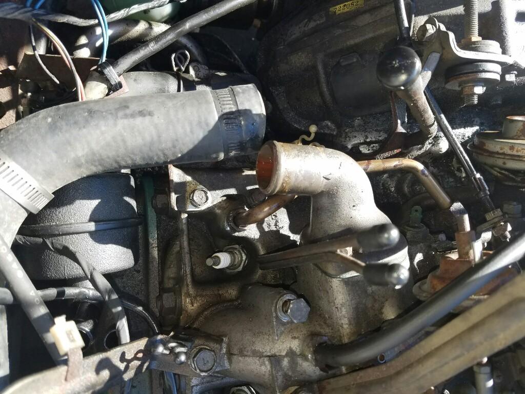

zmarrott Posted June 29, 2016 Share Posted June 29, 2016 (edited) Almost overheated the other day, and come to find out having fixed my coolant leak caused a head gasket to blow between coolant and oil. My car being from Connecticut is very rusty and can be difficult to remove parts without breaking them. As I'm stripping the engine, I'm currious what if any parts I can remove or bypass to clean it up a bit. My first issue I've come across with teardown is this little I think coolant line going from the intake to the right side head. I can't get it to turn. I soaked the nut in pb blaster last night with no apparent effect. Since the heads are i thought supposed to be interchangeable, I'm currious if I can just remove this entirely. Edited June 29, 2016 by zmarrott Link to comment Share on other sites More sharing options...
zmarrott Posted June 29, 2016 Author Share Posted June 29, 2016 (edited) Update: got the line off with a few whacks on a firm bite with vise grips. On teardown I just have to drop the exhaust and then the heads come off. Still would love to use this as a perfect opportunity to remove surplus hoses and such from the engine. I'm not worried about passing and inspection as I'm out of my home state, and as soon as I get back its getting vintage registration Edited June 29, 2016 by zmarrott 1 Link to comment Share on other sites More sharing options...

TomRhere Posted June 29, 2016 Share Posted June 29, 2016 That tube you argued with is for the EGR feed. Routes some exhaust gases to the EGR valve, EGR valve then adds it to the intake stream. Supposedly, it helps with exhaust emissions. Link to comment Share on other sites More sharing options...

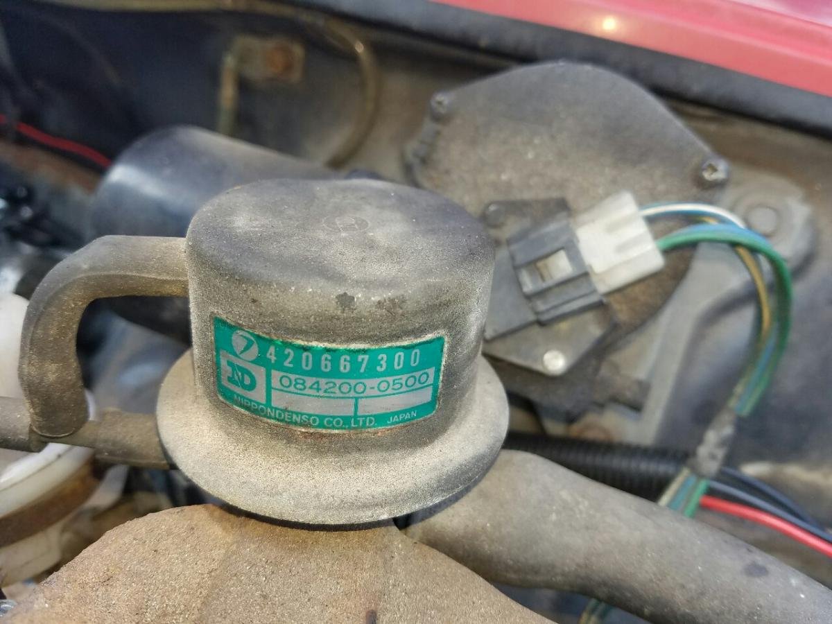

zmarrott Posted June 30, 2016 Author Share Posted June 30, 2016 I assume a nice fine grit, but what specifically would you recommend? Also, among the rusted bits included was the large vac line to the item in the included picture. What is it? Link to comment Share on other sites More sharing options...
TomRhere Posted June 30, 2016 Share Posted June 30, 2016 Looks like the Anti-After-burn Valve, (AAV), judging by angle of that pic. The part is mounted on the DS strut tower, large hose runs to back of intake to a metal tube, then a short section of hose to the EGR valve. All of which can be removed. The AAV can cause issues itself. And the short section of hose at the EGR likes to crack causing one heck of a vacuum leak. Link to comment Share on other sites More sharing options...
