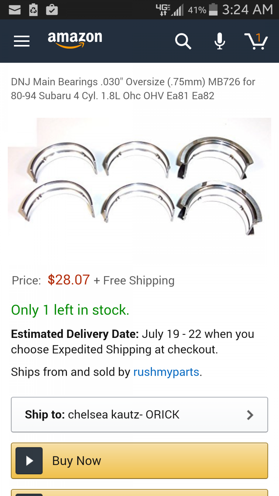

Norcalbratcap Posted July 15, 2016 Author Share Posted July 15, 2016 So these are about the only rod bearings im finding, will these be correct? Because it says oversize so im a little confused. Link to comment Share on other sites More sharing options...
987687 Posted July 15, 2016 Share Posted July 15, 2016 Oversized bearings are for a damaged crank... If the rod journals get chewed up and need to be machined down to achieve a nice shiny finish, oversized bearings are required. Until you take the engine apart you don't know the extent of damage and thus can't know which size bearings you're going to need. Link to comment Share on other sites More sharing options...
