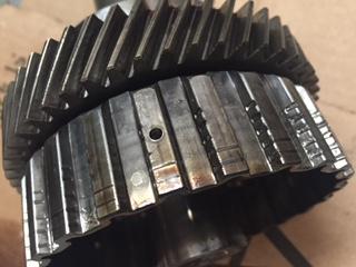

msmithmmx Posted July 15, 2016 Share Posted July 15, 2016 98 OBW 245K w/2.2 Hello all. I have been putting this off for 5 years and or 40K miles. My plan was to replace clutch pack and dutcy c seloniod. Take a look at this basket I think it is done. The grooves are so symmetrical though. Enjoy my misery but please comment if you think that is toast. Are there any good used ones out there? Link to comment Share on other sites More sharing options...
Caboobaroo Posted July 16, 2016 Share Posted July 16, 2016 If you have a cut off wheel, you can grind them down to make it smoother and put it back together. I've done it on a few with good results. Link to comment Share on other sites More sharing options...
msmithmmx Posted July 16, 2016 Author Share Posted July 16, 2016 Thanks for the reply. What about the notches on the side? Should those be there? They are way to deep to grind out. Link to comment Share on other sites More sharing options...
lmdew Posted July 17, 2016 Share Posted July 17, 2016 No notches on the one I have for you, Larry Link to comment Share on other sites More sharing options...
