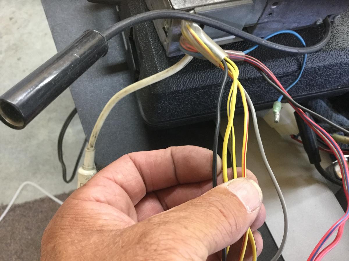

65stangy Posted July 19, 2016 Share Posted July 19, 2016 Okay, I am probably posting entirely too much as a subie newbie, but...so when I bought my brat, the original radio was behind the seat, and I had a gaping hole in my radio bezel from someone hacking an aftermarket stereo into it. The harness of course has been cut, as well as the wires on the back of the radio. Can anyone help me identify the wire colors that I need to re-connect to splice the factory am/fm back in now that I have a replacement radio bezel? I will attempt to post pictures of my radio. I think the round cord plug might be for an accessory cassette deck?? Thanks in advance Link to comment Share on other sites More sharing options...
DaveT Posted July 20, 2016 Share Posted July 20, 2016 To be sure, you need the year, and a FSM. I am most familiar with 86-93 wagons. I can guess a bit - the reds - one is likely power, the other lights. Black = GND Yellows = speakers Blue ? I've seen a single wire used for power antenna, or external amps, but the gender of the connector is wrong. Type of connector isn't what I've seen for that wire either. Link to comment Share on other sites More sharing options...

DaveT Posted July 20, 2016 Share Posted July 20, 2016 I'd test the radio first. All of my oem radios got flaky a long while ago. I used the radio's connector to make an adapter between the new aftermarket radio I installed and the existing car harness. Sometimes Subaru wire colors don't match between the harness and the radio or other device. Link to comment Share on other sites More sharing options...

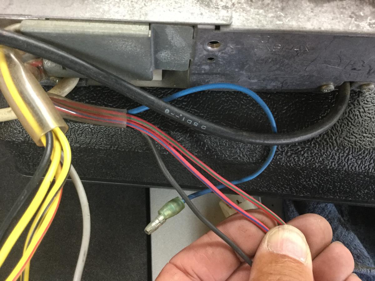

Bantum Posted July 20, 2016 Share Posted July 20, 2016 (edited) My take on colours : Black - Earth / Ground. Blue - 12v Constant. ( For internal clock ? should be connected with fuse inline to battery )Red / Blue - 12v Ignition ?Red / Green - 12v Accessories ?Grey - Powered Antenna ? ( not sure on this )Black - Earth for speakers.Yellow / Black / Red - L,R + Center channels ? White cord - would be a link for other components as you suggest ...Big round black thing is for antenna ... Would need the model number of radio to be 100% more accurate + you could look up the manual also ... Cheers, Bantum ... Edited July 20, 2016 by Bantum Link to comment Share on other sites More sharing options...
65stangy Posted July 20, 2016 Author Share Posted July 20, 2016 Thank you DaveT, and Bantum. I will see what I can trace out and verify. Both radios have the same blue wire with bullet connector, but one of them is fused, so your idea makes sense Bantum. I did attempt to get the radio to power up with 12 volts and a ground, and was not successful. My radio could be junk, but will keep playing. Link to comment Share on other sites More sharing options...
DaveT Posted July 20, 2016 Share Posted July 20, 2016 Typically, the speaker wires are in pairs. One wire for each speaker terminal. Speakers do not usually return via ground. No center channel on these old things. One of my wagons had 4 speakers - that one, the radio had 6 wires. Left return was shared, front and back had separate hots. Radio had built in fader for front to rear. Link to comment Share on other sites More sharing options...
DaveT Posted July 20, 2016 Share Posted July 20, 2016 Yes the older ones sometimes had odd stuff. The blue with the male single pin could be the always on memory power feed. Link to comment Share on other sites More sharing options...
65stangy Posted July 20, 2016 Author Share Posted July 20, 2016 ummm... so I can now get both radio's to power up by applying 12 volts through the blue wire. Certainly not what I was expecting. The radios are two different models, one is a Matsushita model 786201560 ref # CR-KF121A The other is the one that was with the car and is a Clarion model no. RF-4881 I will google both of those and see if I can get a schematic to pop up. Link to comment Share on other sites More sharing options...
65stangy Posted July 20, 2016 Author Share Posted July 20, 2016 I found a copied manual for the Matsushita on ebay...The schematic that popped up on the clarion RF-4881 did not seem to match the wires on my radio. I will keep looking, and might go ahead and order the copied manual. If I learn anything exciting I will post it on here. Link to comment Share on other sites More sharing options...

65stangy Posted November 5, 2016 Author Share Posted November 5, 2016 Yes, I got the radio functioning great after I received the manual for the radio that identified all wires. The blue wire is 12v ignition. I chose not to add the cassette deck because it did not have one originally. The only thing I never got to work was the illumination of the display, but I am thinking the bulb may be blown. I have had big issues getting pictures to upload on this site, but I could attempt to scan the radio manual for you if I had an email address to send it to. Not sure which radio you have, but the wire combos are pretty similar. 1 Link to comment Share on other sites More sharing options...
ducunee Posted November 6, 2016 Share Posted November 6, 2016 Thanks for responding. Have Clarion RF4881. Pretty much figured out the power connector from previous post. The speaker 6 pin connector has gray,yellow,black,yel/red,yel/blk. respond here or email to ducunee@gmail.com. Hack job of different Suby radio ran new wires to speakers. Link to comment Share on other sites More sharing options...
65stangy Posted November 6, 2016 Author Share Posted November 6, 2016 OK My radio is a different model, but it looks like the color combo's are the same, as it looks like you have the same 5 wires. Manual says: Black: Ground Yellow with black: Left rear speaker Yellow with red: Right front speaker Yellow: Front left speaker Gray: Right rear speaker I hope this helps. Link to comment Share on other sites More sharing options...
ducunee Posted December 22, 2016 Share Posted December 22, 2016 Got mine working. Connector to speakers original wiring. _________________ RF ___ ___ ___ RF LF ___ ___ LF ___________________ RF & LF are common Link to comment Share on other sites More sharing options...
