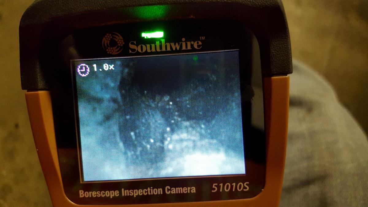

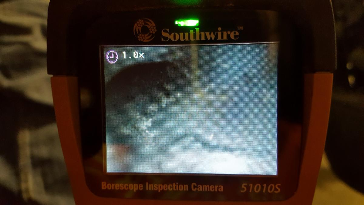

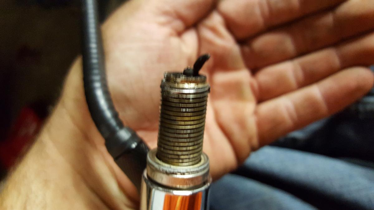

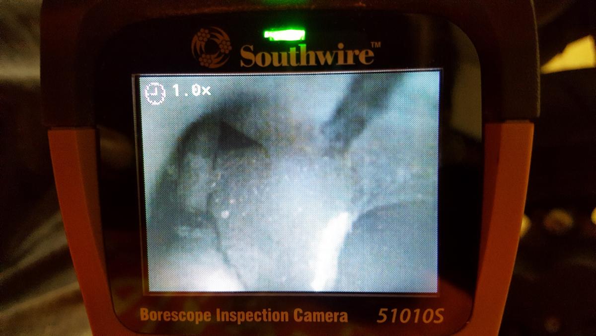

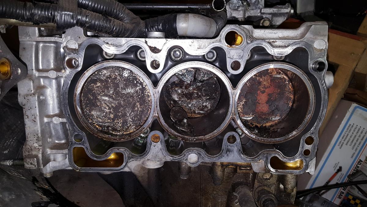

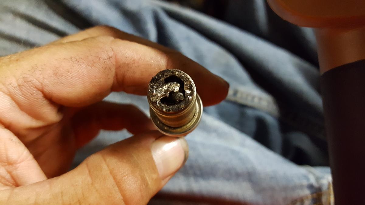

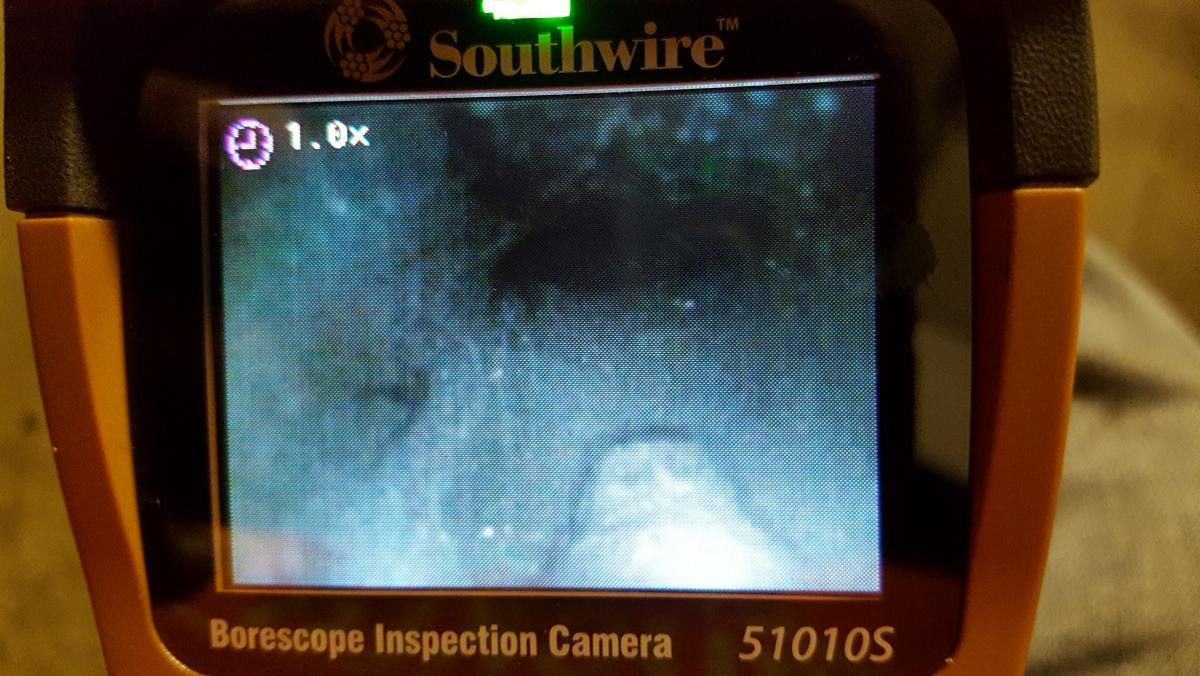

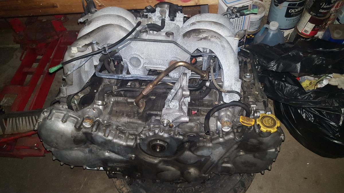

JoeSloppyJoe Posted July 27, 2016 Author Share Posted July 27, 2016 (edited) update while waiting for my friend to come over and look at the engine.. it doesn't look good.. i figured i might as well take a look at this $100 engine and see if there's cause for any concern... these are the spark plugs out of 2 and 3.. the exhaust valves were bent or gone on 2 and 3. 1 looked fine as well as 4 5 and 6 i know im a fool but i want to fix it.. Edited July 27, 2016 by JoeSloppyJoe Link to comment Share on other sites More sharing options...

matt167 Posted July 27, 2016 Share Posted July 27, 2016 RHD M/T parts are not hard to find.. JDM Importers probably trash lots of the assemblies since the USA is a LHD country, those parts are pretty worthless.. But your 6cyl is probably scrap metal at this point. Link to comment Share on other sites More sharing options...
1 Lucky Texan Posted July 27, 2016 Share Posted July 27, 2016 if the valve heads were banging around in there - probably need some pistons Link to comment Share on other sites More sharing options...

1 Lucky Texan Posted July 30, 2016 Share Posted July 30, 2016 (edited) if the engine jumped time because of chronic abuse, who knows how long the bottom end might last after you invest in the heads? It would suck to have rod-knock show up 3 weeks after getting it done. So you would really need a total rebuild to be confident. pistons, rings, rod and main bearings, etc. I had a similar catastrophic failure on a Honda decades ago. The cylinder walls need to be honed because, when the valve head impacts it, it makes a dent, but also raises a similar volume of metal - like the hole from a meteor with a rim around it. So, after you hone the cylinder down to remove the raised metal, you're left with small 'pits' and that means increased oil usage(but not 'horribly' increadsed). I dunno if the cylinder liners can be replaced...maybe someone here does. but yeah, i applaud your enthusiasm and wish i was as bold about stuff as you seem to be - and at least you're making the effort to discover what;' involved in the endeavor so, after you arm yourself with the knowledge and maybe get some assistance from the Forums and some experienced mechanics you have there local to you - you should be able to do fine. Whether it all comes together on a limited budget - only time will tell. Edited July 30, 2016 by 1 Lucky Texan Link to comment Share on other sites More sharing options...
