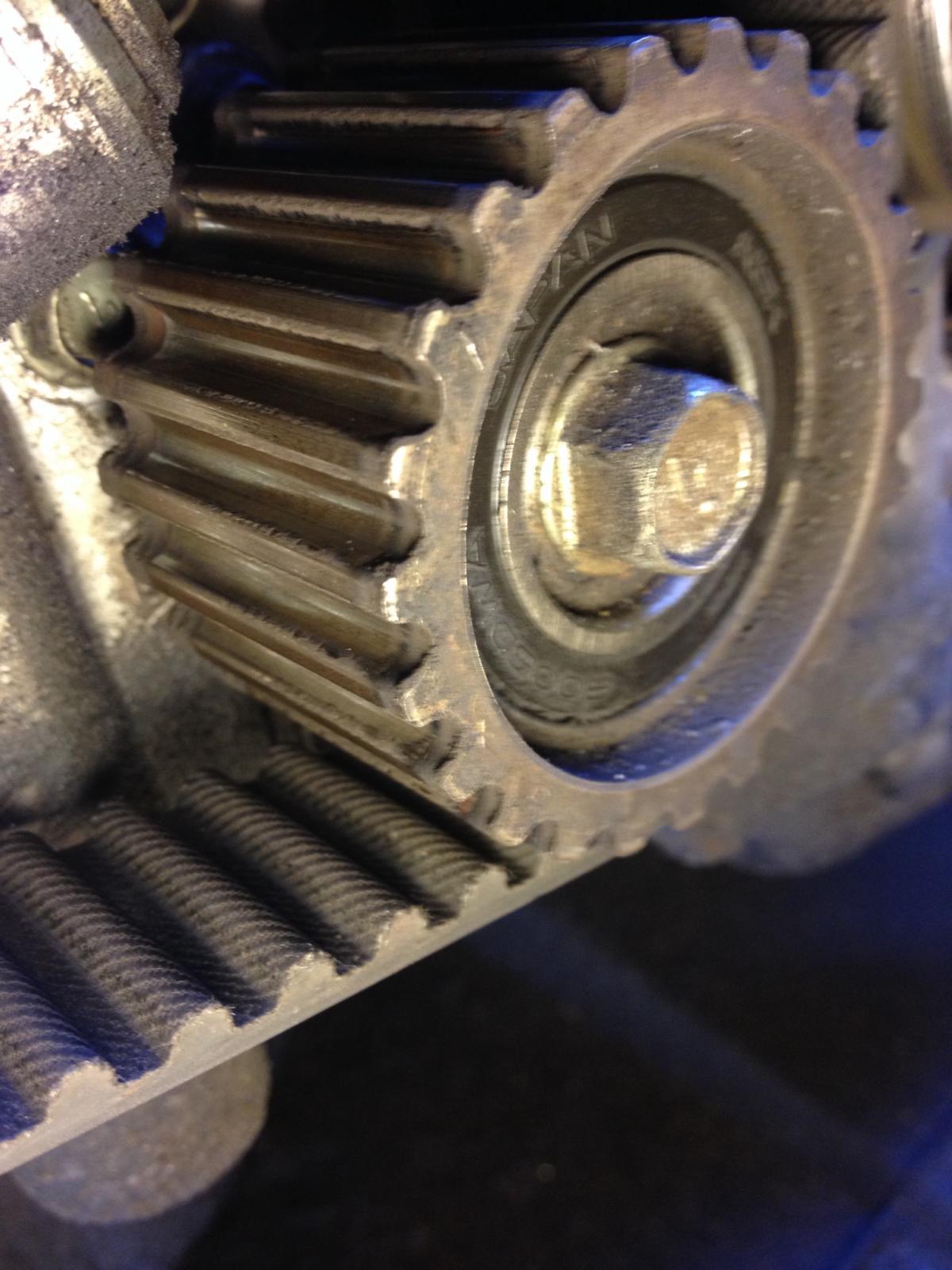

1 Lucky Texan Posted July 22, 2016 Share Posted July 22, 2016 does that system have a toothed idler? is it in good shape? sometimes things fail - maybe the tensioner is now bad or maybe a mount bolt has cracked???? have you done a tooth count? Link to comment Share on other sites More sharing options...
Danno-swMI Posted July 22, 2016 Author Share Posted July 22, 2016 (edited) does that system have a toothed idler? is it in good shape? sometimes things fail - maybe the tensioner is now bad or maybe a mount bolt has cracked???? have you done a tooth count? Not yet. Toothed idler next to waterpump seems to have some wear to it. Edited July 22, 2016 by Danno-swMI Link to comment Share on other sites More sharing options...
1 Lucky Texan Posted July 22, 2016 Share Posted July 22, 2016 seal looks cracked, but I was more concerned it may be very wobbly or even off-center. It's bearing was the worst one when I did my WRX TB - and there are on-line pics and experiences posted that indicate it is a real weak-spot. well, on the 2.5 DOHC anyway. anyway, hope you get it sorted-out. Link to comment Share on other sites More sharing options...
Danno-swMI Posted July 22, 2016 Author Share Posted July 22, 2016 seal looks cracked, but I was more concerned it may be very wobbly or even off-center. It's bearing was the worst one when I did my WRX TB - and there are on-line pics and experiences posted that indicate it is a real weak-spot. well, on the 2.5 DOHC anyway. anyway, hope you get it sorted-out. Looks like time for a TB, idlers AND tensioner Link to comment Share on other sites More sharing options...
subnz Posted July 22, 2016 Share Posted July 22, 2016 (edited) Never reuse old tensioner / idler pulleys is not worth the risk for the small replacement cost of these components. These are the things that fail 1st destroying the belt. / motor if interference Made the mistake of reusing toothed idler once ( even after subaru agents pressed in a new bearing into it for me) it seized stripping the new belt - 1 year and 7500 miles later. Thank goodness it was on an old EA82 (non interference motor) You learn from making mistakes like this. - perhaps bearing wrong type - damaged being pressed in. Edited July 23, 2016 by subnz 1 Link to comment Share on other sites More sharing options...

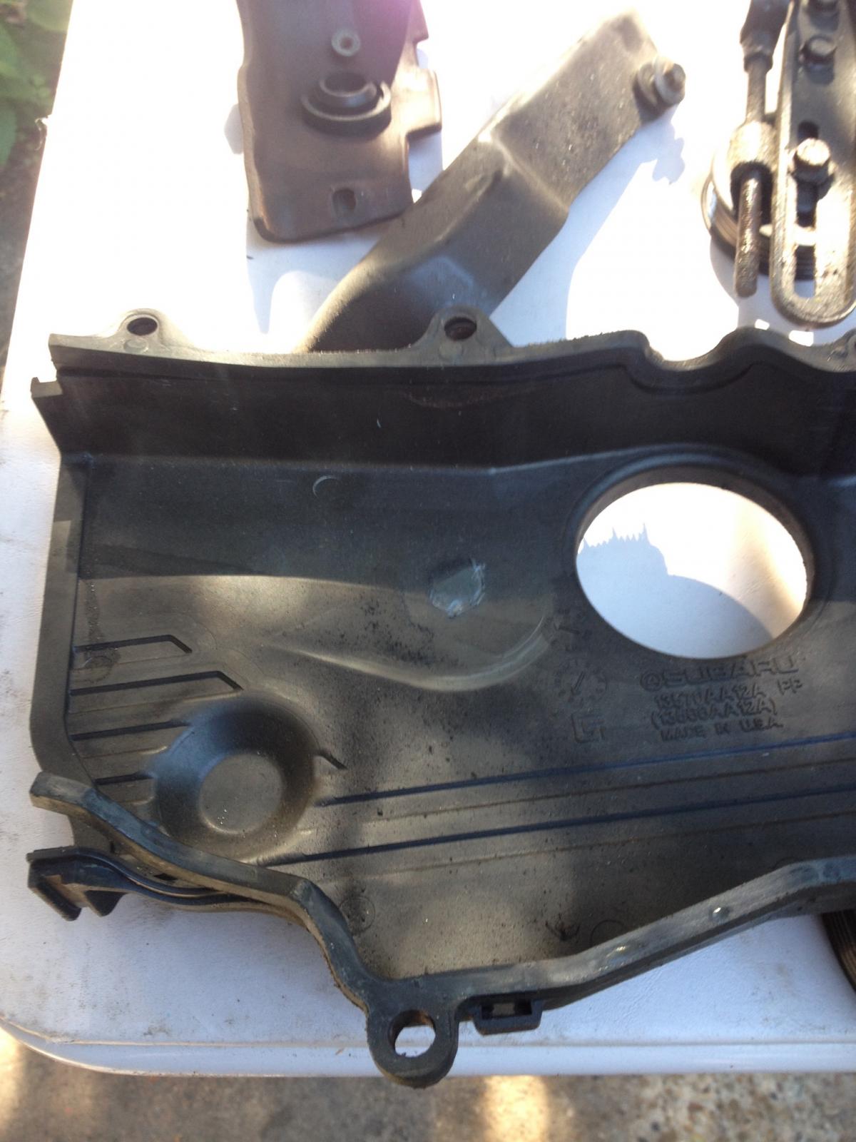

Danno-swMI Posted July 23, 2016 Author Share Posted July 23, 2016 And more is revealed by the light of a new day... Looks like the tensioner is hitting the cover. Link to comment Share on other sites More sharing options...
heartless Posted July 24, 2016 Share Posted July 24, 2016 (edited) tensioner, and the belt - not a good sign at all. I am going to bet the threads for the tensioner mounting bolt are damaged/stripped... time for a new bracket, just like I had to do with my 02 Forester.. https://www.amazon.com/OEM-Subaru-tensioner-Bracket-13156AA052/dp/B00F57PVFW (edit - you will want 2 longer bolts for the upper mount for that bracket - they made the mounting ears thicker - i believe they are M10 - need 60mm long, 1.25 thread pitch) as well as a new tensioner... in fact, I would go so far as to get a whole new timing kit - pulleys, tensioner, waterpump, etc - and be done with it for a while Edited July 24, 2016 by heartless Link to comment Share on other sites More sharing options...
