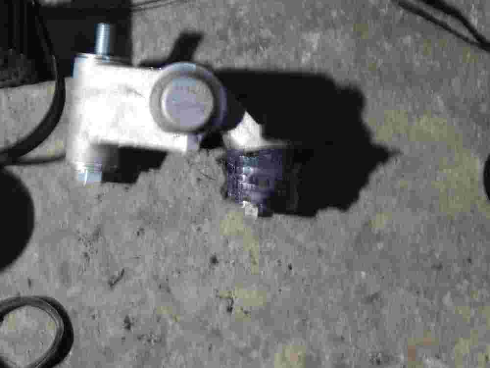

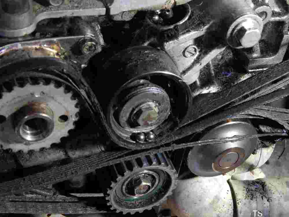

montana tom Posted August 17, 2016 Share Posted August 17, 2016 Recently I installed a timing belt and component kit on a 2006 obw. Simple job , went well.... Ordered parts from local parts house... first mistake.. should have gone to subaru. Parts that were sold to me were dayco ,(american made right ??) they looked good ,nothing on the box about being made in china.... new belt ,new tensioner ,new idlers. Cars owner was out of town for a few weeks, so her husband picked up the car and brought it home. 2 weeks later on a friday night I get a call , 50 miles down the road and her car looses power coasts to the side and now is cranking over "fast" ...classic broken belt. I told them to have it towed in and i would see what had happened. That night,I am going over in my head ,is there any way i forgot to tighten something ?? I've installed over 100 of these so I doubt it but.... maybe i was distracted. Sunday morning instead of relaxing, I'm at the shop popping the covers off to see what went wrong. As soon as i had the main cover off it was very apparent, the roller on the brand new tensioner self destructed in 50 miles !!! destroyed everything. what was left of the belt was melted to the remains of the roller, the other idlers and the water pump all had multi colored rollers from getting to hot. After talking to the parts house about warranty repair (yes they will cover it ) I removed the heads and yup bent all 32 valves . So now heads are off getting resurfaced and new valves and seals. My customer has several vehicles so she is not stranded and her car will be good as new when she gets it back .. even gets new head gaskets. I however had to bump scheduled cars out to fit her in . I wasn't allowed to replace the valves,parts house had to do it at their shop. I'm waiting however long till they send them back. They will pay my time but at the warranty rate (A real ripoff). While the steam was slowly venting out my ears I called over to the subaru stuff shop in Idaho, told them what had happened. They informed me that not only were dayco parts being made in china but GATES was as well ! I was shocked I have recommended gates kits to many people and installed more of them than subaru parts. They said gates had been good for years but recently started manufacturing in china!!! They will now only install original subaru or koyo (Japanese made) timing parts. I guess from this point on despite the extra cost that is all I will install as well . Link to comment Share on other sites More sharing options...

Fairtax4me Posted August 18, 2016 Share Posted August 18, 2016 Just bought a gates kit for my 96 a few weeks ago. Good deal on amazon. Idlers were NSK and Koyo. Those are OE parts. Tensioner was GMB. Not the greatest quality but they work well enough for a 60k interval. Belt was a Gates belt, problem with the belt. It was too short. Too much tension on the belt when the tensioner was slid over. It actually kept the tensioner position from pushing out at all. I've had this happen before years ago, but it was with a much cheaper PCI kit. Didn't expect this from a Gates belt. I always use gates V and serpentine belts if I can. Dayco I dont expect great quality from. I've used their timing kits before and haven't ever really been impressed. Serpentine belts don't last long, and their small ribbed belts tend to stretch quite a lot before they stop squealing. Link to comment Share on other sites More sharing options...

LeolaPA Posted August 20, 2016 Share Posted August 20, 2016 (edited) Seems like for this to happen, that roller was locked somehow from the very beginning. Anyway, I did my first belt this year, and got a kit from a guy on Ebay sixstarparts, for about $265. Was all the original parts except the belt was Mitsuboshi. I think the pump was not subaru, but a very high quality unit call Paraut. Edited August 20, 2016 by LeolaPA Link to comment Share on other sites More sharing options...
