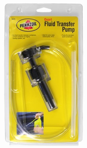

1 Lucky Texan Posted September 6, 2016 Share Posted September 6, 2016 (edited) ^^ what he said. If you're curious about whether you have LSD in the rear; chock front wheels, put car in N, lift the rear of the car, spin a rear wheel - if the other rear wheel moves in the same direction, you have LSD. when changing the fluid, remove the fill plug first, drain plug second. Clean the sludge from the magnet - there should be no large particles. I had to use a floor jack on the handle of a 1/2" breaker bar to loosen the plugs. filling is easier with something like this; Edited September 6, 2016 by 1 Lucky Texan Link to comment Share on other sites More sharing options...
