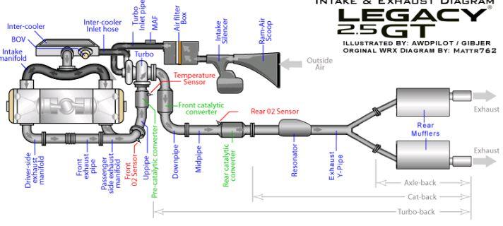

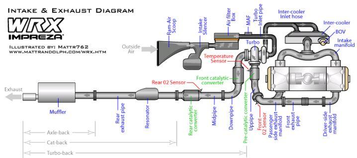

matt167 Posted September 8, 2016 Share Posted September 8, 2016 Yes, the turbocharged version is something called a downpipe. It connects to the turbo. Parts stores do not carry them. You need to go dealer, or full aftermarket. Link to comment Share on other sites More sharing options...

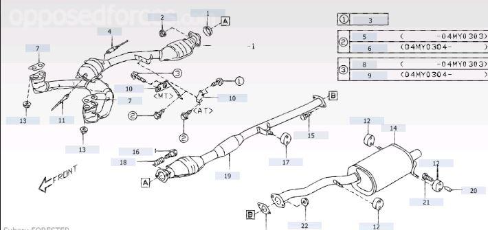

wtdash Posted September 9, 2016 Share Posted September 9, 2016 (edited) Buy used on CL...maybe all the NE cars are rusted out? Or look on Ebay for cheap(er) replacements. See attached. Applies to most of the pre 2014 (?) Subarus. NA / Non-turbo for most Subaurs ( '05-'10? had dual - exhaust). Legacy GT Turbo - '05 + /'08+ WRX WRX '02-'07 Edited September 9, 2016 by wtdash Link to comment Share on other sites More sharing options...
