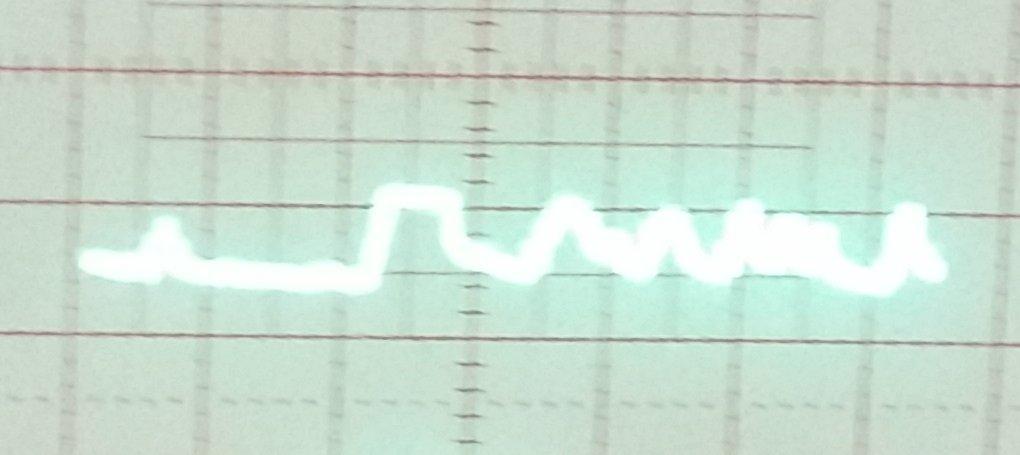

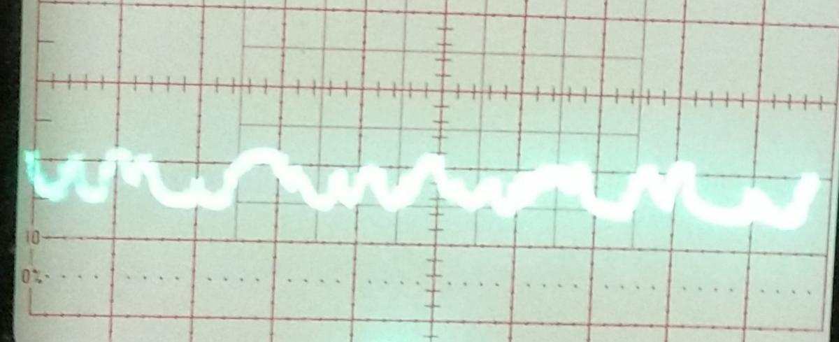

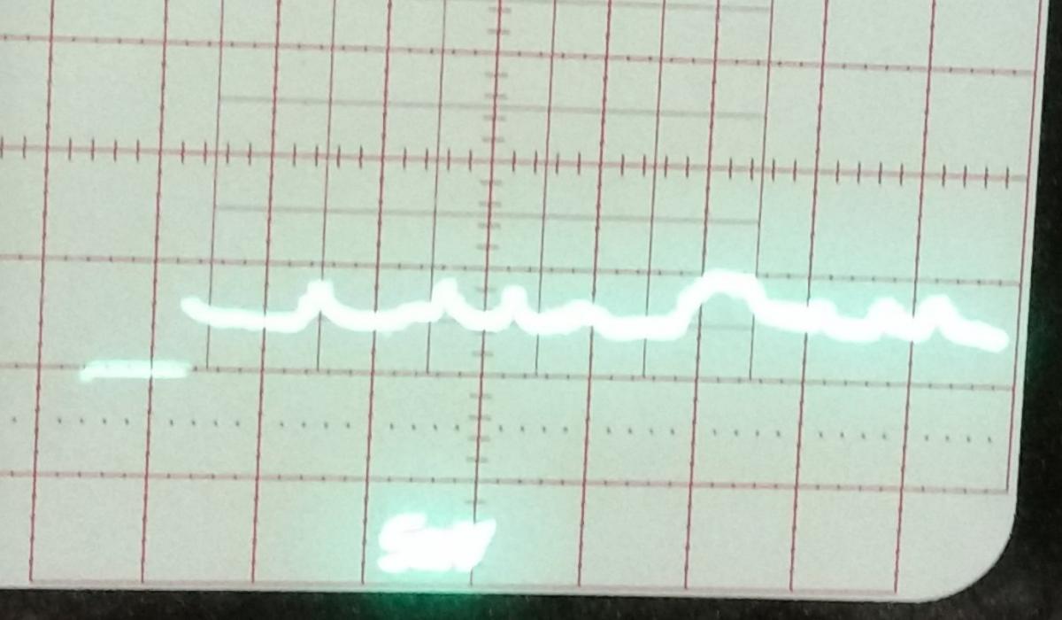

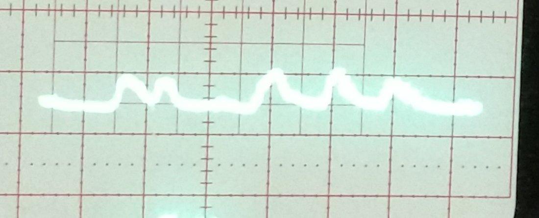

DaveT Posted October 30, 2016 Author Share Posted October 30, 2016 After a bit of delay, I had a chance to hook up my oscilloscope to the O2 sensor. These were taken after warmed up. 2 seconds per division Horiz, 0.5V per division Vert. Checked that the exhaust system is grounded well beforehand. The first one has the short flat line [far left] showing the zero V reference position. Link to comment Share on other sites More sharing options...

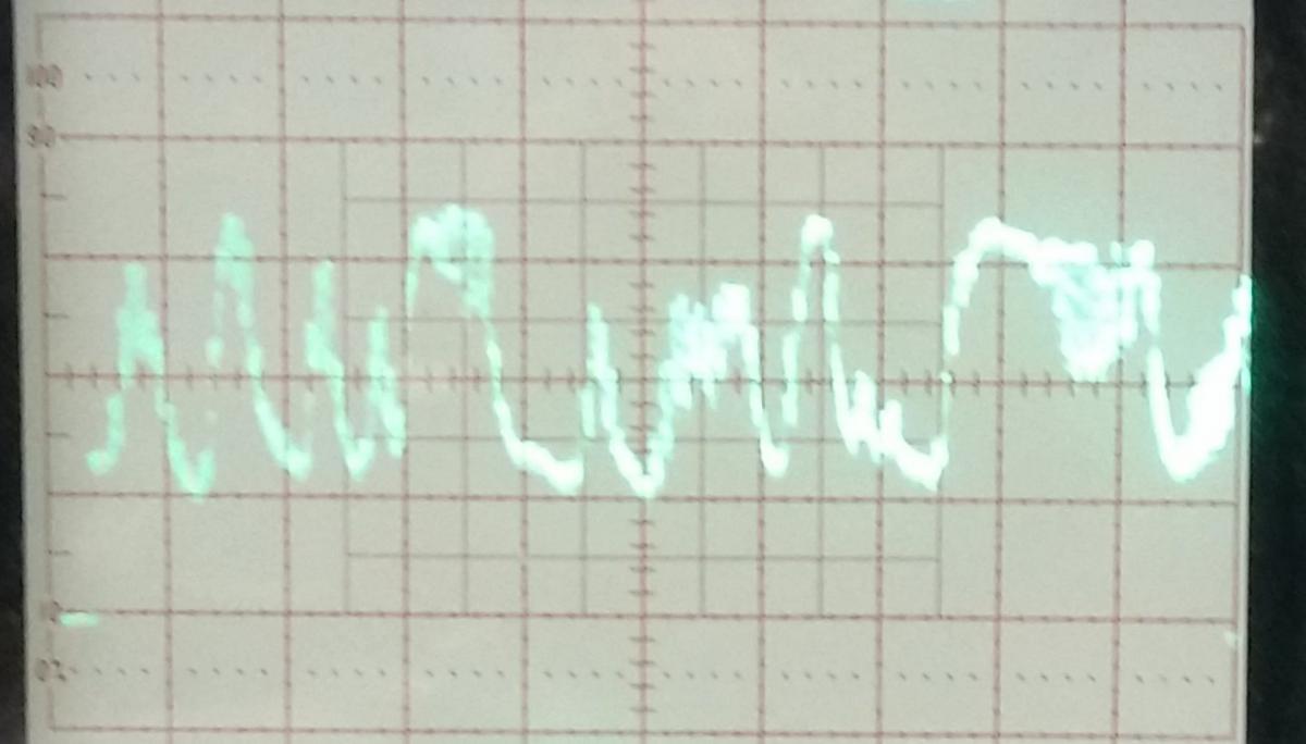

naru Posted October 30, 2016 Share Posted October 30, 2016 The voltage varations look too small. It barely ever makes it to the rich side of 0.45 volts.(if I`m reading voltage correctly). You should see up to .8 -.9 volts on upward swings. Any lower and the catylast will not stay hot enough to be fully active. How does the waveform compare w/the one from your other emission passing car? How does the O2 sensor voltage/waveform react to propane enrichment? To a sudden vacuum leak? To blipping the throttle? Here are some typical waveforms http://www.autolabscopediagnostics.com/sensors2.html Might just be a bad sensor. Link to comment Share on other sites More sharing options...
DaveT Posted November 1, 2016 Author Share Posted November 1, 2016 Above is a trace from my 87 Above is a trace from my 93 I also let air in via the feed to the HVAC controls storage tank. The effect was that the trace drops to the low level, following the curves similar to the drops in the normal traces above. After a bit, the trace would begin to move up again, looking like the ECU started compensating.Similar happened in reverse when I injected propane. For that, I added a T into where the feed hose picks off for the IAC valve. Capped when not using. Dialing the propane on / off would do what you would expect. Propane makes the trace go high, then after a bit, the ECU starts to compensate. Turning off, trace drops to the low level.I considered putting a new O2 sensor in the 93 - until I noticed that I will have to remove the heat shields to get a wrench on it. Also, adding that this O2 sensor [and exhaust] passed the test 2 years ago,and has not been on the car since. Although, the test 2 years ago didn't have the idle test.... But then there is the similarity of the 2 cars. Note - the 87 happened to level off by the time I took the picture. I revved it for a bit, and it began cycling again. The 87 is the "reference" car, it had its final test a few years ago. Link to comment Share on other sites More sharing options...
