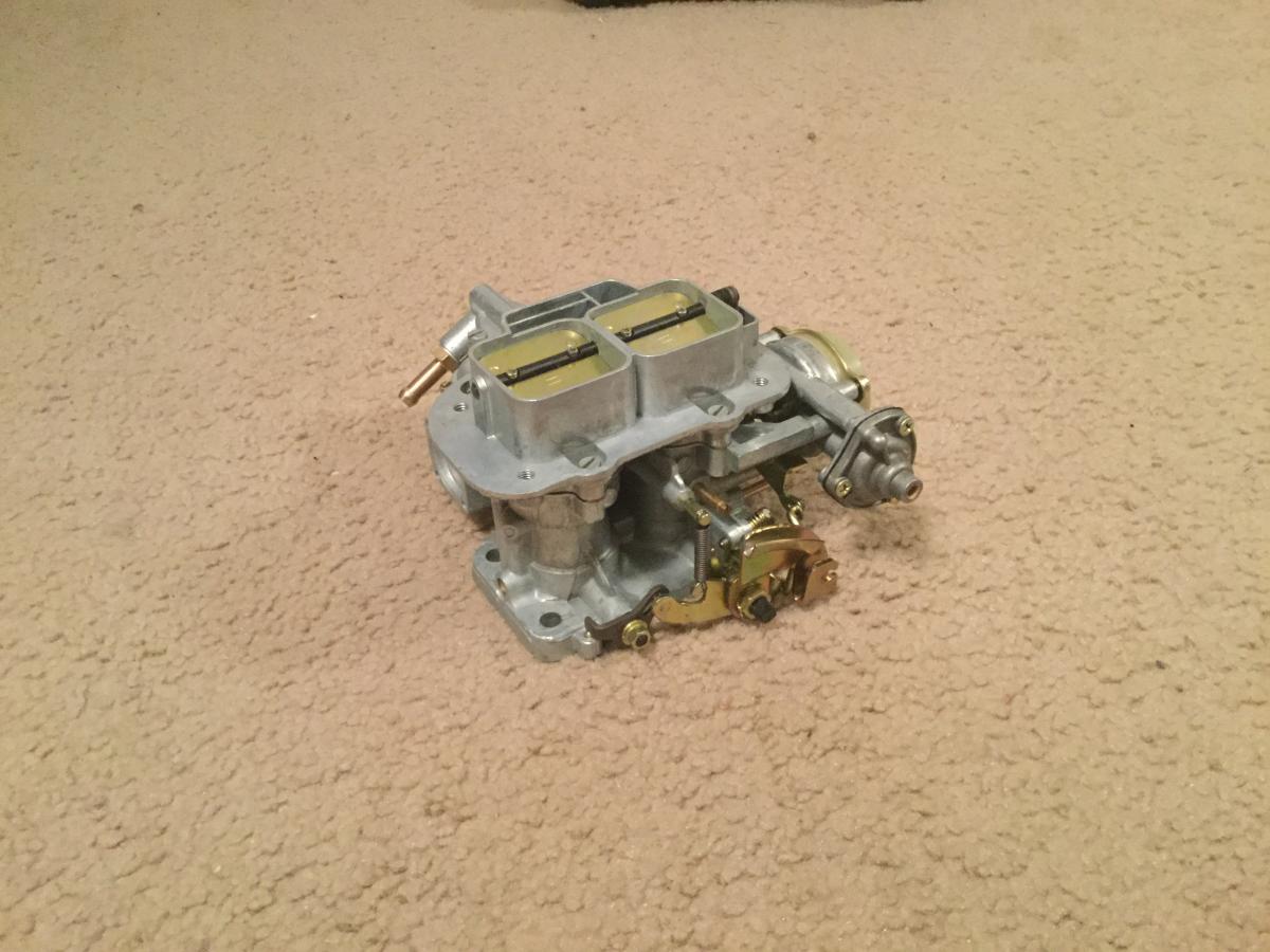

Sapper 157 Posted November 17, 2016 Author Share Posted November 17, 2016 It's finally here! Link to comment Share on other sites More sharing options...
Loyale 2.7 Turbo Posted November 17, 2016 Share Posted November 17, 2016 On 11/17/2016 at 2:30 AM, Sapper 157 said: It's finally here! Awesome! Update this thread as the retrofitting goes. Kind Regards. 1 Link to comment Share on other sites More sharing options...
Sapper 157 Posted November 21, 2016 Author Share Posted November 21, 2016 Quick question to Jeszek or anyone else with an answer... is it normal for a Weber kit to come without the fuel cutoff solenoid or the throttle cable bracket? My new carb has neither... Link to comment Share on other sites More sharing options...
Loyale 2.7 Turbo Posted November 21, 2016 Share Posted November 21, 2016 ► The fuel cutoff Solenoid doesn't come in Standard Webers. ....It is an "Extra" that you could ask and / or obtain later, because it is easy to add on. ► The accelerator cable Bracket, should come with the Kit. (if you purchased it as a Kit) ....So, ask to the one who sold the Kit to you, he might simply Forgot to put it in the Bundle. Kind Regards. 1 Link to comment Share on other sites More sharing options...

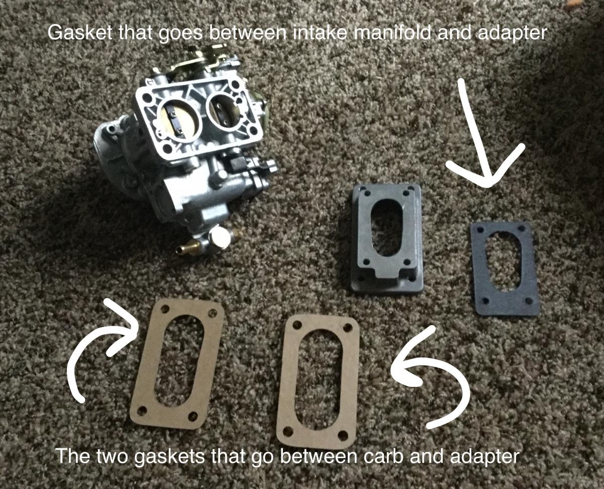

Sapper 157 Posted December 14, 2016 Author Share Posted December 14, 2016 (edited) Update: I'm home for the winter break and will be starting the conversion tomorrow. Quick question for Jeszek or anyone who can answer.... I saw in your conversation that you need two gaskets for the two piece ea82 adapter. I have two gaskets in the kit that came with my car that are supposed to go between the single piece adapter and the carb... do I use both of them sandwiched together? (So the installation order would be adapter, gasket, gasket, then carb?) Or is one of them just an extra and I only need one gasket? I know you said you needed two for the two piece adapter but I couldn't find a clear answer for the single piece adapter. Edited December 14, 2016 by Sapper 157 Link to comment Share on other sites More sharing options...
Carmen Posted December 14, 2016 Share Posted December 14, 2016 one gasket goes between intake and adapter, the other gasket goes between adapter and carb. Link to comment Share on other sites More sharing options...
Sapper 157 Posted December 14, 2016 Author Share Posted December 14, 2016 (edited) On 12/14/2016 at 7:28 AM, Carmen said: one gasket goes between intake and adapter, the other gasket goes between adapter and carb. Okay so if I only use one, then why was I given two? It appears almost as if the gaskets are slightly different shapes. Could it be that one gasket is for a different type of intake manifold? Here is a picture illustrating my dilemma I guess I'll just use one gasket between the card and the adapter, but do you think it matters which one of the two brown gaskets that I use? Edited December 14, 2016 by Sapper 157 Link to comment Share on other sites More sharing options...
87subbomber Posted December 14, 2016 Share Posted December 14, 2016 I see your confusion so i will help you out. is it a two piece adapter or one piece? if its a two piece th order goes like this. the one on the right of the picture we will call the "hitachi" gasket. the two identical gaskets on the left we will call the "weber" gasket. the one on the far right goes between the adpater and intake manifold fitting the hitachi carb shape. so it goes "hitachi" gasket, adapter plate, then "weber" gasket, the weber plate, "weber" gasket, then carb. Link to comment Share on other sites More sharing options...
Sapper 157 Posted December 14, 2016 Author Share Posted December 14, 2016 (edited) On 12/14/2016 at 5:57 PM, 87subbomber said: I see your confusion so i will help you out. is it a two piece adapter or one piece? if its a two piece th order goes like this. the one on the right of the picture we will call the "hitachi" gasket. the two identical gaskets on the left we will call the "weber" gasket. the one on the far right goes between the adpater and intake manifold fitting the hitachi carb shape. so it goes "hitachi" gasket, adapter plate, then "weber" gasket, the weber plate, "weber" gasket, then carb. Okay thank you. I know the purpose of the Hitachi gasket, I'm just trying to figure out why I have two Weber gaskets. I have an EA81 single piece adapter, so I guess I just use one gasket between the carb and adapter, and the other one was thrown in just in case I had a two piece adapter Edited December 14, 2016 by Sapper 157 Link to comment Share on other sites More sharing options...

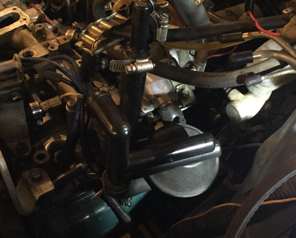

Sapper 157 Posted December 15, 2016 Author Share Posted December 15, 2016 Quick question... i'm going to try to keep my ASV system for the noise reduction advantages. All that I need to do in order to keep the system is drill two new 5/8" holes in the new Weber airbox, then attach them via two 90 degree elbows, correct? Link to comment Share on other sites More sharing options...
Sapper 157 Posted December 15, 2016 Author Share Posted December 15, 2016 And just so we're clear, when I say ASV, I am referring to these two black silencers that are attached to the exhaust system... Link to comment Share on other sites More sharing options...
87subbomber Posted December 15, 2016 Share Posted December 15, 2016 Jezek says to ditch the A.S.V. im ditching both the asv and egr. way simpler and cleaner. Link to comment Share on other sites More sharing options...
Sapper 157 Posted December 16, 2016 Author Share Posted December 16, 2016 (edited) On 12/15/2016 at 11:07 PM, 87subbomber said: Jezek says to ditch the A.S.V. im ditching both the asv and egr. way simpler and cleaner.I guess I should ask more questions... I read this in his conversation thread: ► The A.S.V. System needs to be Removed, so the rest of the Openings on the Exhaust, shall be Closed, otherwise your engine bay will become Noisy from exhaust... The main reason I don't want to get rid of it is because I assume it will make the car louder, however, the quote above makes me think I don't fully understand the ASV removal. So does that mean that if I remove the large metal tubes that are attached to the heads and plug them, then the car will be just as quiet as before? Edited December 16, 2016 by Sapper 157 Link to comment Share on other sites More sharing options...

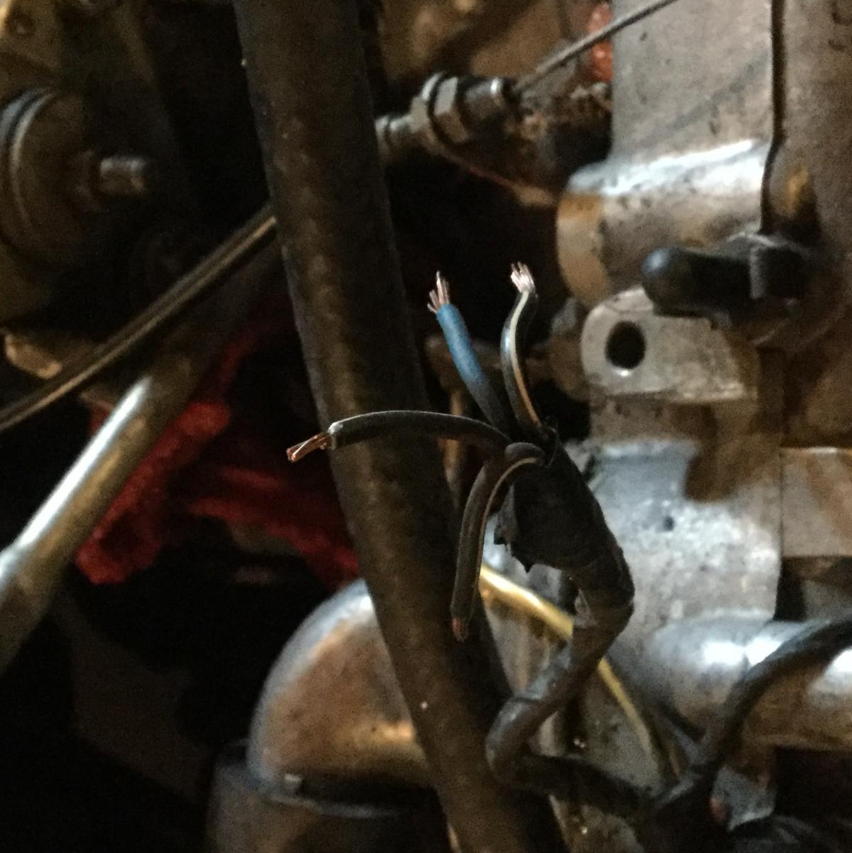

Sapper 157 Posted December 16, 2016 Author Share Posted December 16, 2016 (edited) Pardon my ignorance, but where exactly is this "12V ignition source" for the electric choke and fuel cutoff solenoid? Edit: I think I have found a suitable source for the choke... I'm using the cluster of wires that used to power the Hitachi. the wire in the center of the cluster has 12V going to it when the the key is in the on position. For some reason the other wires have no power going to them. Edited December 16, 2016 by Sapper 157 Link to comment Share on other sites More sharing options...
Loyale 2.7 Turbo Posted December 16, 2016 Share Posted December 16, 2016 Sorry for not answering directly, I lost my internet / cable TV connection @ home, so I had to ask by phone a friend (carmen) to check this thread and answer for me; but the questions are more now, and I am on a Cybercafé's computer, at the shoppin' mall. ► Your kit always provide two gaskets for the Weber, because you might need a replacement in the Future, Or you will install the Phenolic temp isolant between both gaskets; as explained with a photo, on my Writeup. ► Yes, closing the ASV will make it Quiet; but the main noise source, will be the Weber's throat under deep acceleration; if you want it Quiet as before, use the stock air filter Box and element. ► 12V controlled by the ignition, is a power source that turns on / off with the Key. I hope this will clear your questions. Kind Regards. 1 Link to comment Share on other sites More sharing options...
