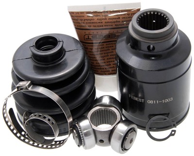

by looking at your picture I can say what I saw. It was the rubber housing which stayed on the transmission and the whole rod was out. This has never been rebuild or repaired before. The new one they installed was a bit different than the original one and I wonder if this could be related to my other issue with MPG. I wen from 30mph to 21mph then (after the breaks job) it went up to 23mph.

that 'tripod' portion is held onto the end of the shaft with a snap ring - something else that 'could' have been left off by a worker rebuilding and axle.
snap ring on the right, leaning on the inner 'cup';
I think it would take a HUGE amount of force to shear it off.
that axle could be a rebuilt put on by a previous owner - or a collision center if the car was ever in a wreck on that corner.

I'm suggesting that, it's possible the failure you saw was not 'caused' by the mechanic but was he was 'set-up' to experience that failure due to an improperly rebuilt axle having been put on the car at some time in the past.
it's only a possibility. Typcal rebuilt axles, while used commonly and fairly inexpensive, have notoriously poor lifespans and are assembled with little care.
