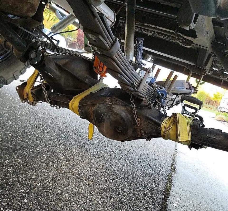

Uberoo Posted October 11, 2016 Share Posted October 11, 2016 find a skidplate or make one-its easy to to tag a rock without even noticing it. As far as the knuckle breaking,become one with your inner redneck,ducttape,ratchet straps,pieces of wood,etc have been used to limp vehicles off the trail before. 1 Link to comment Share on other sites More sharing options...
Norcalbratcap Posted October 11, 2016 Share Posted October 11, 2016 ^ yeah, like this fella Link to comment Share on other sites More sharing options...
