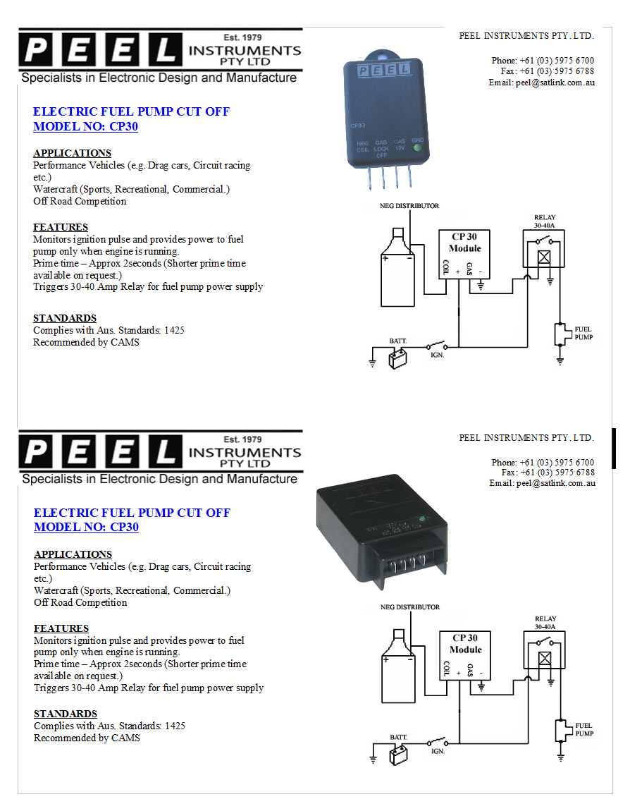

Bratmobile Posted October 21, 2016 Share Posted October 21, 2016 Searching a Subaru users group in Australia, I came across the following "fix" replacement part that they use on the "Brumby: Here's a link to the site: http://www.peelinstruments.com.au/index.html & here are the details of the part: CP30 Safety Switch This device is designed to turn off power to the Gas System when the engine stalls/turns off. The unit senses a Coil/Tacho pulse to provide power to the Gas System. Unit is capable of supplying an output of up to 12 amps. Unit is capable of picking up a faint pulse. Wiring- GND/NEG - Ground/Earth GAS+POS12V – Input 12 Volt power from Gas side of switch Lock Off+Pos Gas – Output 12V power to Gas Lock Off. NEG COIL - TachometricOutput Pulse/ Neg. Side of Coil. Any advice is much appreciated!~ Bratmobile Link to comment Share on other sites More sharing options...
naru Posted October 21, 2016 Share Posted October 21, 2016 Looks good to me. Link to comment Share on other sites More sharing options...
ihscout54 Posted October 23, 2016 Share Posted October 23, 2016 If you wanted to save some money look into these. They might even be available locally. http://www.ebay.com/itm/370504311314?_trksid=p2055119.m1438.l2649&ssPageName=STRK%3AMEBIDX%3AIT http://www.ebay.com/itm/272295635804?_trksid=p2057872.m2749.l2649&ssPageName=STRK%3AMEBIDX%3AIT Subaru wasnt the only one to use such gizmos. I have diagrams for both and have used the VW unit. I have a volvo relay waiting in a box for experimentation, just havent needed it yet. I recomend wiring in a secondary relay to handle the pump, I have found that aftermarket universal pumps like to cook the transisors in the FPCU. Not sure why, they usually have an even lower amp draw than the factory pumps. Link to comment Share on other sites More sharing options...
Gloyale Posted August 27, 2017 Share Posted August 27, 2017 also a GM oil pressure sending unit with 3 pins can be used. 1 pin operates the stock "oil" light the other pins are a pass through switch that closes when oil pressure present. run the Fuel pump + through that switch. might require adapter and or "T" fitting to install on an EA81. But works well on EA82 oil pumps in the upper, smaller port where the factory oil light switch would go. Link to comment Share on other sites More sharing options...
skishop69 Posted August 27, 2017 Share Posted August 27, 2017 +1 to both G & Scout. Both ways will net you what you want. G's is easier to install, but Scout's is a more 'direct' replacement four the FPCU. Depends on your needs and skills. Link to comment Share on other sites More sharing options...
wagons Posted August 28, 2017 Share Posted August 28, 2017 I am buying a revolution electronics fuel pump control unit. $70 and its definitely safer. Ran one in an old kit car. Has a relay for pump, shuts off when coil shuts off. Also can be used with a ford inertia switch so it kills fuel if involved in an accident that doesn't kill the engine. Pricey yes, but a neck of a lot better than fuel dumping everywhere and being a fire cause Link to comment Share on other sites More sharing options...
