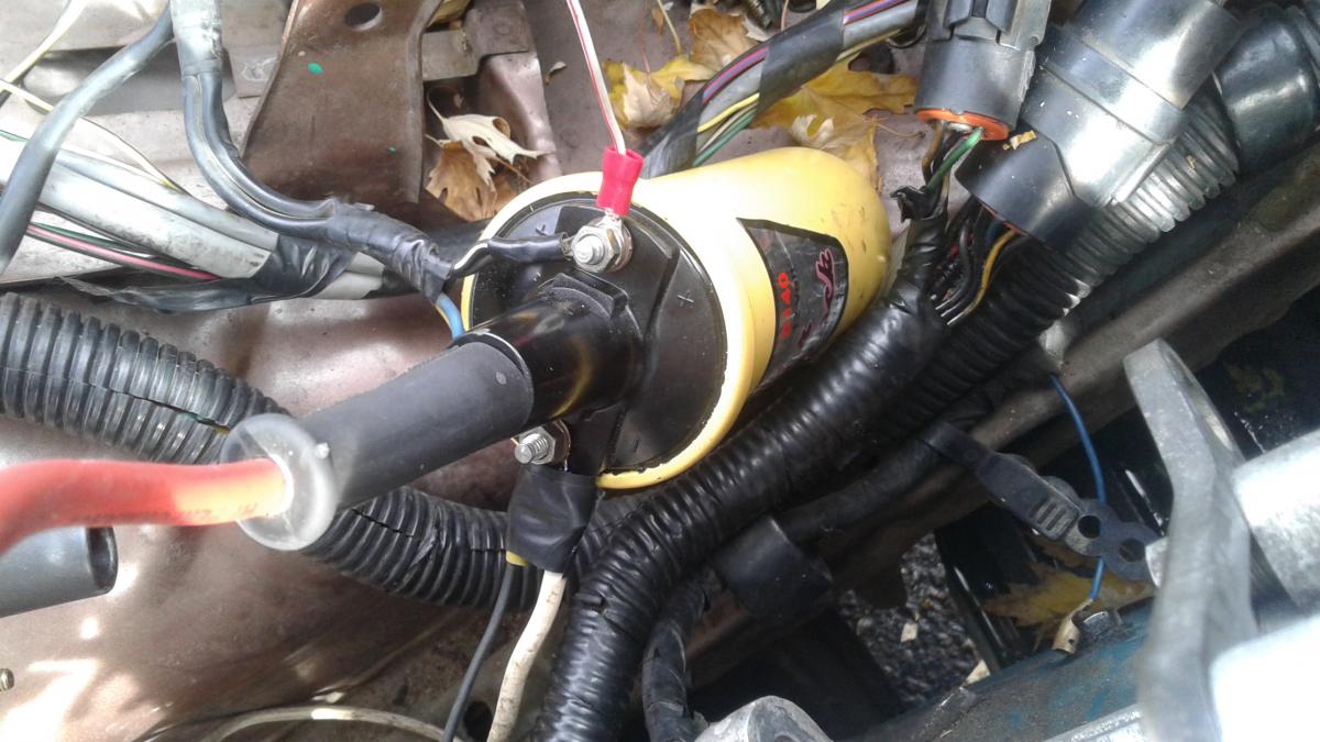

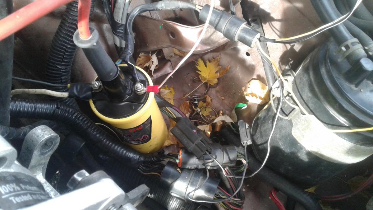

superooo Posted October 30, 2016 Share Posted October 30, 2016 Ok, so i followed gds write up to the tee and every question i had i waited re read and answered myself mostly, but now im stumped, i have it all hooked up, plugged in and everything, im getting fuel for sure, but not getting spark, its a little messy under here but when it starts ill clean it all up, i have this wire coming from the positive side of my coil going to a diode to a plug, no idea where it goes, the bracket is grounded like a champ, soldered connections, in run and start i have 12v at my plug wire but no spark, neg grounded to block, i cant figure it out... please help, ive tried to check the real obvious stuff Link to comment Share on other sites More sharing options...

superooo Posted October 30, 2016 Author Share Posted October 30, 2016 So messed with that plug, didnt help, i noticed my relays got warm when i left my key on, does this mean i wired it wrong? Or bad relays? No blown fuses, just no spark at the disty plug. Hop some oe chimes in, or a denver localle is down to help for a 6er Link to comment Share on other sites More sharing options...
Loyale 2.7 Turbo Posted October 31, 2016 Share Posted October 31, 2016 It is not easy to diagnose a car that is thousands of miles away, with a frugal description; however, by looking at the photos, I am not sure about how did you wired the ignition coil, but seems like the polarity is inverted, somehow... I can only suggest you, to double Check if the ignition coil has been wired properly, and / or test to start it with the old coil; as this Accel one might be wrong. This issue needs further testing to be properly diagnosed / solved. Kind Regards. Link to comment Share on other sites More sharing options...
TomRhere Posted October 31, 2016 Share Posted October 31, 2016 Where is the coil mount bracket with the Ignition Amplifier? SPFI needs that to operate the coil properly. Link to comment Share on other sites More sharing options...
superooo Posted October 31, 2016 Author Share Posted October 31, 2016 Everytging is run through the bracket, took those pics while trying a different coil, the first coil i tried was one pulled from a running fi setup, im tripple checking that its wired like gd said, im going to check every wire after work, and i know long distance diagnosis is difficult, just know theres others whove done this same swap and run into similar issues, but they never write the solution in their help thread, i think maybe having got my harness from a 92 loyale is where my problem is Link to comment Share on other sites More sharing options...

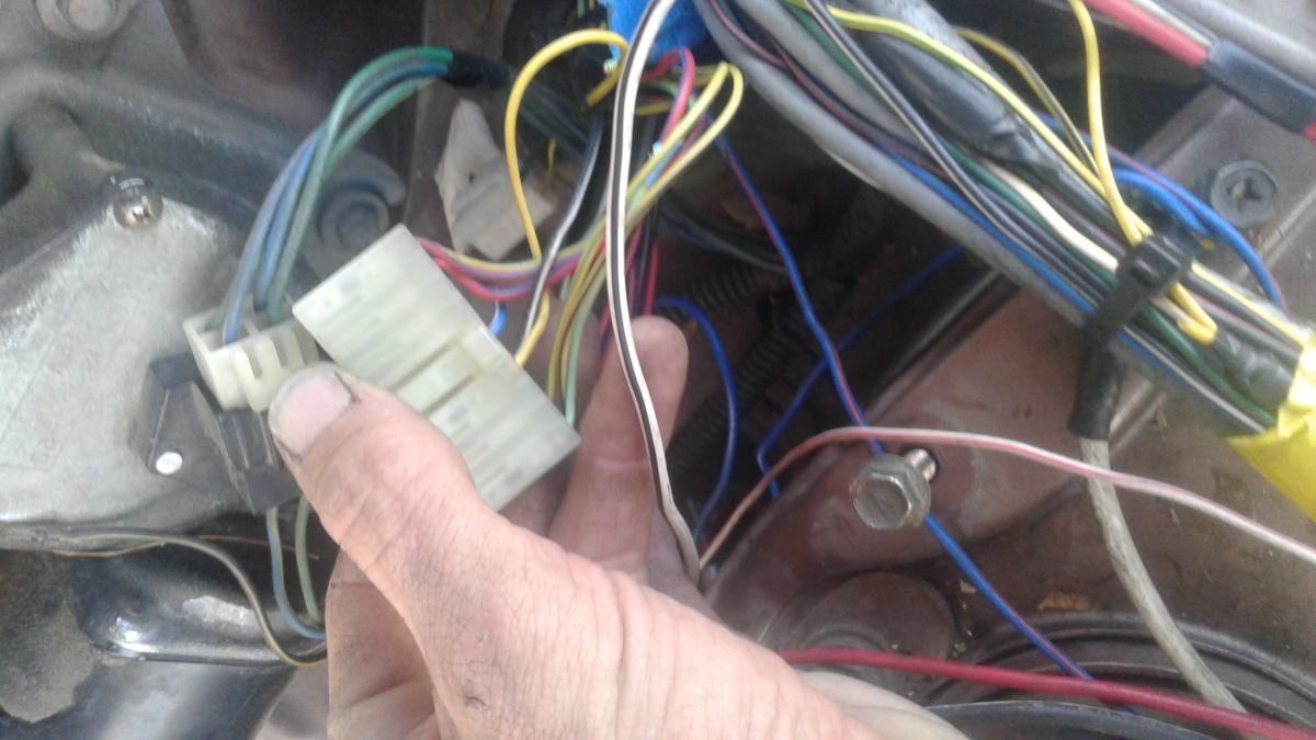

superooo Posted October 31, 2016 Author Share Posted October 31, 2016 So, on the plug between the coil and bracket the 2 pin connector, one i have to switched power and the other (yellow goes upmto this plug pictured, im about to scrap this harness and start over with a fresh 88 with known matching ecu and disty, ihscout what pin on the ecu does this yellow go to? I know its not the White with yellow stripe to pin 52. This plug seems to be my problem, i did notice while wiring a few lines i was supposed to cut from the fuse bux went here instead, gues its my fault for assuming, so if i dont get it soon gonna pull this harness and start fresh. Does anybody habe a pdf of the diagram ive seen that only shows the fi wiring? I tried to open it in dropbox and it wouldnt open. Thanks all Link to comment Share on other sites More sharing options...

TomRhere Posted November 1, 2016 Share Posted November 1, 2016 The White connector in your pic under the hood, is a Factory Test Connection. Just so they could check the harness, no connection to it on the car afterwards, other than it's tied into various circuits. The disty wiring changes was early '87 to late '87 models if I remember right. '88 and after were all the same. Differences between Auto trans/Manual trans ECU's were a few pins of the harness for the ECU went to ground if it was an Auto trans. Either ECU will work for your swap, if you follow the "pin-out" of the ECU correctly. Only asked about the coil bracket and Ignition Amplifier as I did not see it in the pics posted. Link to comment Share on other sites More sharing options...
