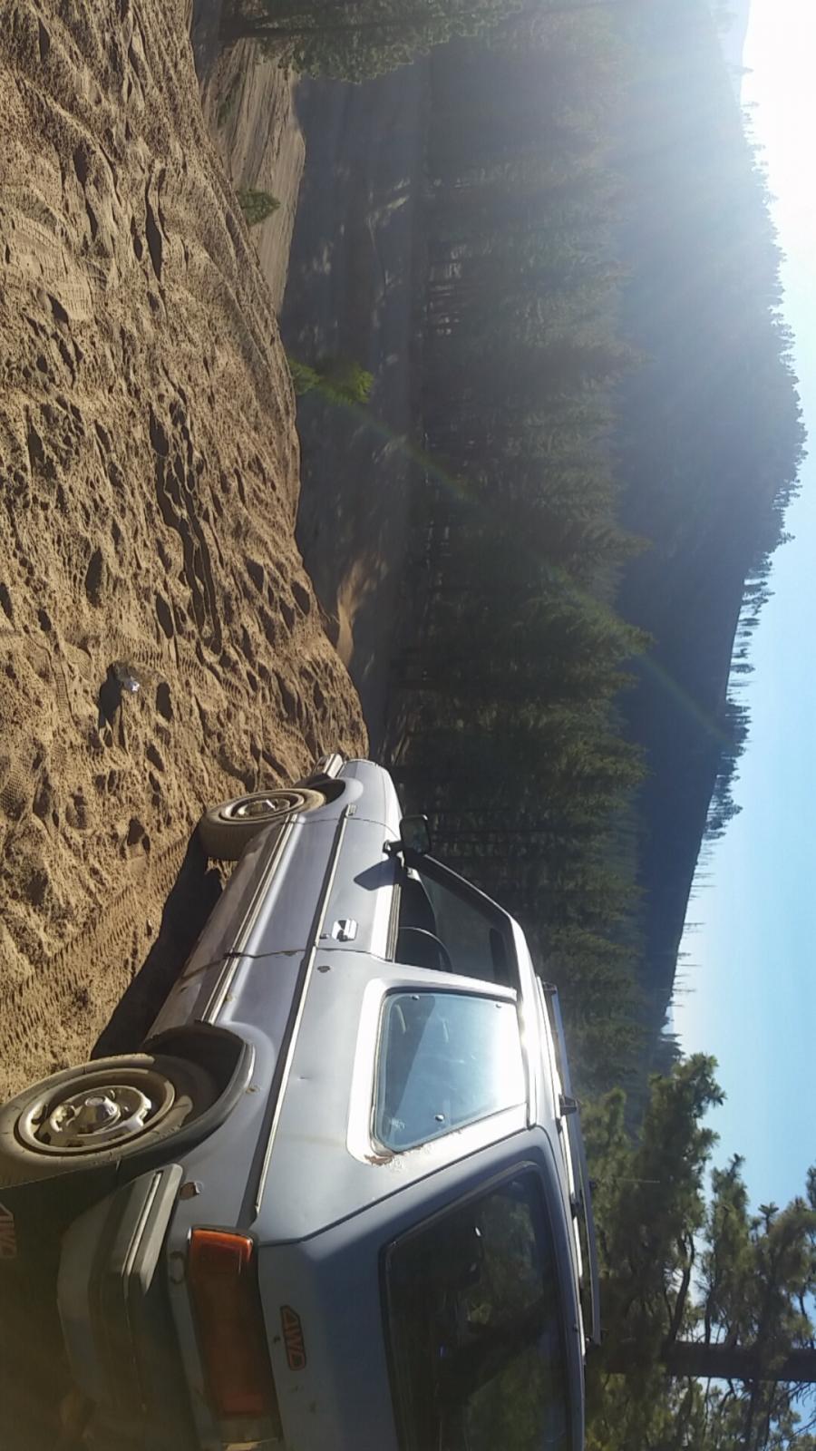

ccooney11286 Posted November 5, 2016 Share Posted November 5, 2016 What's up everyone! I have an 83 subie GL hatchback 2 door, and the first mod I want to do to it is get bigger tires. The cheapest and most effective way is to drill 4 holes to make it fit toyota 6 lug wheels. Any suggestions for wheels/ liftkits? Any help would be great thanks! Link to comment Share on other sites More sharing options...
