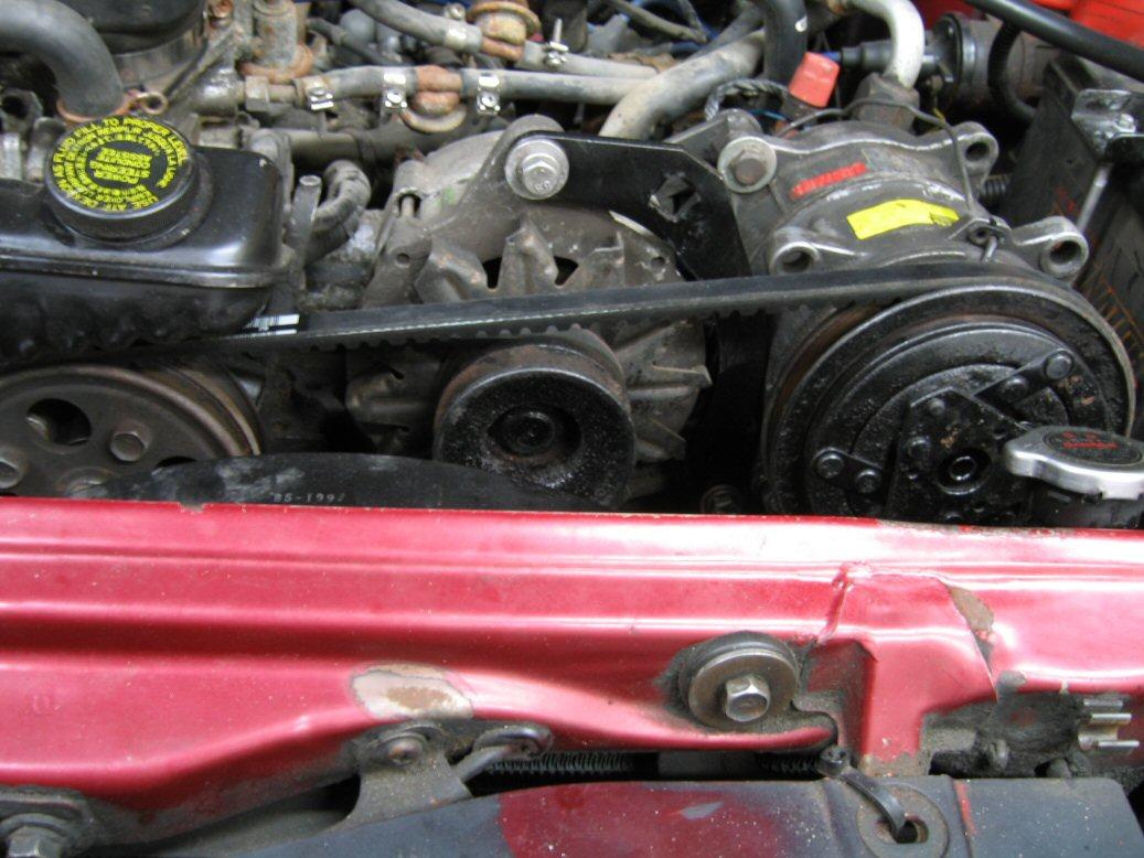

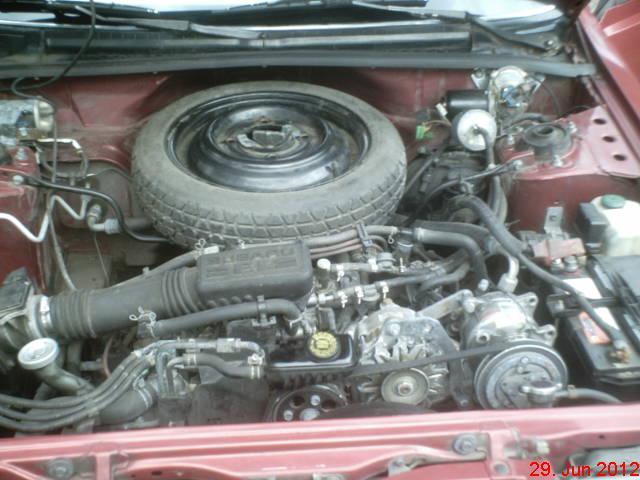

DeltaWye Posted November 20, 2016 Share Posted November 20, 2016 Whenever I see a picture or watch a video of a Loyale, the alternator is beside the battery and the AC compressor is in the middle, between the alternator and PS pump. However, on our car they are reversed: I ordered a belt for the AC from Rockauto last year and it was the wrong length and that's when I realized there are two different configurations, but nobody at the parts store seems to know this. I had to take the belt to the store last week to get the right one. What's the deal? Link to comment Share on other sites More sharing options...

Crazyeights Posted November 20, 2016 Share Posted November 20, 2016 I am pretty sure that the inboard mounted compressor is factory installed AC vs Dealer installed on the outside of the alternator. I have one EA82T of each style. 3 Link to comment Share on other sites More sharing options...
DaveT Posted November 22, 2016 Share Posted November 22, 2016 What Crazyeights wrote. I had one with the reversed configuration. It was a 1990. Had to get belts by bringing the old one into the store. Saved the sleeves for future replacements. Link to comment Share on other sites More sharing options...
