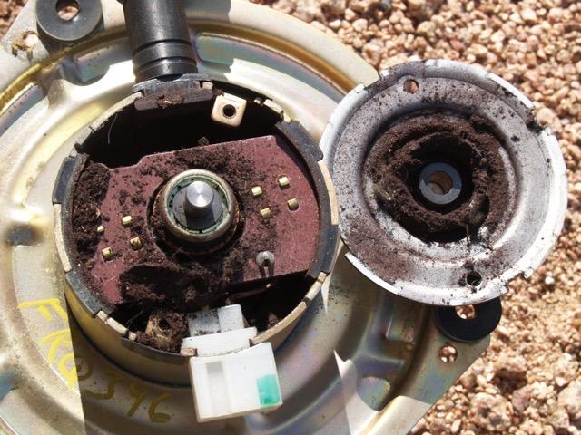

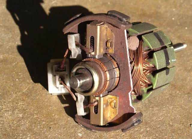

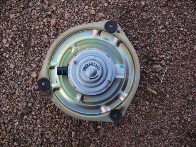

BB's93LegacyL Posted December 2, 2016 Share Posted December 2, 2016 Maybe these photos will help, even though you are dealing with a newer Subaru. These photos are from my '93 Legacy. The first shows the screws to remove to access the base of the motor. From what I have seen, aftermarket motors like the VDO brand from Rock Auto have no access point here Next, what a dirty motor looks like. Then, the commutator and worn brushes. Note the grooved wear on the commutator If you decide to use new brushes, it is hard to remove the original brush pigtails from the crimp connections. it's easier to cut the original pigtails, leaving enough to splice in the new pigtail with solder. I think the commutator needs to be polished smooth to prevent premature wear on the brushes. Subaru Online Parts sells OEM motors if you need to do a genuine replacement. 1 Link to comment Share on other sites More sharing options...
