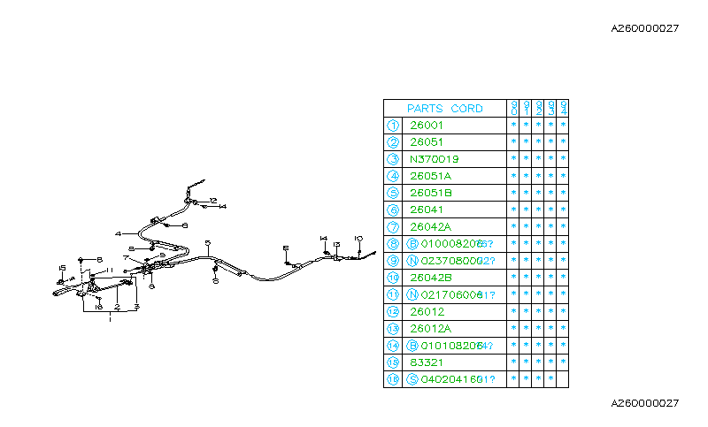

Huck369 Posted December 2, 2016 Share Posted December 2, 2016 I have a 93 Legacy LS Wagon, and the release button is gone from the E-Brake Handle..... anyone have some diagrams on how it all works? so I can see what all I need to replace.... The car is really clean, original paint, with really nice interior.....would like to fix this little issue Thanks for any help.... Link to comment Share on other sites More sharing options...
Numbchux Posted December 2, 2016 Share Posted December 2, 2016 Here's the Subaru parts diagram for the handle...as helpful as it is. Subaru does not offer parts for he button, just the entire handle. I grabbed one part number at random, and it's $100, and still available. Link to comment Share on other sites More sharing options...
Huck369 Posted December 2, 2016 Author Share Posted December 2, 2016 Thanks, yeah, that isn't very clear on the workings of the handle for sure.... but thanks for the info....I Might mess with it some and try to figure out a fix for it... Link to comment Share on other sites More sharing options...
