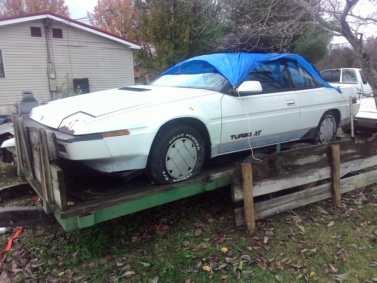

crazyhorse001 Posted December 4, 2016 Share Posted December 4, 2016 So I had a fwd turbo XT follow me home, on a trailer I think i have a handle on reviving it, but welcome additional help. Especially since its a turbo. 1st, i'm gonna disable the fuel pump. Trying to keep from getting trash into the fuel system. Next I plan on cranking the engine to see if it builds oil pressure. if that checks out, I will fire it with carb cleaner sprayed after the maf, but before the turbo. Once I know it will fire, I'll start on the fuel system, cleaning it out. Like i said, I think I have a handle on this, but anyone with better ideas, i'm all ears Crappy pic for attention lol Quote Link to comment Share on other sites More sharing options...

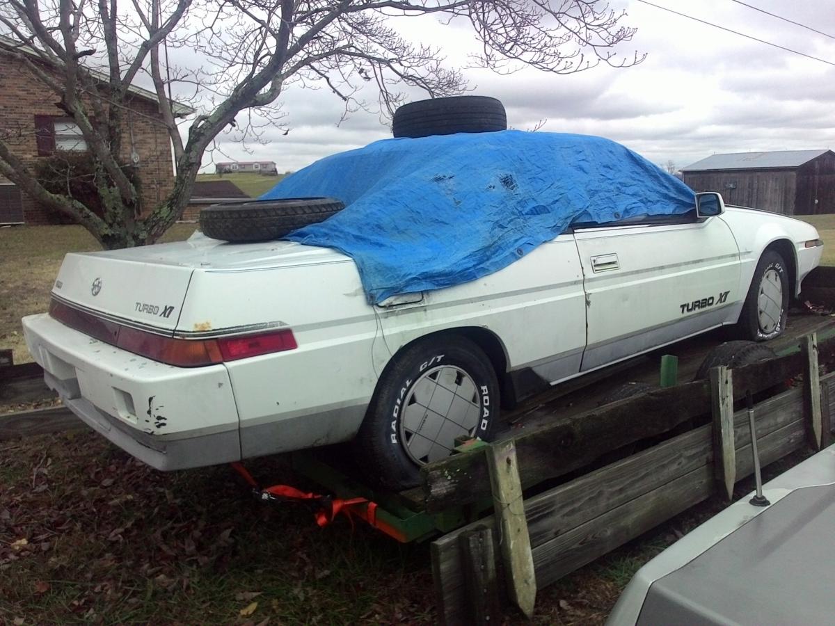

crazyhorse001 Posted December 5, 2016 Author Share Posted December 5, 2016 Pics for the curious Back window is busted out. Not sure just how bad the sheetmetal is under the interior yet Quote Link to comment Share on other sites More sharing options...
crazyhorse001 Posted December 11, 2016 Author Share Posted December 11, 2016 Motor spins, and makes oil pressure. Havent tried any fuel yet. Unfortunately the body is pretty swiss cheese from the broken back glass. Also the sunroof tray is rotted from some idiot stuffing plastic bags around the seal. Quote Link to comment Share on other sites More sharing options...
