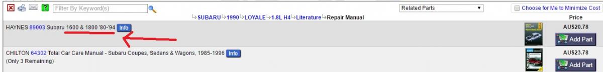

metalfanmartin Posted December 29, 2016 Author Share Posted December 29, 2016 Hi everybody!Glad to see some discussion on this thread I have a question again. Upon looking at what repair manuals rockauto has, I notice that under the Loyale area it says the repair manual is "1600 & 1800" (see attched imaged). Now, why I ask this is because my local parts shop has seatbelt assemblies for "1600 & 1800" but not for my Leone (Loyale). Does 1800 simply refer to the EA82 and 1600 EA81? more importantly, will the 1800 seatbelt suit my 1990 Leone/L-Series/Loyale. Cheers :--) Link to comment Share on other sites More sharing options...
dfoyl Posted December 29, 2016 Share Posted December 29, 2016 If you're looking for a repair manual, buy a second hand FSM. They come up on eBay AUS for ~$25 now and then and are about 4x the detail of the Gregory's (which I would expect to be the same as the US ones you have attached). 1600 = EA71 (only a handful of AUDM MY's will have the 1600 (it was mostly found on the MY hatch which wasn't sold in AUS, and poverty-pack MY sedans), I don't recall seeing anything past about 1982 using this engine) 1800 = EA81 (OHV) or EA82 (OHC). Pretty much all MY's have the EA81 (1979-84 in sedans, coupes and wagons, 1982-93 in Brumby), and all L wagons have the EA82. You WILL have problems with parts purchased locally as many aftermarket dealer guides (eg. Repco, SCA, Autobarn) are wrong (the MY and L platforms get lumped together often, when there really isn't much common between them). And as the Brumby (MY) ran from 1982 through 1993 it gets very messy if you specify the year. Best to say it's a 1994 Loyale (stress it's not a Liberty) and you should be safe (I think Loyale went to 1994...just). Or try a junkyard, they're not that hard to find yet (I know of at least 2 nearby). Link to comment Share on other sites More sharing options...

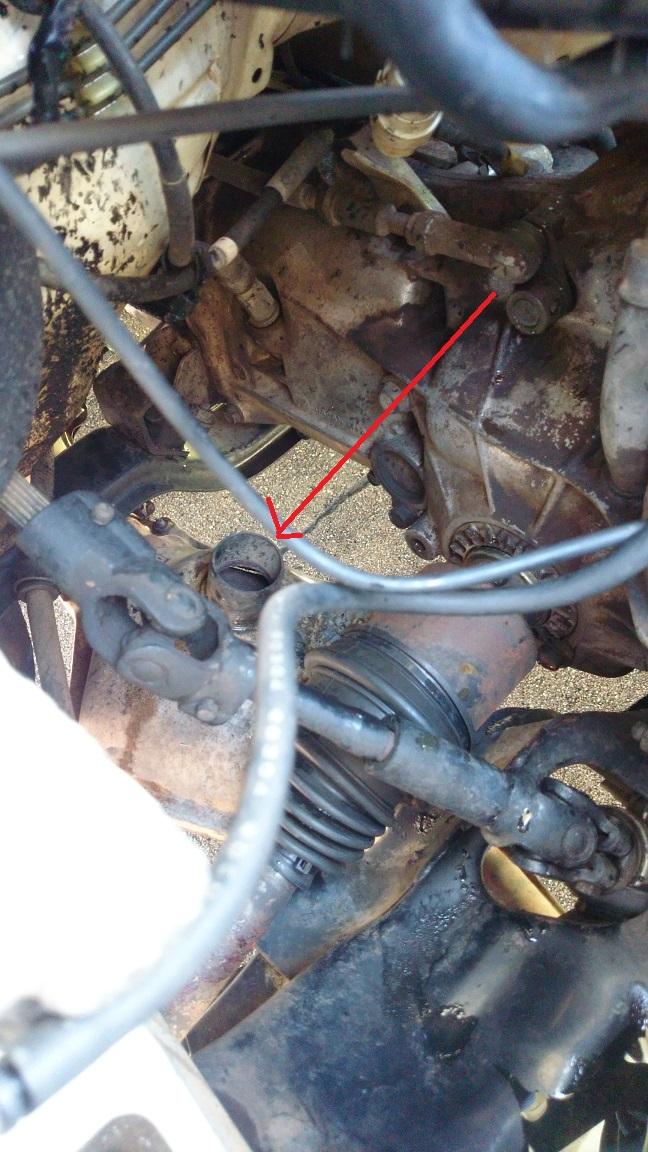

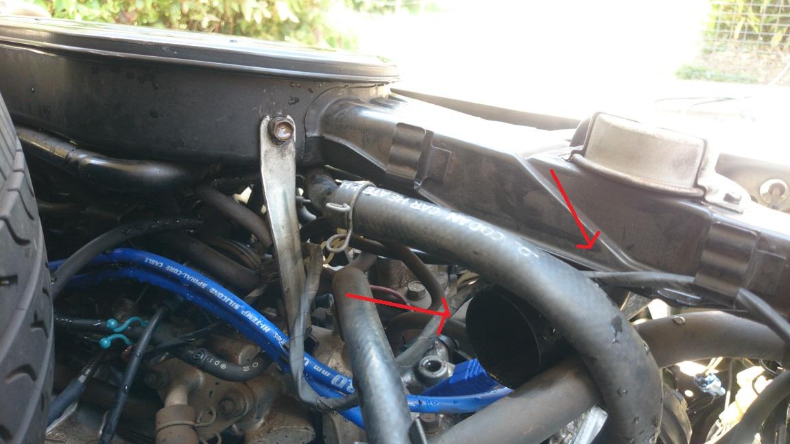

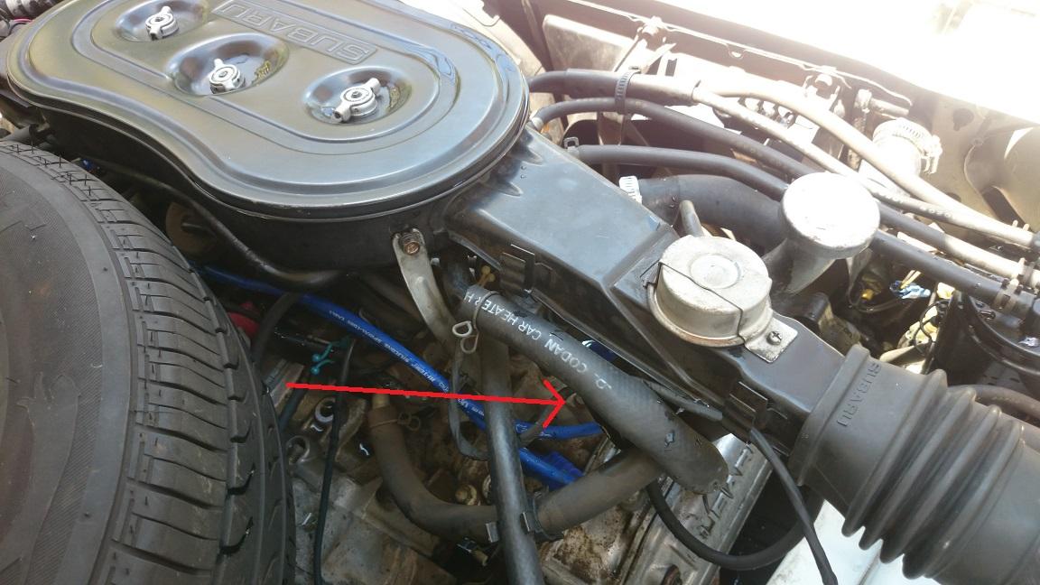

metalfanmartin Posted January 1, 2017 Author Share Posted January 1, 2017 Thanks everyone for your input :--)It's definitely the EA82 I have LoyaleTurbo2.7 as I can clearly see it marked on the engine block I am just wondering if you guys can take a look at the attached pics. There seems to be a hose missing and just an open ....hole... on the muffler assembly. Is that anything to worry about? Link to comment Share on other sites More sharing options...
ANIM_Hooneru Posted January 1, 2017 Share Posted January 1, 2017 Gday Martin, As Dyfol said, in Australia, when chasing parts refer to it as a L Series or Leone. All engine and suspension/brakes etc parts should in theory be the same between our Australian versions and the American version so as long as you put 1990 and EA82 as your search criteria on Rockauto you should be fine. I see you are in Brisbane, there is a wrecking yard in Wacol that had quite a few Leones when I was there last. In regards to the Seatbelts, I just went out and eyeballed my 86 Leone (L Series Platform) and compared it to my 82 Brumby (MY Series Platform) that's in the shed, they appear to be the same only different colours. So if you go chasing a seat belt assembly at the wreckers, anything from about 1981 through 1994 weather it be a Sedan, Ute or Wagon should be the same (I rekon). As for a workshop book, +1 for a FSM. I had a Haynes book that was good and went into fair detail, however it fell apart. Another Haynes book I bought too fell apart, they just seem to be put together hopelessly. As for the hole in the exhaust, its only in the outer Catalytic Converter casing. Originally it would have had (dunno how to describe it really) this sorta couragated, alfoil-ish looking hose that runs from the Exhaust to the intake. The idea of it was to transfer radiant heat from the Exhaust to heat the Intake air up to make cold running a bit more stable. We don't need it here, so its nothing to stress about. Link to comment Share on other sites More sharing options...
dfoyl Posted January 1, 2017 Share Posted January 1, 2017 The missing hose is as Mr Hooneru describes, it gives the carby warm air to pull from when the engine is cold (typically on start-up on cold days, so given your location you have a good 6 months to ignore it). The carb air cleaner has a thermal switch that moves a baffle from engine bay to exhaust pipe based on ambient temperature. Functionally the car will work either way just fine, but on a very cold day you might encounter fuel freezing if it wasn't connected up. You can also buy them from any SCA, Autobarn, etc, though they may be a special order now given the relative lack of non-FI cars on the roads (you will need to work out the length and diameter). And pick up a suitable clip to hold it to the bottom of the air cleaner, as chances are the clip is long gone with the hose. I remember fitting one to a VG Valiant running a Hemi 6 a few decades ago and it made a huge difference in cold weather running, but I am in Vic (and the Hemi 6 is a large cast iron engine that takes a long time to heat up, the Subaru alloy engines are much quicker to get to standard operating termperature). Link to comment Share on other sites More sharing options...
metalfanmartin Posted January 1, 2017 Author Share Posted January 1, 2017 Thank you very much Hooneru and Dfoyl!! Put my mind at ease And thanks again Hooneru, I am actually relatively close to Wacol (I live in a place called Ipswich, west of Brisbane). I'm pondering whether to go to Autobarn to get a brand new seatbelt assembly ($130) they have in stock which *apparently* suits my Leone. Or whether to get a secondhand belt (cheaper) which obviously might not be as safe. It is for a roadworthy certification too so it probably wouldn't hurt getting a brand new one. @Dofyl Luckily it doesn't get anywhere near cold enough, often enough, to warrant the hose I think. Where I live we'd barely touch 0 degrees maybe once or twice a year. That being said, I think the engine bay might look a little neater with the hose connected, don't you think? Is there anything bad that might happen if water were to enter the exhaust hole? Link to comment Share on other sites More sharing options...

metalfanmartin Posted January 3, 2017 Author Share Posted January 3, 2017 Well I figured it out, it appeared to be the vacuum hose for the aircon! The T piece had snapped off and the hose was flapping away freely. Great, I thought! Cos my aircon wasn't working properly and I thought this was the fix. Wrong, it still doesn't work. It blows cold air but only blows at the feet? Doesn't change when I select face or windshield etc. Interestingly, I needed to get behind the dashboard as my speedo wasn't working properly either (doesn't show speed travelling unless I tap the dash cluster a bit). Upon looking at the vacuum hoses, there was four all hooked up correctly to the controller, but then there was also 2 hoses sitting there unconnected, no idea where they go?? Picture attached (lol sorry for so many questions!) Link to comment Share on other sites More sharing options...
