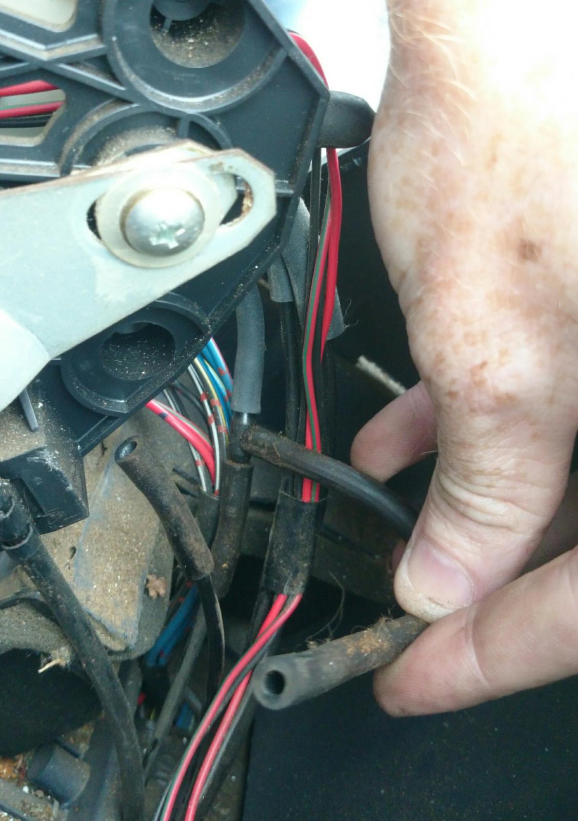

metalfanmartin Posted January 3, 2017 Author Share Posted January 3, 2017 Here's the picture. Link to comment Share on other sites More sharing options...
metalfanmartin Posted January 11, 2017 Author Share Posted January 11, 2017 Hey everybody, I've tried searching but I just can't find what I'm looking for. I'm having troubles with my speedo, generally it doesn't move unless i tap (ever so gently) on the dash screen. Sometimes it works itself, but most of the time it needs a little tap when taking off. Every time I stop, I need to re-tap when taking off. I recall coming across someone saying you have to pull the dash apart and resolder something, but I simply cannot find the diagram/picture. I've already pulled the dash off and re-attached the speedo plug which didn't make a difference. (and in addition to this, there is like hardly any play with the cable, it is very short?? If you know what I mean? It's hard to re-attach). If someone could point me to the picture/thread which shows which solder points to look at, that'd be great Link to comment Share on other sites More sharing options...
DaveT Posted January 11, 2017 Share Posted January 11, 2017 Not sure which car you have. Technically, this question should be a new thread. All of the old gen spedometers o know of are 100% mechanical devices. Nothing electronic to solder. It sounds like yours is mechanically sticky. Yes, the cable is just barely long enough to get to the back. Link to comment Share on other sites More sharing options...
