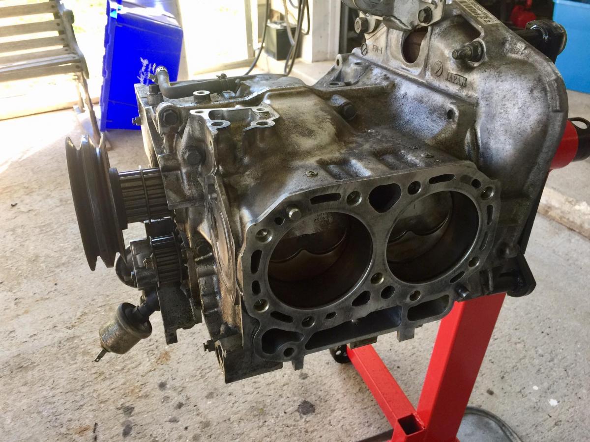

Firemanjim Posted January 6, 2017 Share Posted January 6, 2017 I just picked up a 1991 Loyale ,was told the motor was rebuilt 2 years ago.Guy was driving it and it simply overheated,he pulled over and towed it to a local Subaru performance shop here in Florida.I picked it up and about to tear into it.How likely is it that it just needs a simple regasket/reveal and I'm back on the road,oil is brown not milky.Should I just snatch it and pop it apart? Get heads checked ? Quote Link to comment Share on other sites More sharing options...

Firemanjim Posted January 17, 2017 Author Share Posted January 17, 2017 (edited) Already tore down,very reputable shop already did the diagnosing,customer didn't want to fix so I bought it Edited January 17, 2017 by Firemanjim Quote Link to comment Share on other sites More sharing options...

idosubaru Posted January 17, 2017 Share Posted January 17, 2017 If it overheated due to a coolant leak and then blew the headgasket - that seems more causative and maybe a better fit for rebuild. Resurface the heads. If it blew a headgasket for no reason, id have more questions. Why did it blow? Why was the engine rebuilt the first time 2 years ago (overheating, oil starvation?). It was possibly poorly maintained or in poor condition to require a rebuild and then that repair didn't work. Not quite warm fuzzies for a rebuild. still a good chance of success it's just not anywhere near 100%. What caused the overheating, what kind of headgasket failure was it and what brand headgaskets were used the first time ? 1 Quote Link to comment Share on other sites More sharing options...

Firemanjim Posted January 17, 2017 Author Share Posted January 17, 2017 Was told it ran hot , happened about 6months ago and don't have a ton of history on it ,oil wasn't milky and looks great inside,turns smooth and no scaring of the cylinder walls,sometimes you'll see a "super" clean piston top from the water basically steam cleaning the top of the piston,I didn't see any of that and really could not pinpoint where the head gaskets seemed to fail. Gonna have the heads looked at and reseal it. Quote Link to comment Share on other sites More sharing options...
idosubaru Posted January 17, 2017 Share Posted January 17, 2017 great, those are good signs. i'd replace the thermostat with OEM (the difference is visually astounding). I'd just assume the shop misdiagnosed it, pretty common on older subaru's. once you hit 10+ years it's fairly common to be given ominous reports and diagnosis without compelling reason and often ends up not being the case. Not because they're ill intended but largely just how the market is driven right now. my friend was told she needed a new car and had major engine issues a few months ago. she drove 6 hours so i could fix it for $80. that's not at all uncommon. Quote Link to comment Share on other sites More sharing options...
