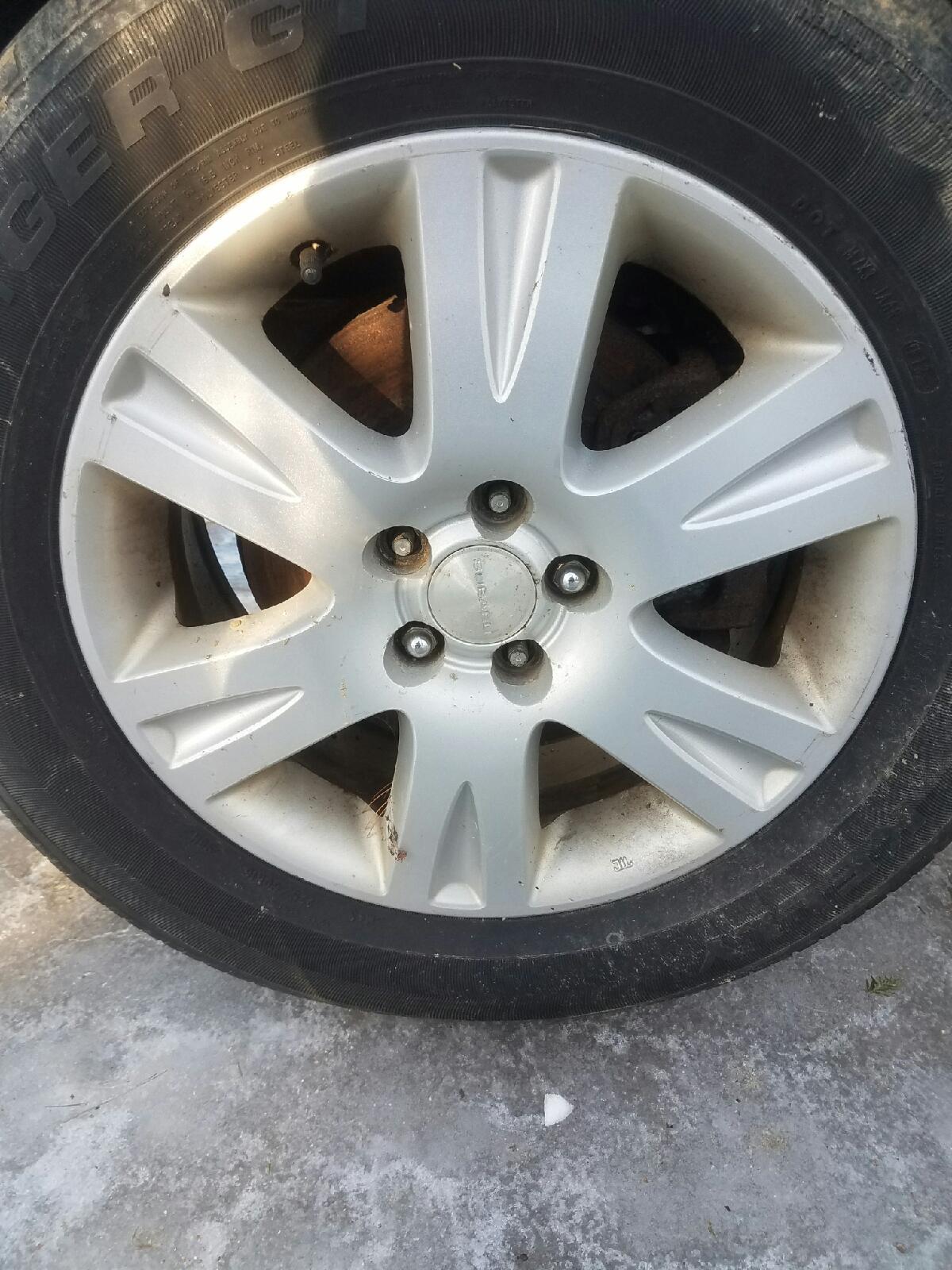

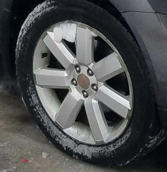

CMike Posted January 6, 2017 Author Share Posted January 6, 2017 First pics the original EQ. Second is the to purchase Link to comment Share on other sites More sharing options...

dfoyl Posted January 6, 2017 Share Posted January 6, 2017 My bad, I completely forgot about the STi / Tribeca / SVX 5x114.3 PCD. We do have them here, but in such small numbers I didn't think about them. For your two wheel types, I can't see the diameter of the wheels in the photo. I would guess the first one is a 16", so you need to make sure the others are also 16" (or larger). Note that different trim levels came with different wheel sizes (base model was 16", XT had 17", H6 had 17", and widths varied also (6.5" up to 8.5"). Personally I would use the 16" for snow tires and get some nice OEM 17's for the rest of the year. Link to comment Share on other sites More sharing options...
CMike Posted January 7, 2017 Author Share Posted January 7, 2017 You are right dfoyl those were 16s not what I was looking for..Fortunately my buddy also had a set of 17s which are actually identical to the ones that came factory equipment, and are currently on the vehicle...Guess that makes this easy.. Thanks for everyone's help and input 1 Link to comment Share on other sites More sharing options...
