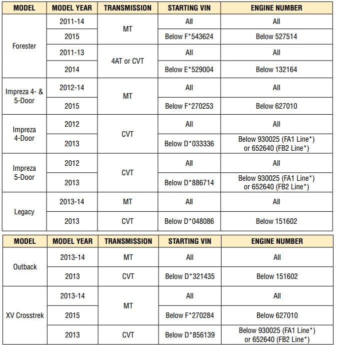

Numbchux Posted January 10, 2017 Share Posted January 10, 2017 (edited) I'll attach the full list of vehicles that are expressly effected by the warranty extension. All non-salvage cars are covered through April 21st, 2017 regardless of mileage, after that the engine will be warranted for oil consumption to 8 years/100,000 miles. This does not mean that all the cars before these cutoffs definitely do burn oil, there are a lot of cars out there with no trouble. And it's not really something that will crop up later, most of the effected cars had excessive consumption basically right off the line. It depends on your definition of "fixed". All the 0w20 engines consume more oil than the older cars, but that's considered "normal" by Subaru. They consider losing 1 quart over at least 4k miles is normal. But anything more than a quart in 3600 miles (technically, the oil consumption test is looking for 1/3 quart or more over 1200 miles) will warrant a new engine. Unofficially, I've heard people say that running synth 5w30 makes it much better. Edited January 10, 2017 by Numbchux Link to comment Share on other sites More sharing options...
