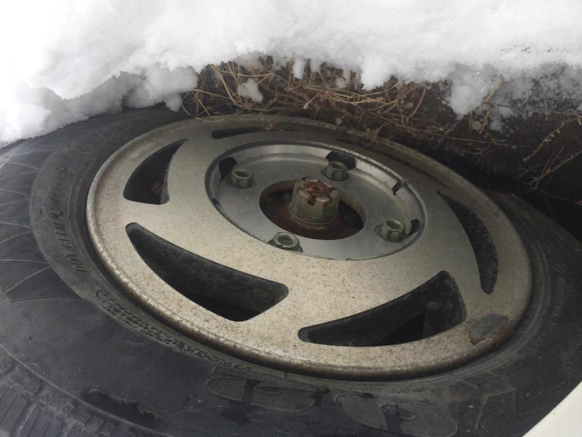

Viewsonic95 Posted February 4, 2017 Share Posted February 4, 2017 Well. Long story short. I came across a 92 loyale wagon with only 84k miles on it. The previous owner tried to "hotwire" the car due to lost keys. They busted out the cylinder and housing for it. So it needs a whole new steering column. I located one in a parts car, however the parts car has no keys.. Is there a location for the key code so i can have a lock smith make a key? I also plan to take the doors and trunk key cylinders out and put them in mine. Has anyone ever done a older GL headlight (the quad bulbs) into a loyale? Or do i have to stick with the whole glass housing? And does anyone have just 1 of the aluminum style rim from the older GLs? The junkyard has 3 out of 4 of them and i only need one. Or should i do the 6 lug conversion? I can post pics later. Thanks all! Link to comment Share on other sites More sharing options...

87subbomber Posted February 4, 2017 Share Posted February 4, 2017 I contacted subaru as my ignition switch is jacked, need a whole column with keys, they cant get a key made apparently. My opinion is 6 lug, tires can be had for dirt cheap. as far as a turbo engine swap, your in for a hurting. Dave is right, for the cost an ej swap can done for probably cheaper, and more reliable and still room for some aftermarket power adders. 40% increase in power and torque is great. The 2.2 is a great engine, id go 2.5 for the extra torque for 4x4 days. dont like fuel injection? go carb and have sjr lift hook you up with the stuff to make an ej carbed. remember parts are getting scarce in the ea81/ea82 world.they dont even make oil pumps anymore. Link to comment Share on other sites More sharing options...

Viewsonic95 Posted February 12, 2017 Author Share Posted February 12, 2017 Got a whole steering column for 50 bucks. Plastics and all. Got all of the door locks too and hopefully i can get a lock smith to make me a key. The passenger side lock has some numbers on it. Also nabbed the DL headlights and a tail light. But the DL has some aluminum rims on it. Anyone have just 1 of these laying around? Link to comment Share on other sites More sharing options...
