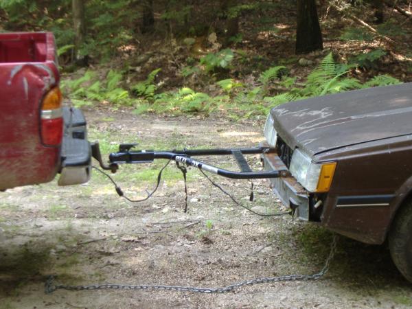

WoodsWagon Posted February 11, 2017 Share Posted February 11, 2017 I've done a bit of flat towing. This make it 2500 miles: I welded tabs onto the factory bumper beam for the tow bar to hook into. Then ran safety chains from my truck, across the tow bar, and anchored to the tow loops on the subaru just in case something did come apart. I backfed the subaru's front turn signal wiring from the trailer lights plug on my truck. That gave rear turn and stop signals. And I backfed a front parking light bulb for running lights. Easiest is to just pick up a pair of magnetic base trailer lights from harbor freight for like $15. I towed an antique VW across the country too, that one I built a pipe bumper to weld tabs to because the stock chrome one was flimsy. Link to comment Share on other sites More sharing options...

pontoontodd Posted April 1, 2018 Share Posted April 1, 2018 I've done similar to what woodswagon has done. I like the idea of backfeeding the lights on the car being towed, might have to do that eventually. We've always used the HF magnetic tow lights. The problem with those is that the wiring is very weak, each conductor has about four strands and they break easily. I just rewired it with some new four color trailer wire and put a new four pin end on it. I've also used a coiled trailer wire connector, takes stress off the wires while turning. https://www.amazon.com/Wesbar-787206-5-Flat-Coiled-Adapter/dp/B007V4XME4/ We are usually towing one Subaru with another so this helps keep things in line: https://www.summitracing.com/parts/cht-17200 Link to comment Share on other sites More sharing options...
Fairtax4me Posted April 1, 2018 Share Posted April 1, 2018 The bumper beam on a legacy will probably not be strong enough by itself to attach a tow bar. I would weld on a few 3/16" reinforcement plates that spread the load out from the attachment brackets. Link to comment Share on other sites More sharing options...
pontoontodd Posted April 1, 2018 Share Posted April 1, 2018 The bumper beam on a legacy will probably not be strong enough by itself to attach a tow bar. I would weld on a few 3/16" reinforcement plates that spread the load out from the attachment brackets. I think the stock bumper beam on my 99 Legacy Outback was plastic/fiberglass, so definitely not safe for flat towing. Should have clarified, on the Subarus we've flat towed we have a tube under the radiator support and oil pan that attaches to the tow hook mounts and front crossmember. That's what we tow with. Running safety chains around something else in addition is a must. 1 Link to comment Share on other sites More sharing options...
Subaru Scott Posted April 2, 2018 Share Posted April 2, 2018 Been flat-towing soobs for over 35 years, and always used a towbar with big pins, or bolts, through the tie-down eyes. "Only for tying down" is, of course, lawyer talk. Hauled dozens this way, with no issues. I do loop a safety chain over the front crossmember, for worse case scenario. Link to comment Share on other sites More sharing options...

ironworkerboomer Posted April 6, 2018 Share Posted April 6, 2018 I have flat towed my Brat from east coast to west coast several times with no issues. Stock bumper with a 1/2 inch by 2 inch flat bar full length on inside of bumper tow bar is bolted to this. All nuts have been tack welded so they don’t back off. Link to comment Share on other sites More sharing options...
