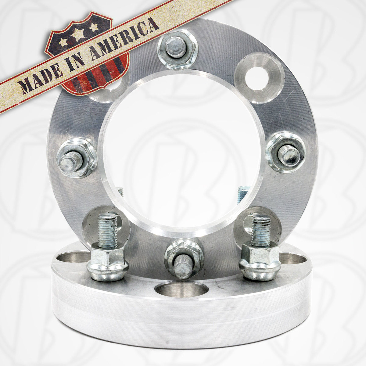

Silas Cruse Posted December 19, 2018 Share Posted December 19, 2018 (edited) Look what I found, good luck. https://www.ebay.com/itm/2-USA-4x140-To-4x100-Wheel-Adapters-1-25mm-Thick-12x1-25-Fits-Subaru-Suzuki-/253945420065 https://www.ebay.com/itm/2-USA-4x140-To-4x108-Wheel-Adapters-1-25mm-Thick-12x1-25-Fits-Subaru-Suzuki-/253945441830 Edited December 19, 2018 by Silas Cruse Add url Link to comment Share on other sites More sharing options...
privateer56 Posted December 19, 2018 Share Posted December 19, 2018 And their off and running! Link to comment Share on other sites More sharing options...
privateer56 Posted December 19, 2018 Share Posted December 19, 2018 https://www.ebay.com/itm/2pc-USA-MADE-4x140mm-5x100mm-Wheel-Adapter-1-75-Spacer-Fits-Subaru-Suzuki-/264001713249?vxp=mtr&hash=item3d77ba7461 Link to comment Share on other sites More sharing options...
dfoyl Posted December 19, 2018 Share Posted December 19, 2018 Pity they're not hub-centric, which is pretty important for an off-roader. 1 Link to comment Share on other sites More sharing options...
