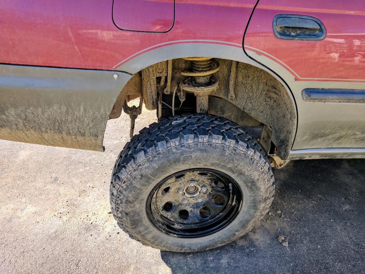

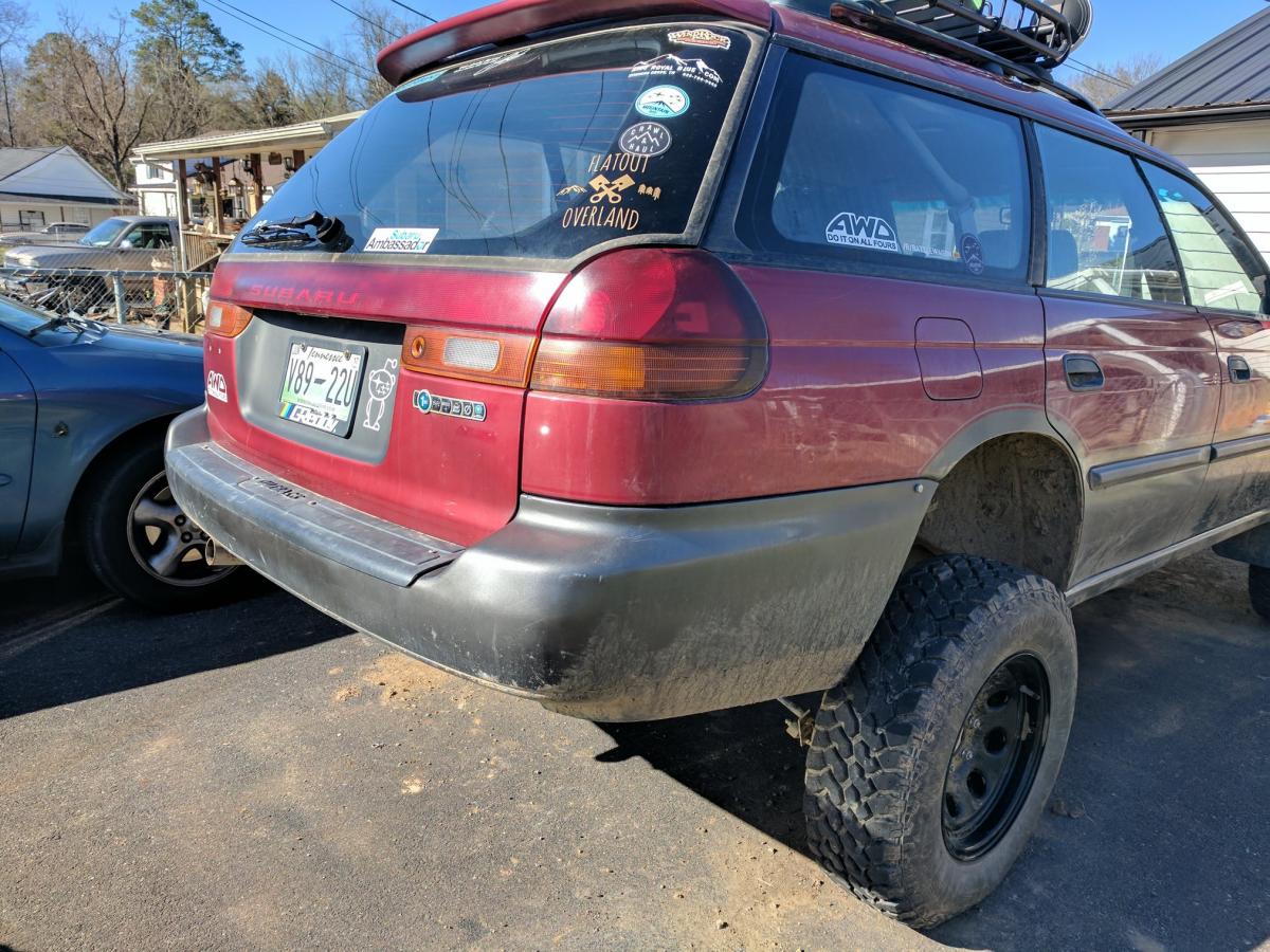

flatoutnos Posted February 19, 2017 Share Posted February 19, 2017 I have been asked by multiple people all over Instagram (@flatoutnos if you are curious) to start a build log for my car so here I am (Hope this is the right place). I have a 97 Legacy Outback with a 4 inch SJR lift and 235/75/15 tires on Cragar soft 8's. I have all polyurethane bushings, 07 Forester brakes in front, 02 WRX rear calipers with the H6 rotor and stainless lines. I have done a lot to this wagon, honestly to much to remember. Here are a few pics of the current setup. I recently blew either the center or front diff so the car is only rwd now. I was already in the process of buying parts for a motor build so I figured why not just go ahead and do both right now. The plans for it as of now include welding the center diff and adding a divorced transfer case and an R160 in the front. I am going to add more lift, maybe custom coilovers or something not entirely sure yet. The goal is to fit 33's on it. As for the motor I am building the EJ25D in it. I have Arias forged 9:5:1 pistons for it and Cobb street cams. I am going to add forged H beam rods and an Eaton M90 supercharger. Of course a lot of other things are going to happen as well just haven't decided yet. Not sure if this is the right place to start a "Build Log" but after searching for .5 seconds this seemed like an appropriate place. Link to comment Share on other sites More sharing options...

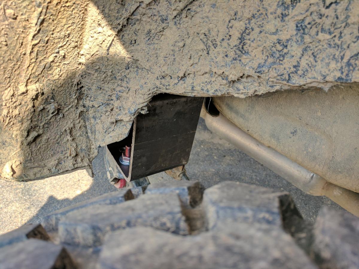

flatoutnos Posted April 7, 2017 Author Share Posted April 7, 2017 Update: I have started on the lift. I made custom 6 inch spacers for the back and installed my ADF 2.5 inch lower lift. I still have 2 more inches of lift to add to the back. Engine and trans are removed and disassembled. Link to comment Share on other sites More sharing options...
Scott in Bellingham Posted April 7, 2017 Share Posted April 7, 2017 lets see a picture of the lower lift part where it bolts up Link to comment Share on other sites More sharing options...
