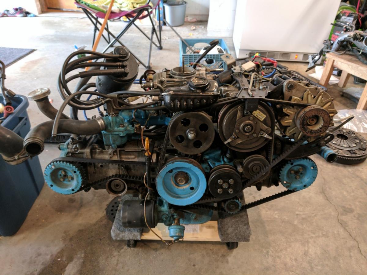

CaptainDub Posted April 16, 2017 Share Posted April 16, 2017 (edited) On 4/14/2017 at 8:37 PM, stock93loyale said: What condition is it in? Just did compression check today. Cylinder 1 - 160 Cylinder 2 - 145 Cylinder 3 - 150 Cylinder 4 - 135 The previous owner resealed it, to what extent I'm not sure but it hasn't put a drop of oil on my driveway in the 5 months it's been there. It's out of an 86 GL. It's got the Hitachi carb which was just rebuilt. As far as mileage I'm told it's around 180k. I've only put a few hundred on since I've had it. Edited April 16, 2017 by CaptainDub Link to comment Share on other sites More sharing options...

CaptainDub Posted April 30, 2017 Share Posted April 30, 2017 (edited) I've got it pulled out now. Name your price! Edited April 30, 2017 by CaptainDub Link to comment Share on other sites More sharing options...
